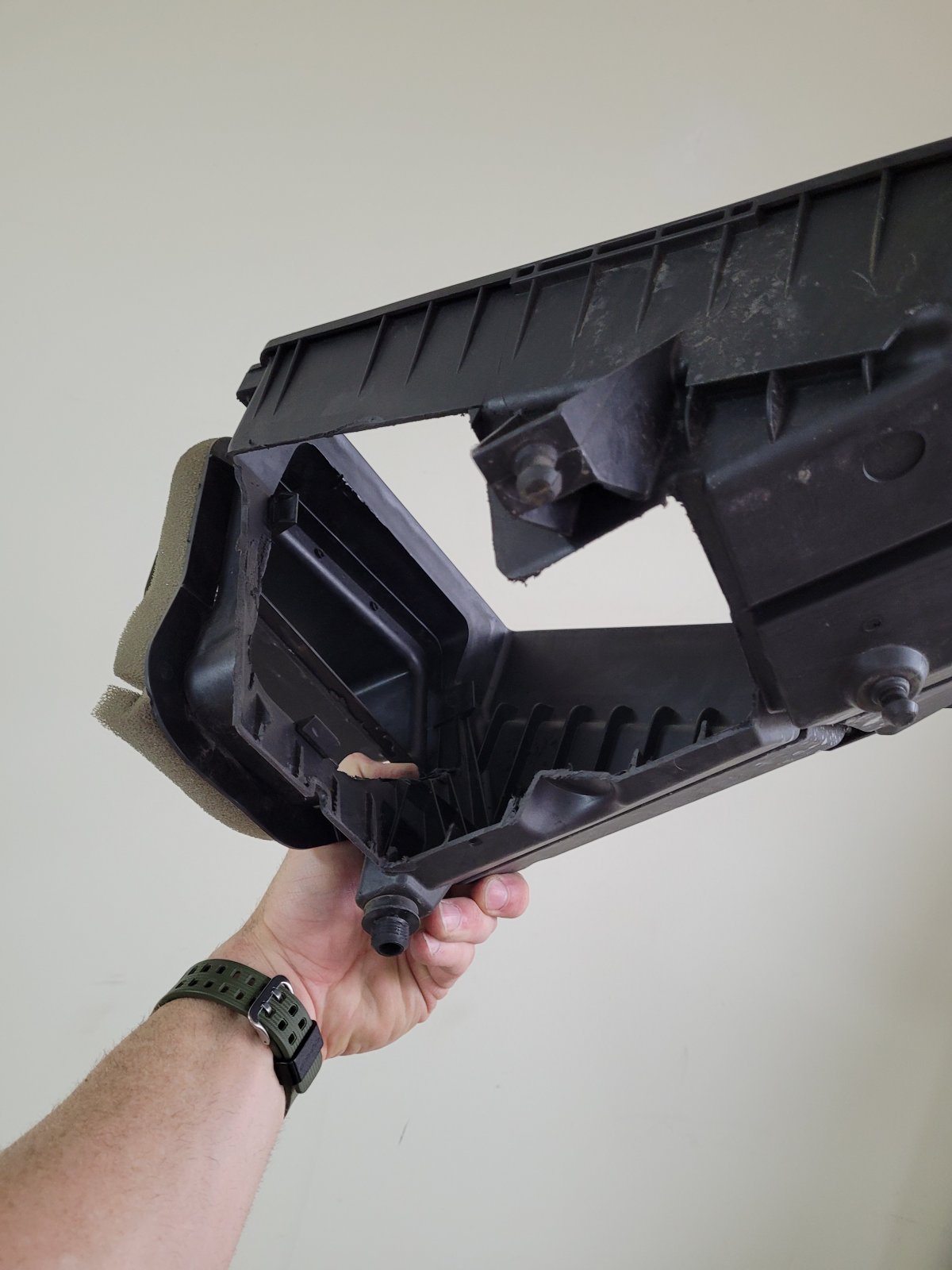

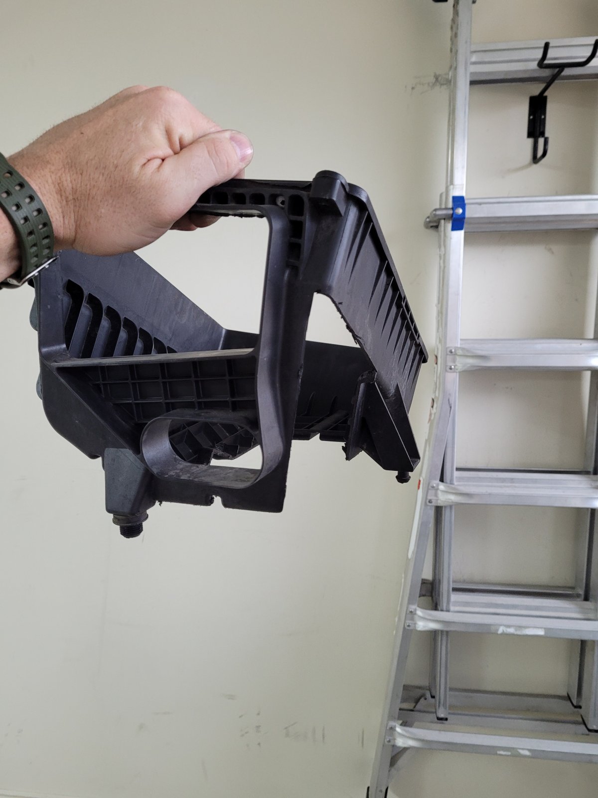

I will say this, I still want the MIT for appearance, I think it looks better.
But I made very similar gains just by trimming the factory filter box. Actually so much so, that I started small and quickly created a dead spot in the throttle response. I had to adjust the tune to correct the issue.
Low rpm, lower speed, moderate throttle input...it bogged and stumbled.
Generally I just open up the front as much as possible, this time I get going for more.
