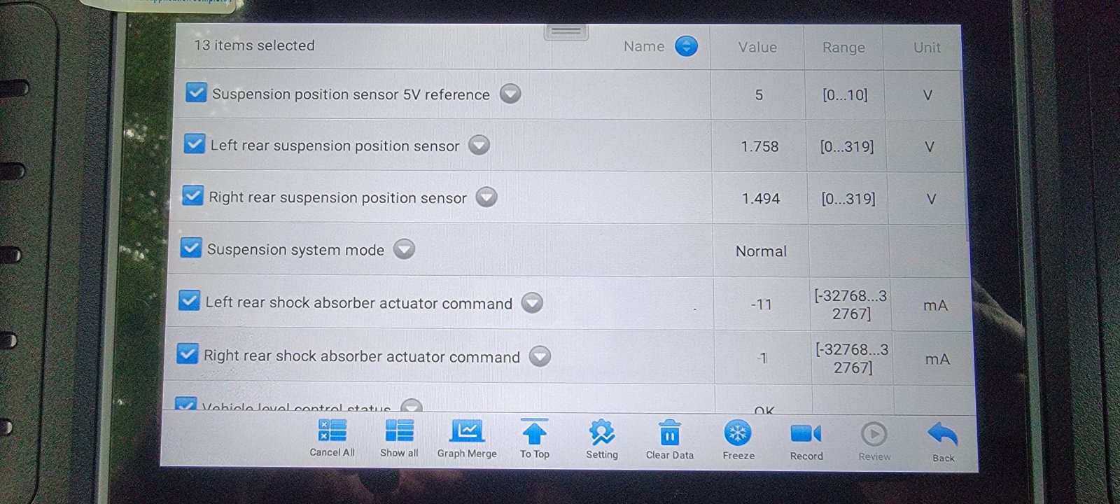

I purchased an Autel MK808, it shows v0.0 for sensor voltage - not sure if there's an issue or if the Autel can't read them?
I put in a factory GMC compressor and tried my RV again. It fires up the compressor but I dont see it adjust the height much, compressor runs maybe 5 to 10 seconds and then stops. I did buy arnott branded ride height sensors, should I install those ? There's nothing left after lol.

The 5-10 second compressor activation at startup is normal, as it is a self-test of the air system. You should be able to read all 4 height sensors individually. What are the individual voltages? If the system is operating correctly, you should see positive voltages at each sensor, and they should be relative close to each other.

I think sensors are good... I'll hook things back up tomorrow and do a full hookup test with the tool. The attached was while unloaded, could see the voltage fluctuate a little as I moved about the driveway.
