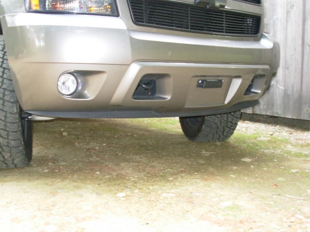

Trim it. The bottom of the bumper looks ugly as hell without the air dam on there... I got the idea from InTruckDesign to just lay down a line with some masking tape and use a cutoff wheel to trim it up. Then I just used a sanding block to smooth and clean up the edge when I was done. It looks great and now I don't have to worry about ripping it off while offroading.
Here is a picture from InTruckDesign:
