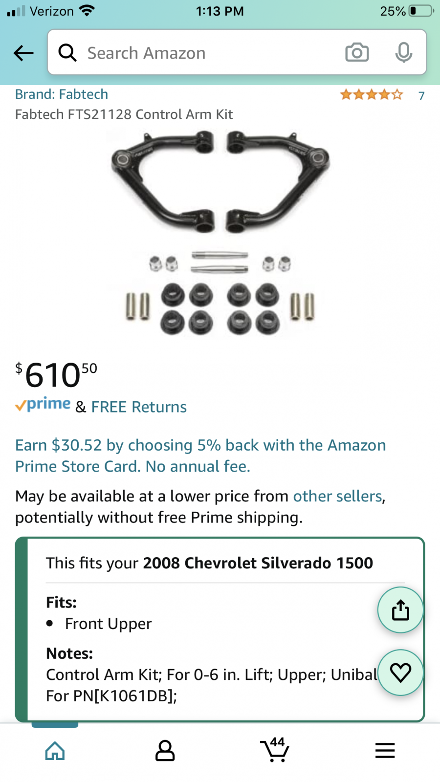

Most aftermarket control arms in my experience have needed atleast a .25” to .5” wheel spacer to clear the stock rims without rubbing on them that’s nothing too crazy imo but I run 2” spacers front and rear so it’s no big deal to me…
I LOVE my fabtech uniball uca
Heard good about cognito a arms but I’d swap to a kryptonite ball joint with them because I’ve heard the cognito one don’t last too long
Is your bump stops cut yet? If not you’ll have to do so more then likely with the new control arms if not they will be bottomed out half the time
Anything over 3” really you need longer uca
Trey Hardy
Jun 12, 2020
3,552
9,638
These are the ones I run but you have to drill/taper the spindle to accommodate the uniball pin
