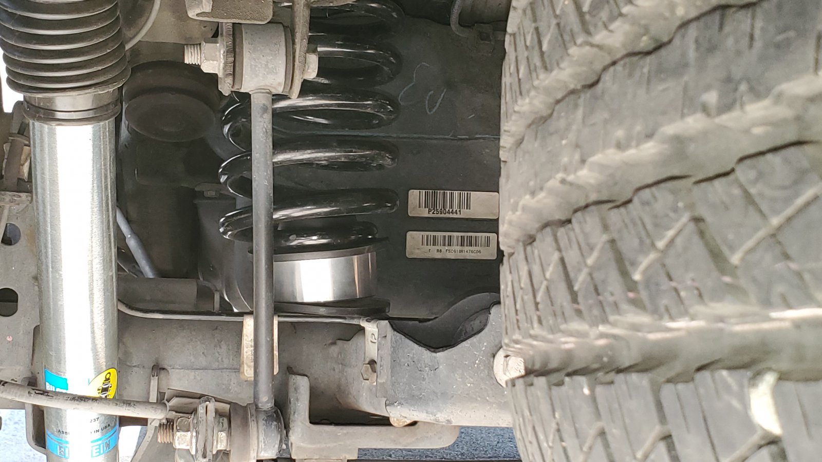

Here are some pictures of the problem:
As you can see my wheels are poking out the passenger side and my rear springs are leaning as well.
I think that an extended track bar will resolve this, what do you guys think?

Installing the track bar and centering the body of the Tahoe above the rear wheels did NOT resolve my rear coil springs looking crooked and spring spacers did not straighten, more on this later on in the post.

After that I removed the lower coil spring insulator from bottoms of both of my rear coil spring spacers and after that my rear springs and coil spring spacers straightened right up and look perfect now. So rear coil spring spacers go metal to metal and then you use an insulator between the spacer and the bottom of the spring and then another insulator between the top of the spring and the body.
