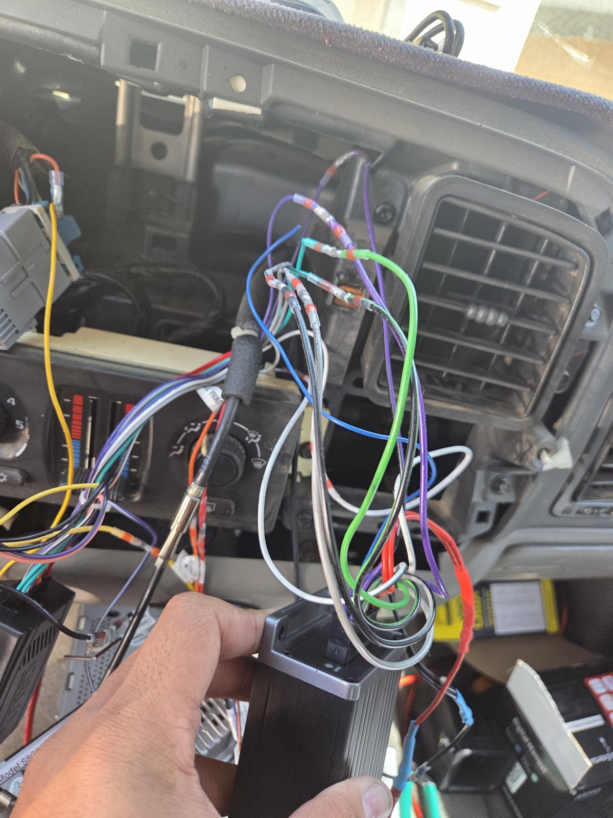

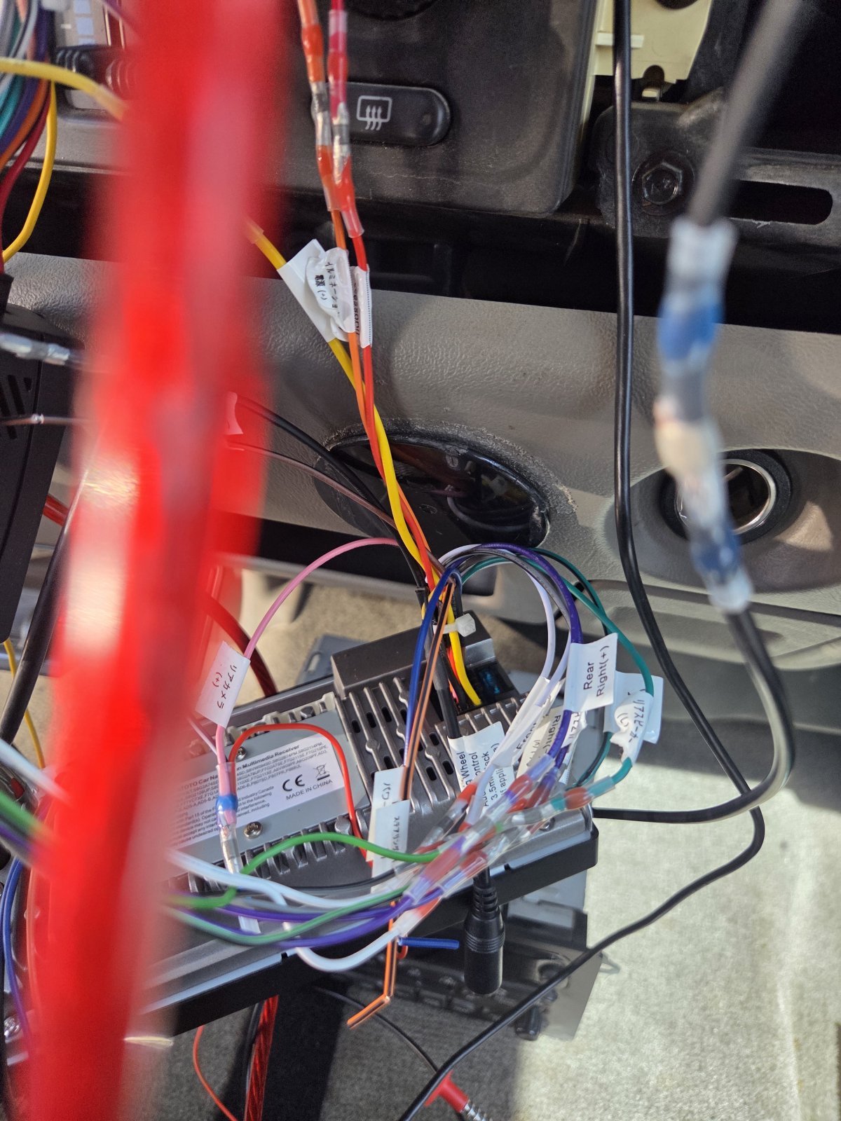

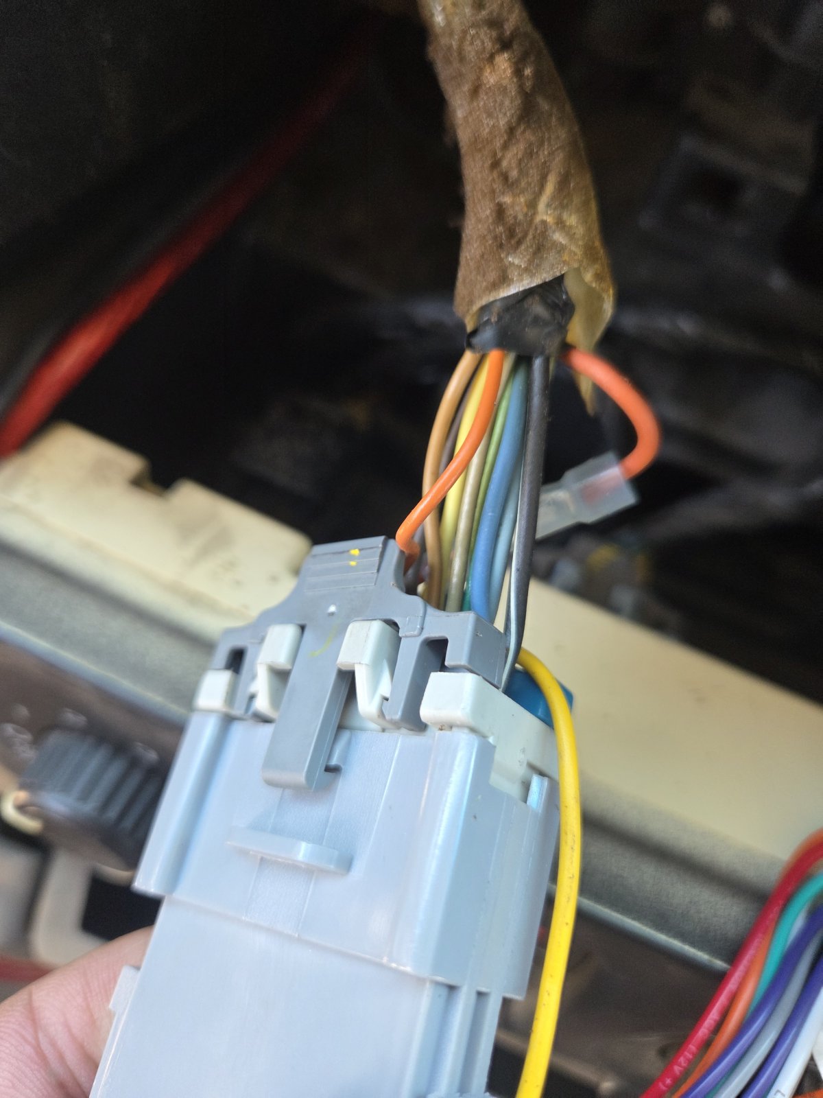

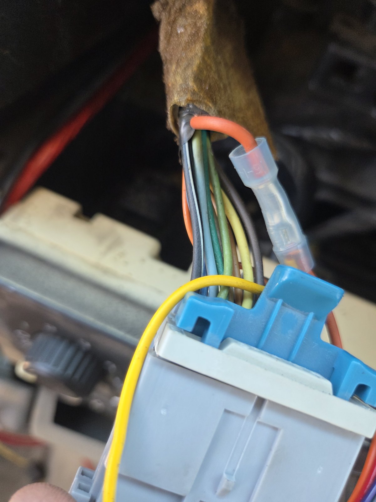

Sure thing. Here are the connections I have right now.

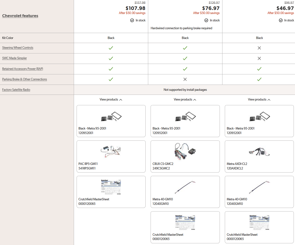

The CRUX module you list is for Bose. (see the ad that your link shows)
Crutchfield notes that the CRUX CS-GMC2 -- among others -- is the right one for non-Bose, non-OnStar installs.

I was wondering if it could've been that too, but it says non-amplified so i thought it worked for this. Are there Bose systems that don't have amplifiers?

Crutchfield helped me out and i feel so dumb lol. The interface box was fine, but the Kicker amp i was using had the amp 2 (rear speaker) gain set at 0 so no sound was coming out. It's all good now! Thanks everyone.
