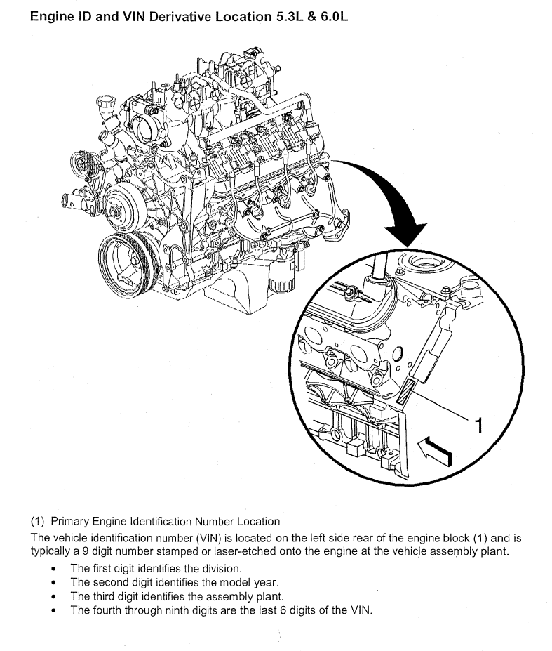

How can you or can you tell if your pretty sure the engine was replaced.? I bought a 2007 Yukon at auction and it appeared that the engine was replaced?
