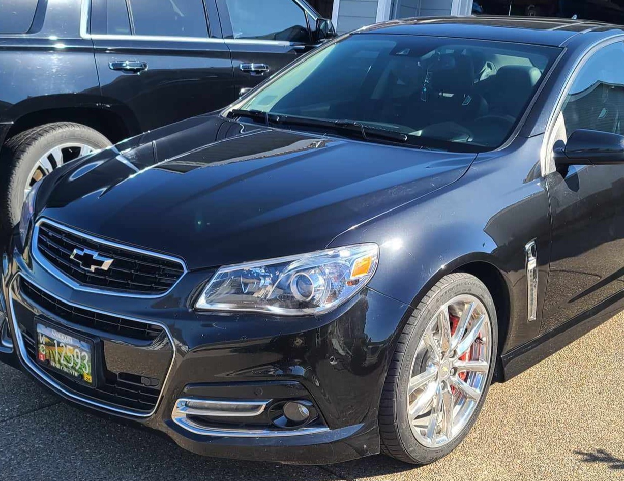

Those SS Sedans are rare. What prompted you to remove the clear bra from it?
Also; What did you end up doing on the Yukon Denali tune-wise to turn off the AFM in the tune?

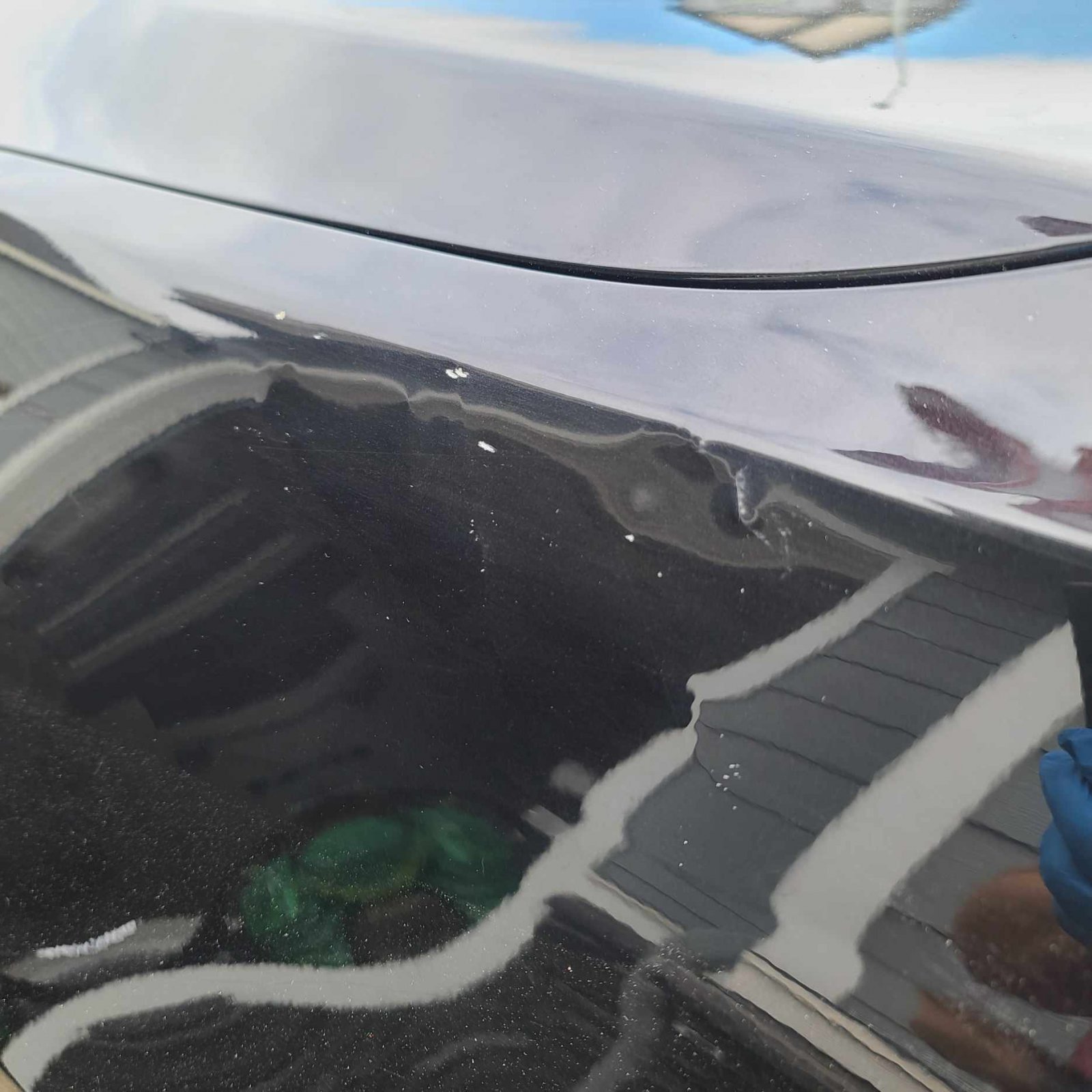

The 10 year old clear bra wasn't clear anymore & my wife was on the hwy and something hit the driver's fender so I repaired it & painted the driver's fender 3 weeks ago. Plan is to do a 2000 grit wet sand on whole car, buff then ceramic coat.
