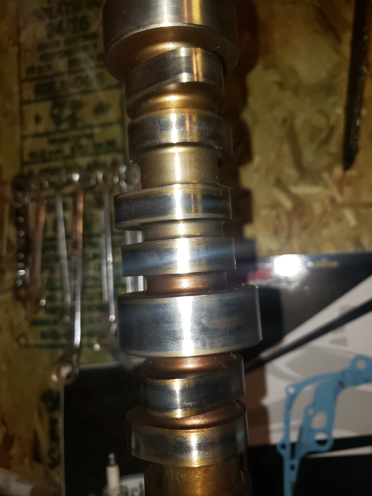

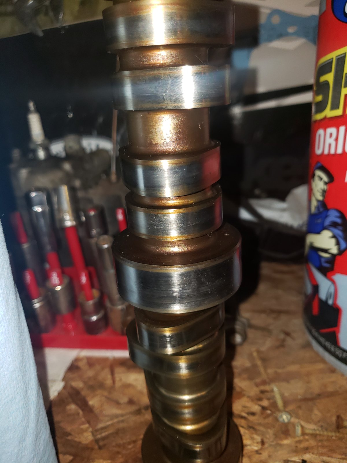

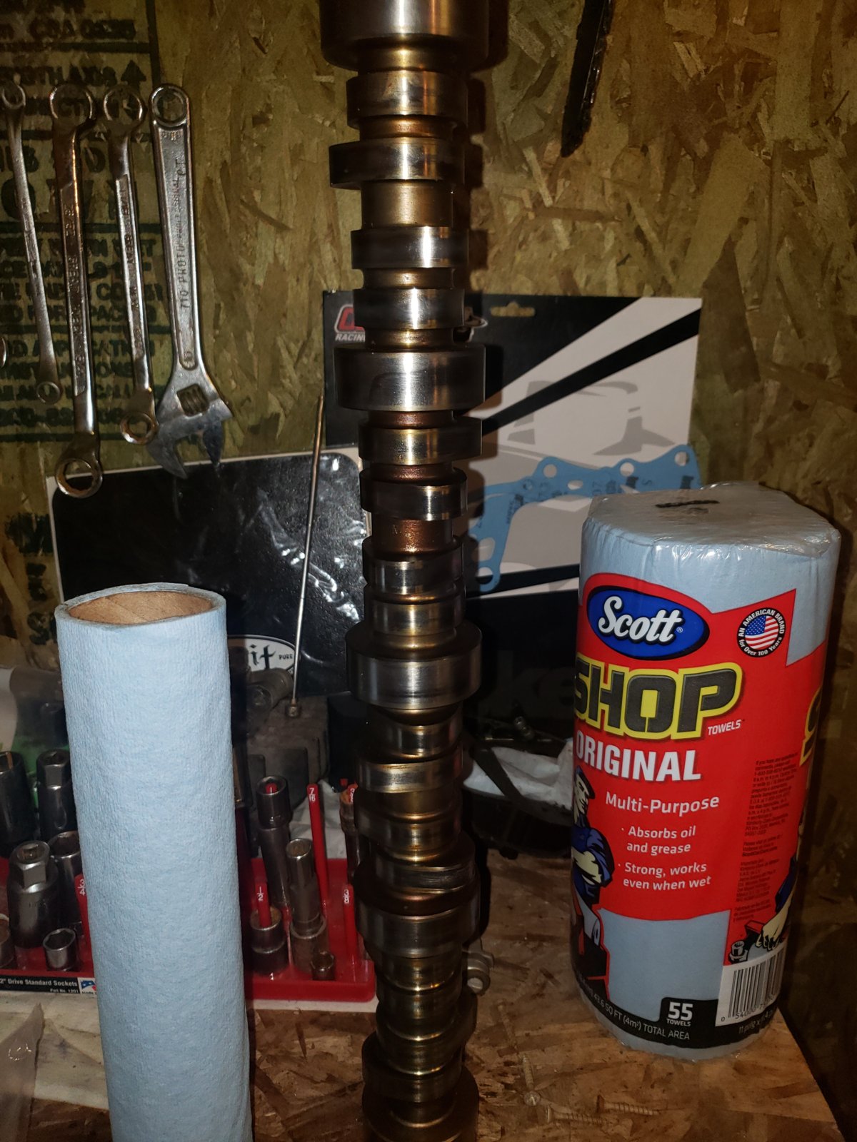

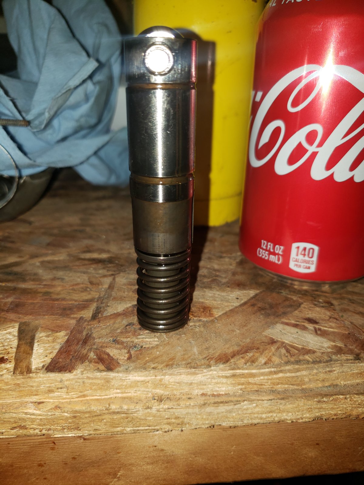

Afm failure cylinder 6
Justin Yeager
Dec 20, 2018
28

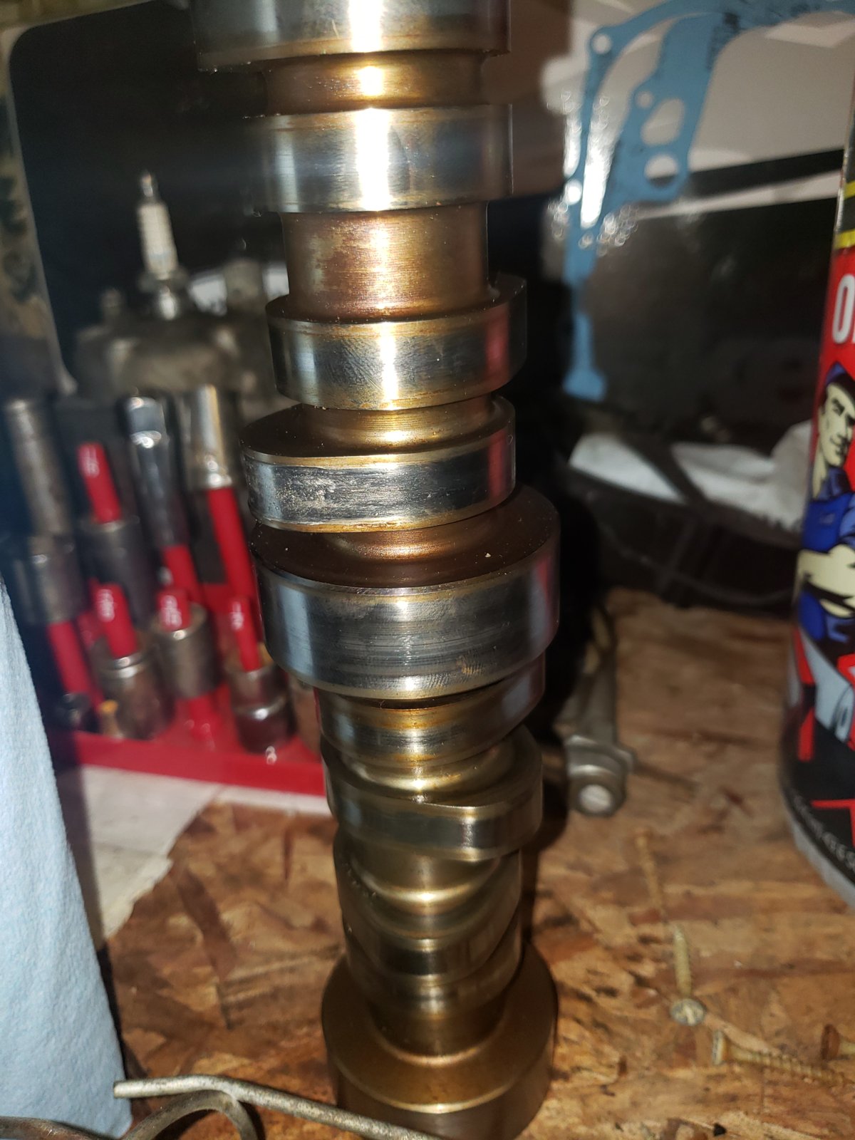

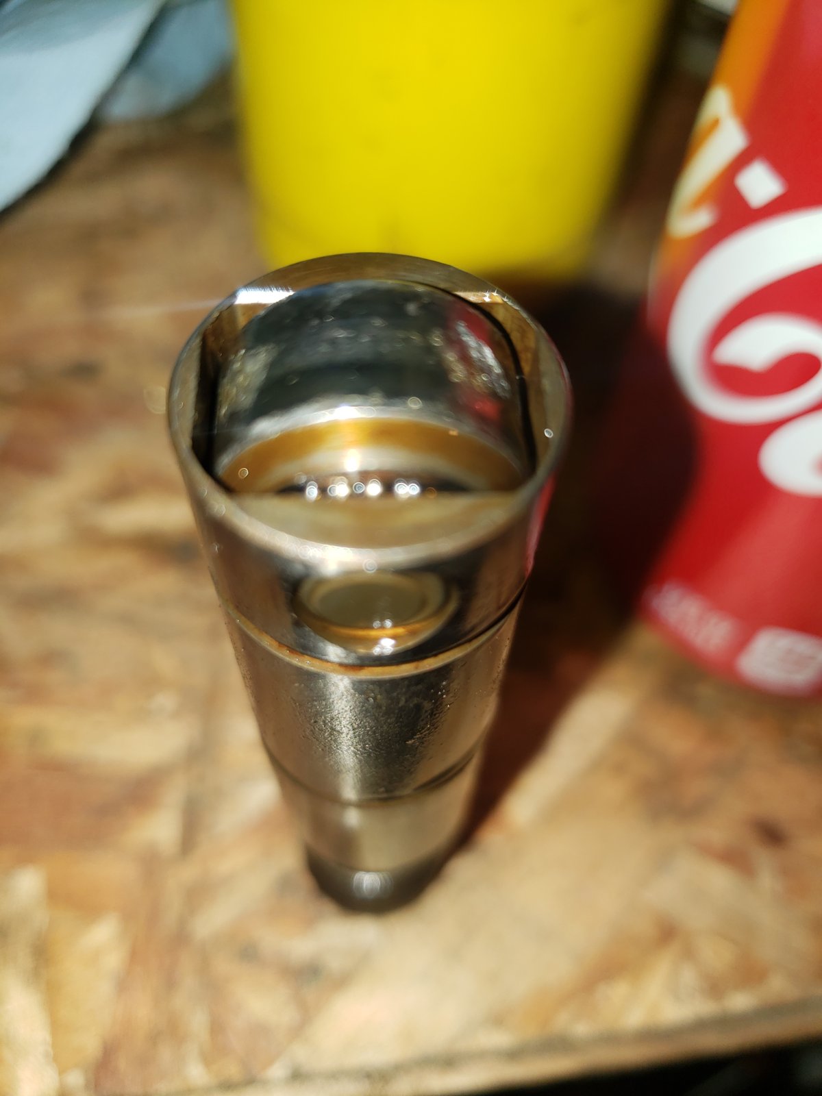

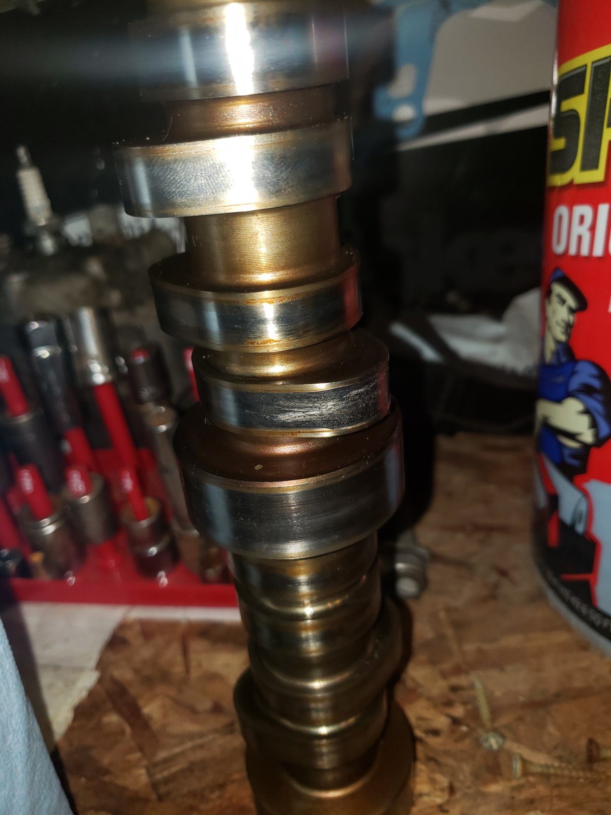

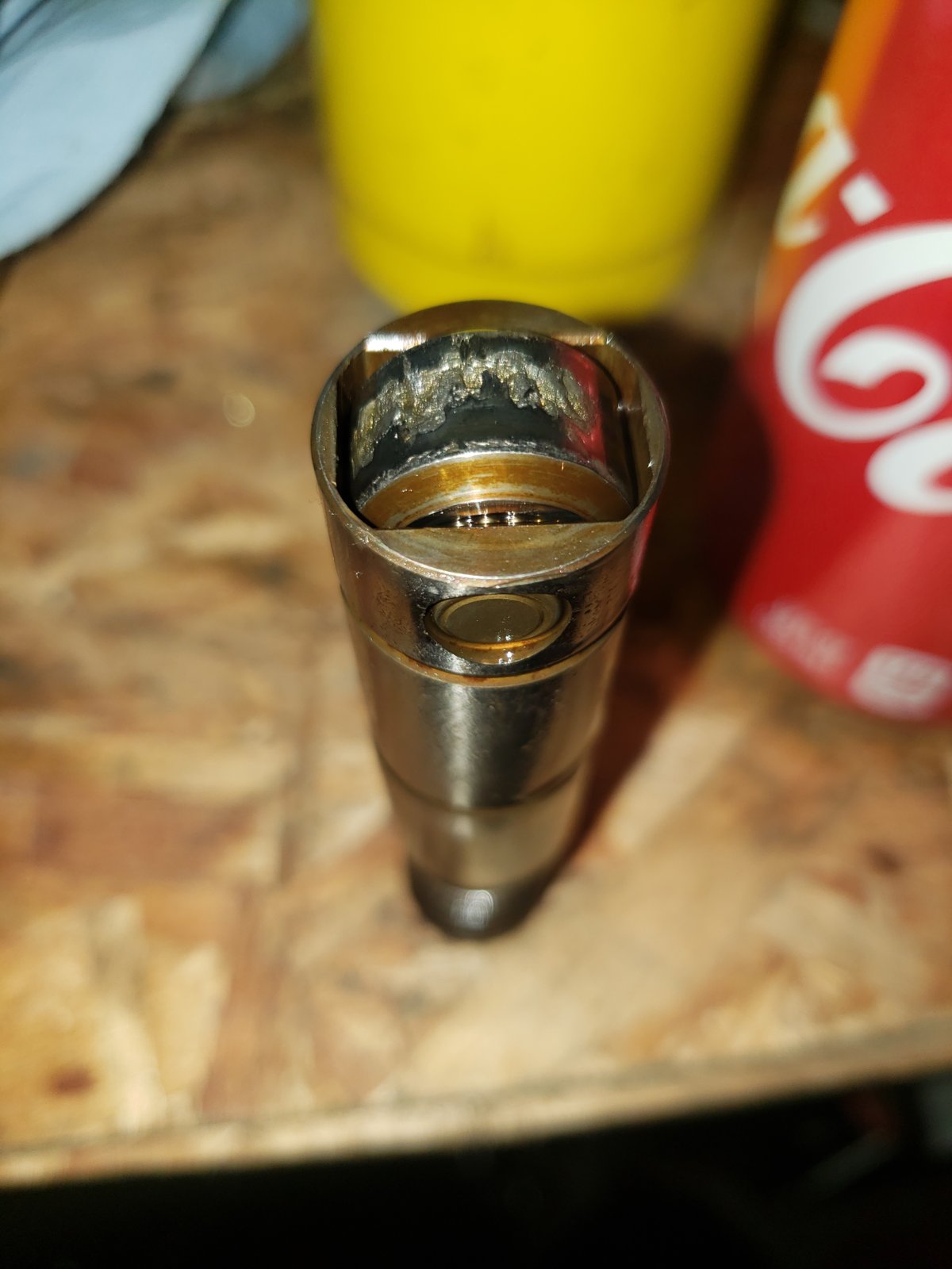

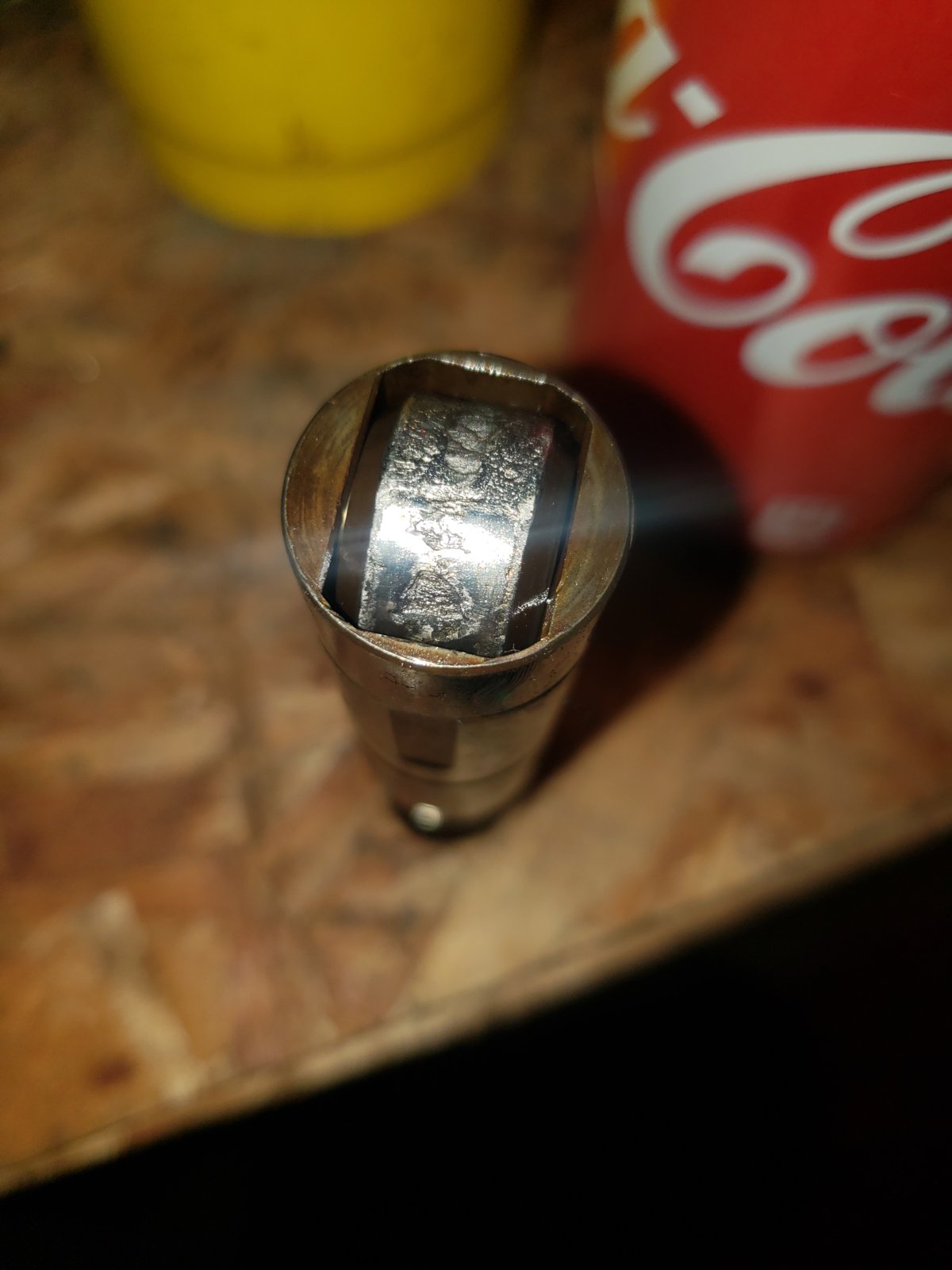

Just a few pics of the damage. 2007 Tahoe flex fuel 5.3.
Swapped with DOD delete kit from ams racing. Still having p0101 p0106 and p0068 codes that were not present before cam swap. Only thing I can think is the valves carboned up. I've replaced all the sensors with ac delco and it doesn't change a thing. The new and old parts show the same results on live data so im thinking head gasket leaking or valves leaking. I've put 6500 miles on the truck since, just clear the codes and roll. Spark plugs look fine. Oil is clean at every change, changed early to ensure it's always clean. Anyone ever exclusive these problems.

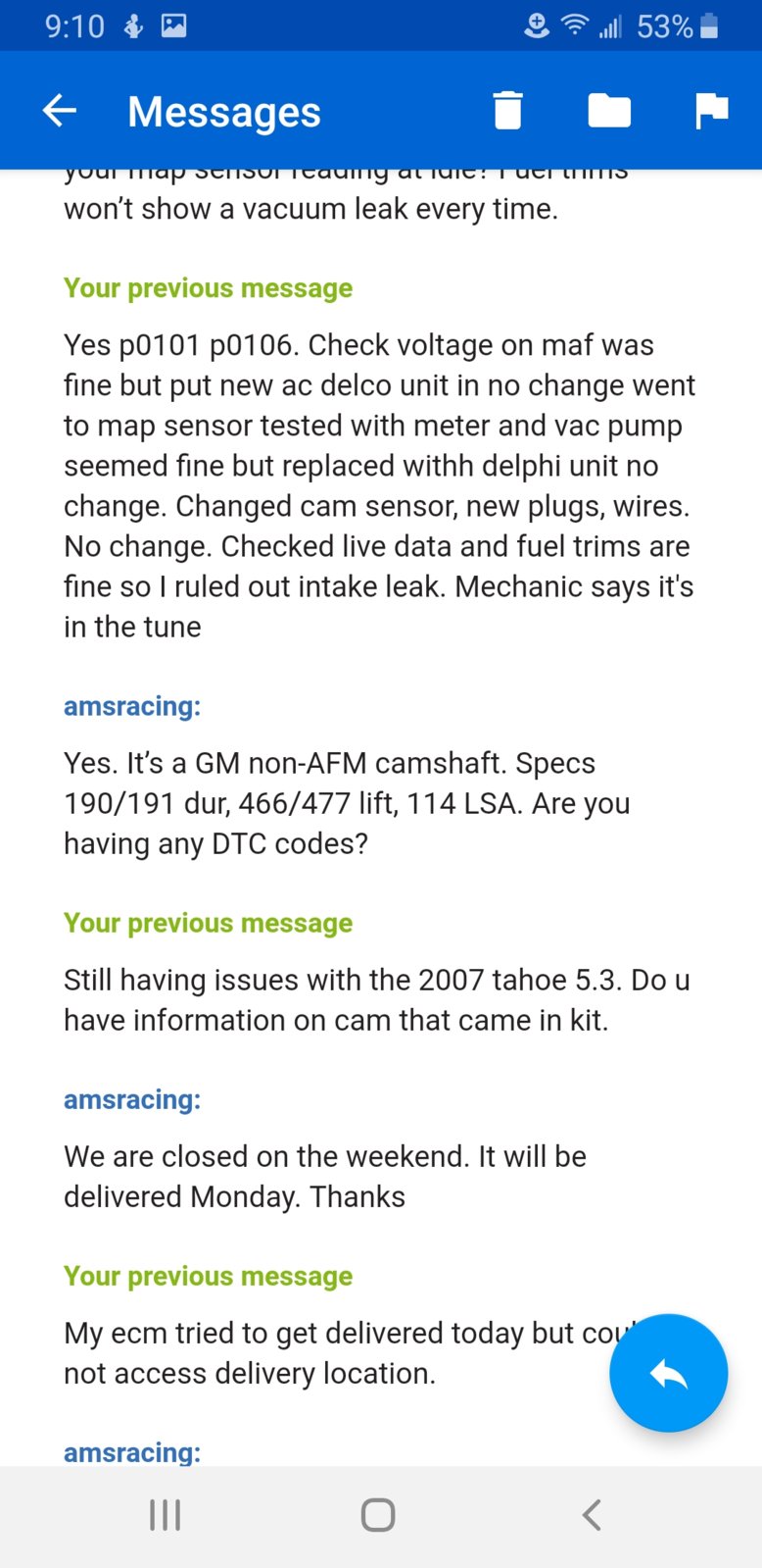

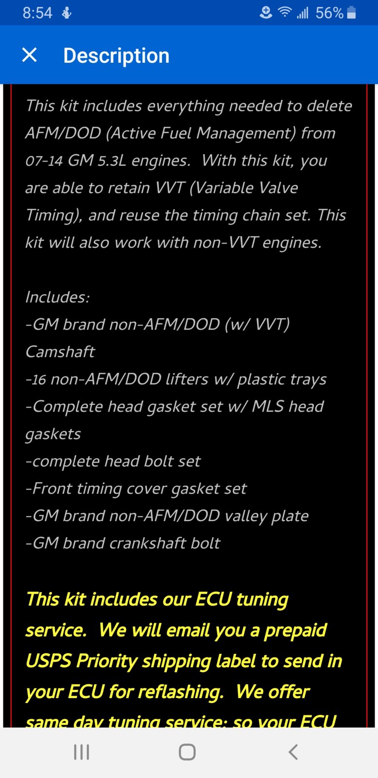

That's the kit I purchased, they said it's the same cam without DOD. They also tuned the computer. I've contacted them several times and they say I have intake leak. Can't b, I replaced intake gaskets twice after swap not them, sprayed all over entire engine with starting fluid with no fuel frim change. My mechanic says it's in the tune. Ams says they have done several tunes with no problems. The codes suggest more air coming in than its reading. I'm stumped, ams says they will look at tune for free but that's more down time which I can't afford right now. Was hoping someone in my area would use hp tuners and look at the tune. I would pay lol. Btw the truck pulls harder than ever and runs great.

A stock tune is going to include AFM and throw different codes—it needs a custom tune with this cam in mind. It may or may not be the tune, but I doubt it’s a vacuum leak like they’re saying.

The tune they loaded better of had afm delete in it since they sold him an afm delete kit..... but ya never know.
