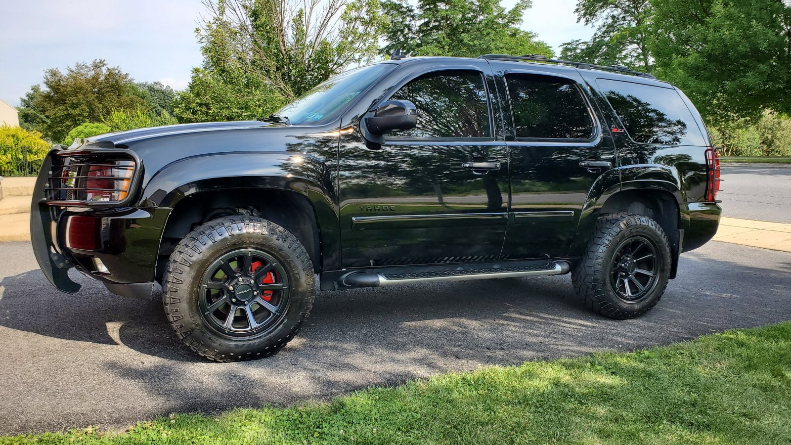

I did. I have 275/70/18 Duratracs with a 2/1 level. No rubbing at all ever but it required A LOT of trimming. It actually wasn't as bad with the stock wheels. It was when I got the aftermarket wheels (+18 offset) that it really got messy.
Thanks for letting us know and sharing your trials! Looks great!
