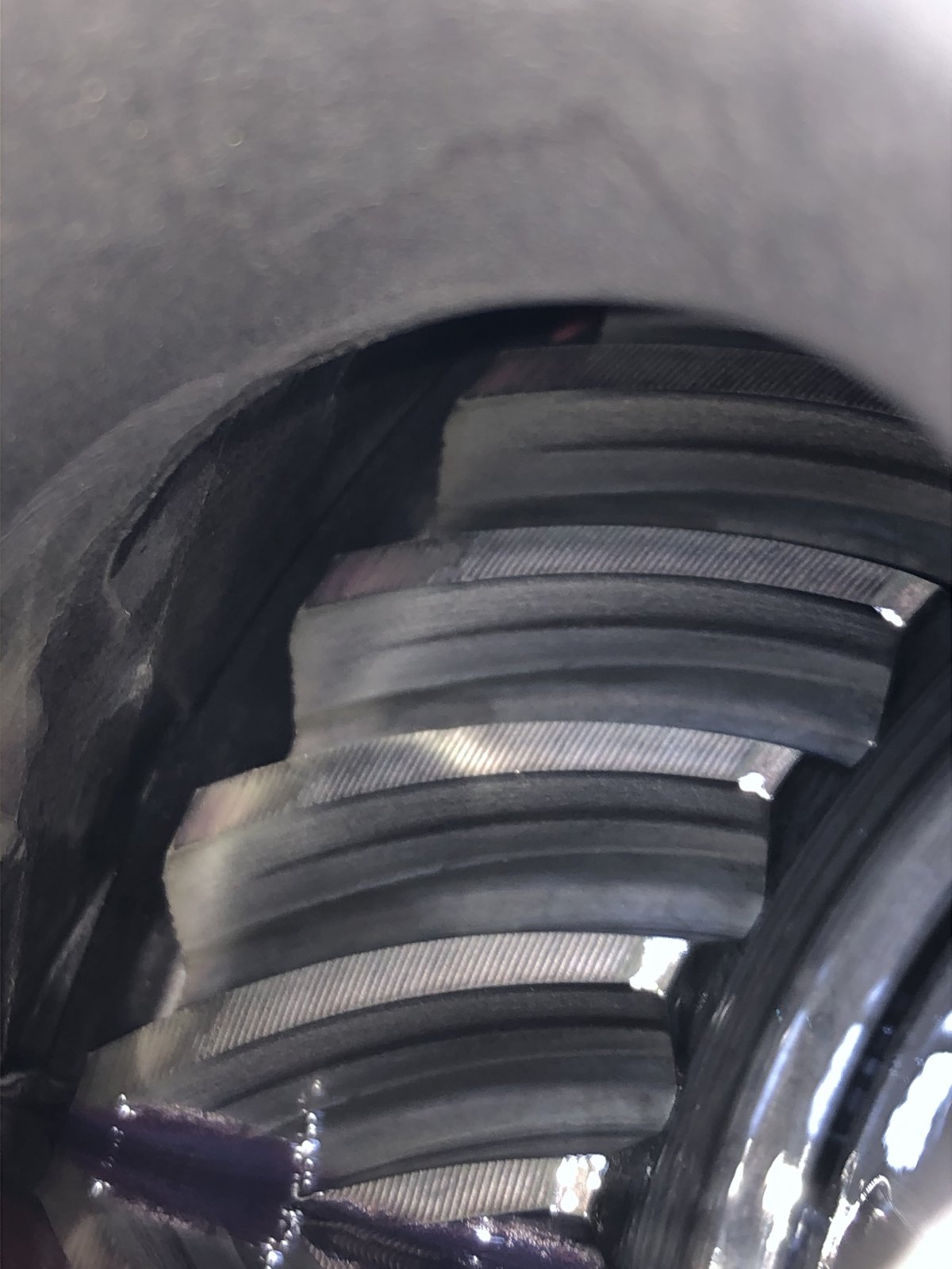

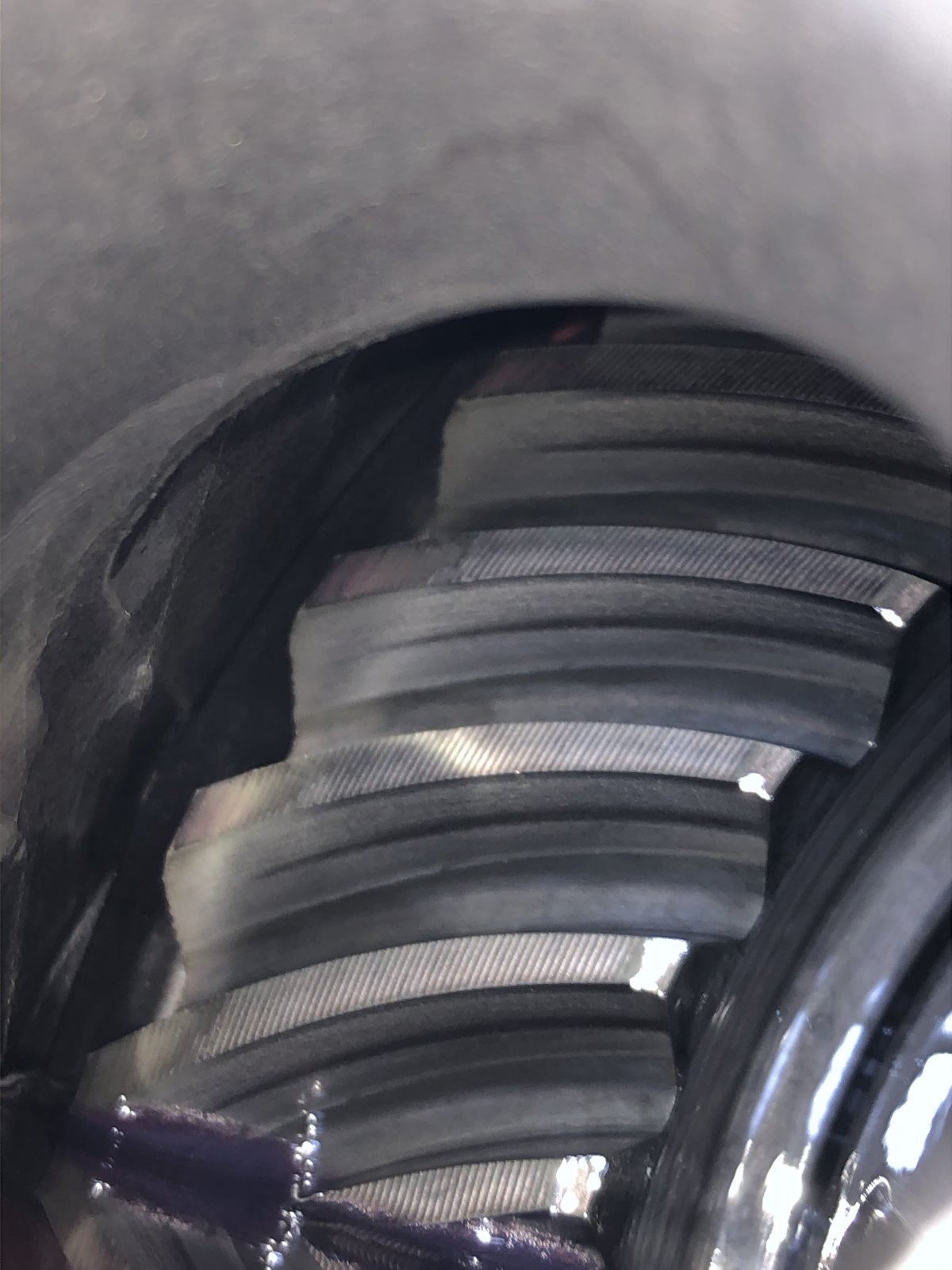

I've been grabbing the special seal and bearing installers off ebay here and there. Still need the bearing pullers. I think your ring gear looks ok but would want to see the pinion. Mine has a noisy bearing that makes a racket between 35-45 mph.

Pic isn't the greatest for me, is the pinion depth correct? I would try that 1st.

I don’t know. I have never had it open. I noted in the service history that it had bearings replaced at around 38k. I noted was noisy and low on lube when I used 4wd the first time.

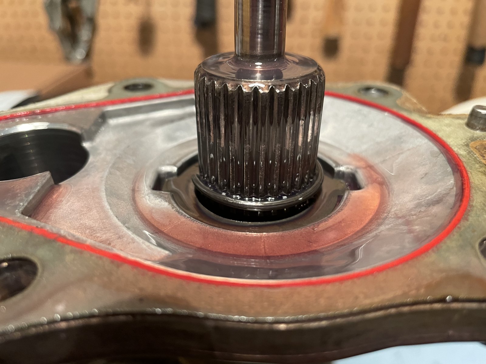

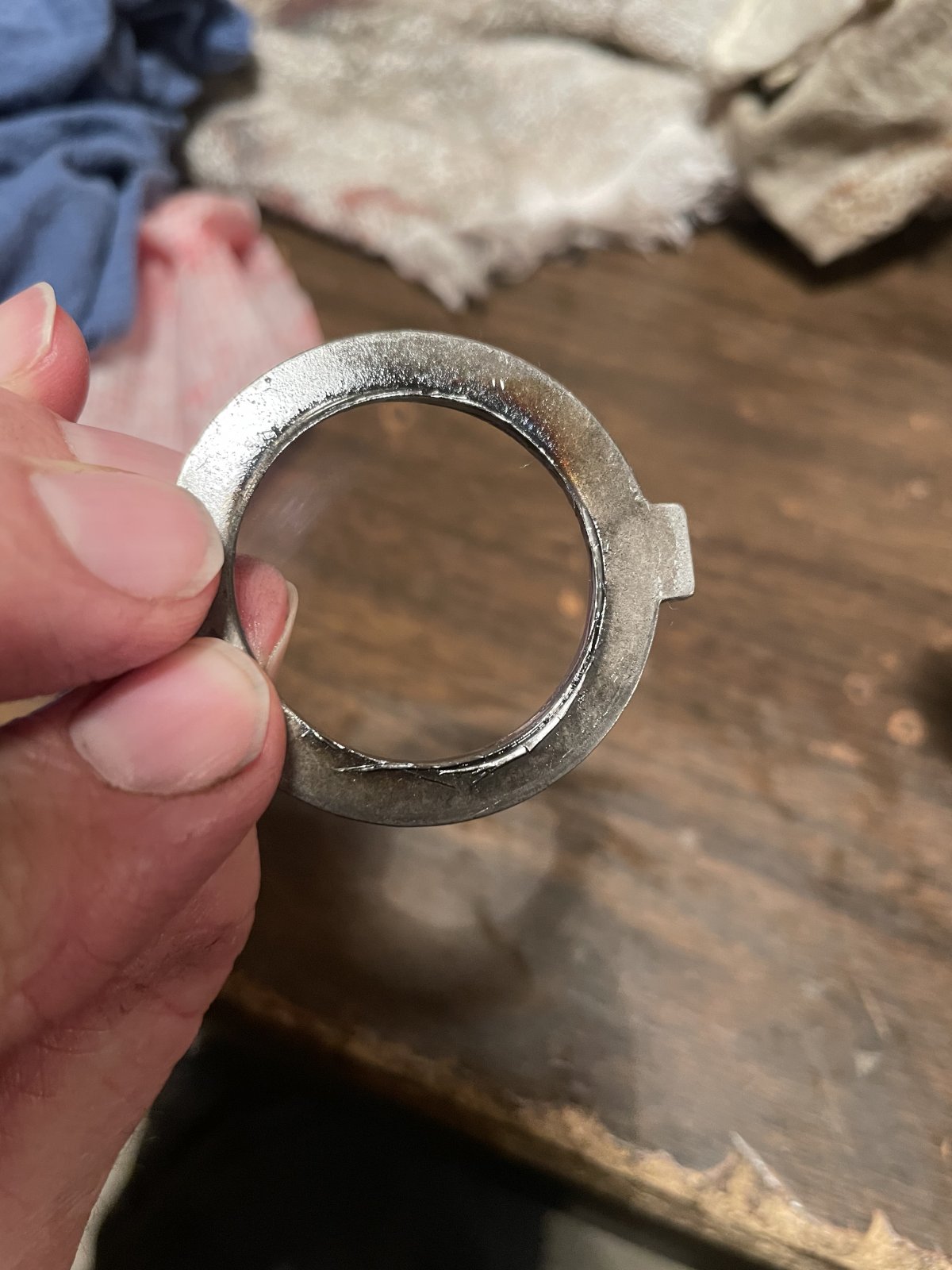

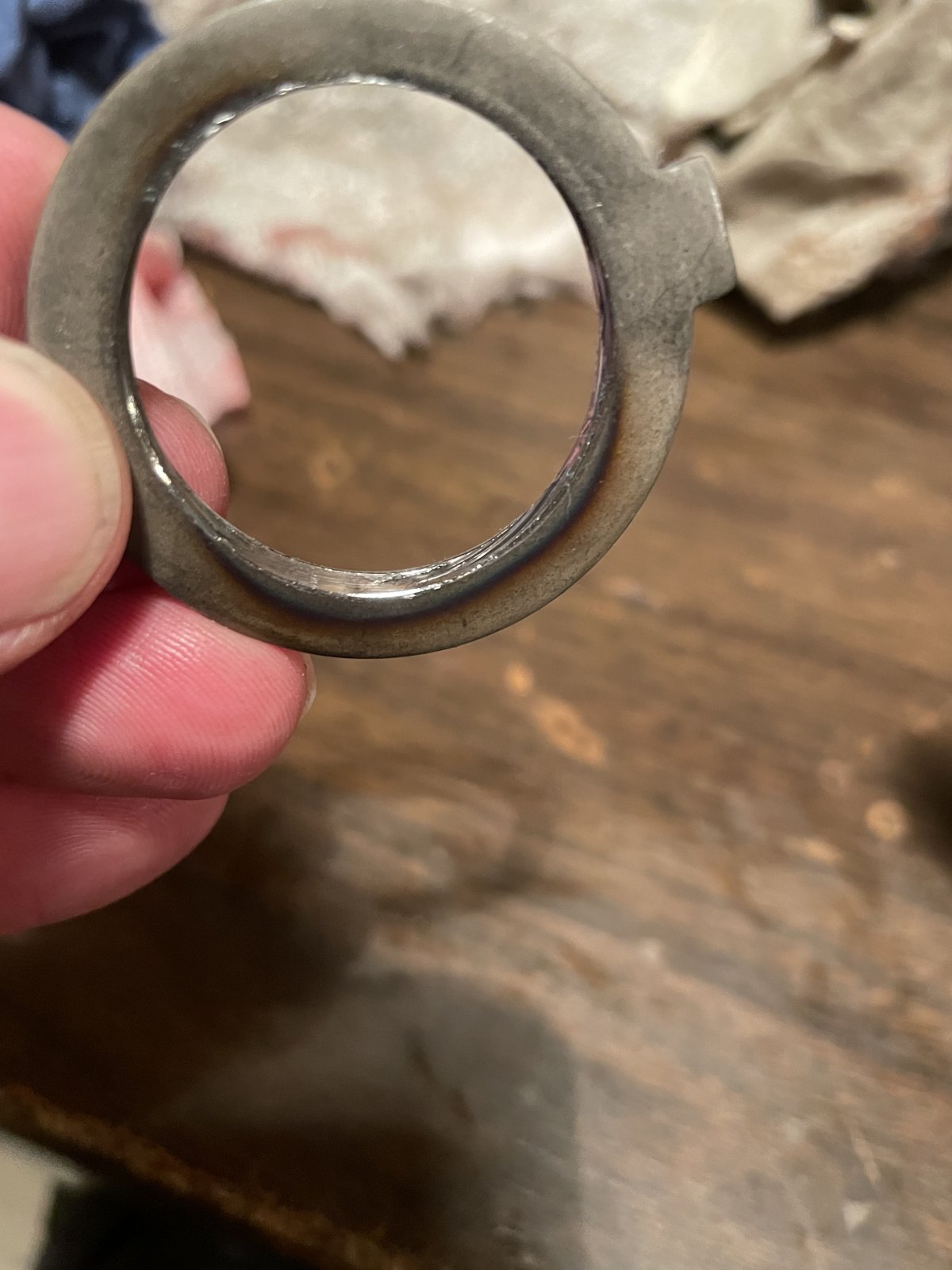

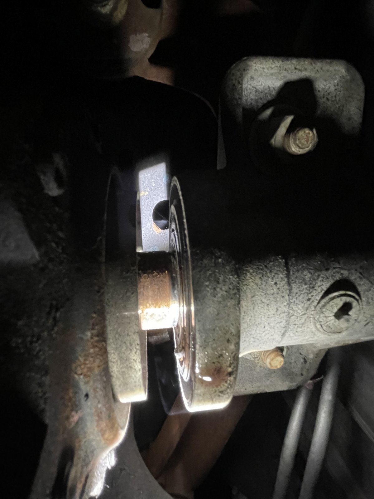

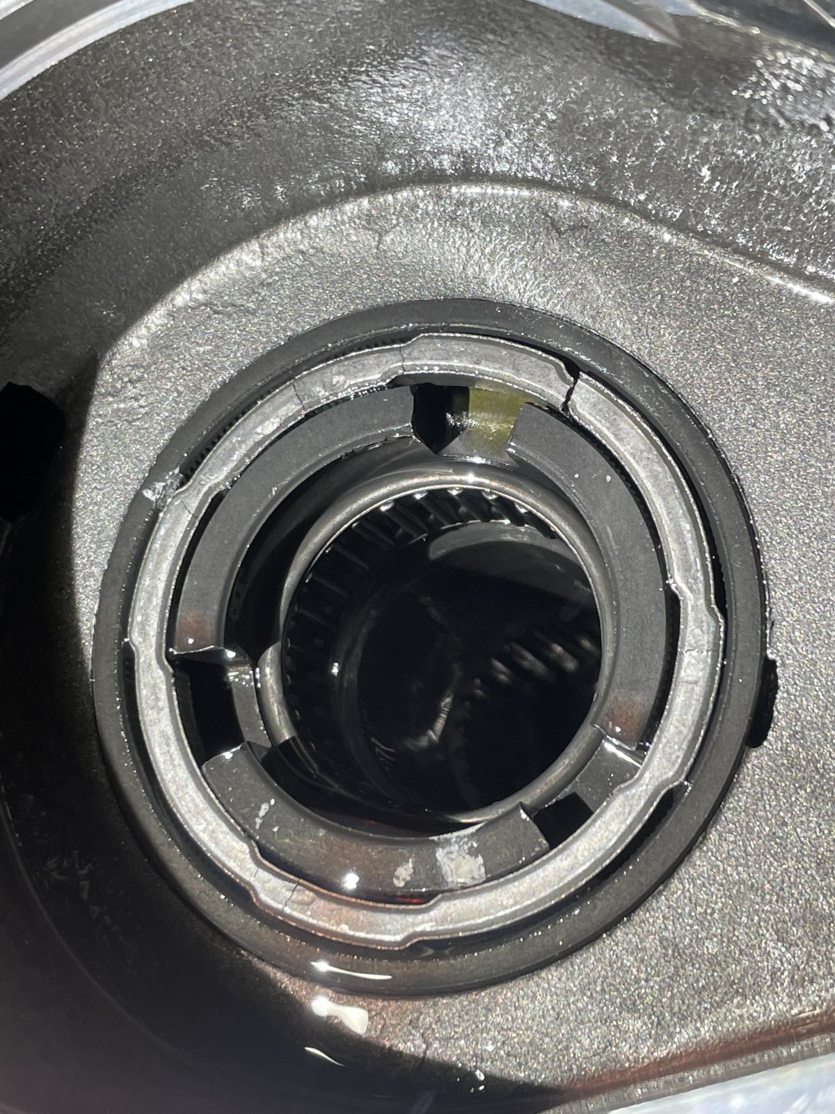

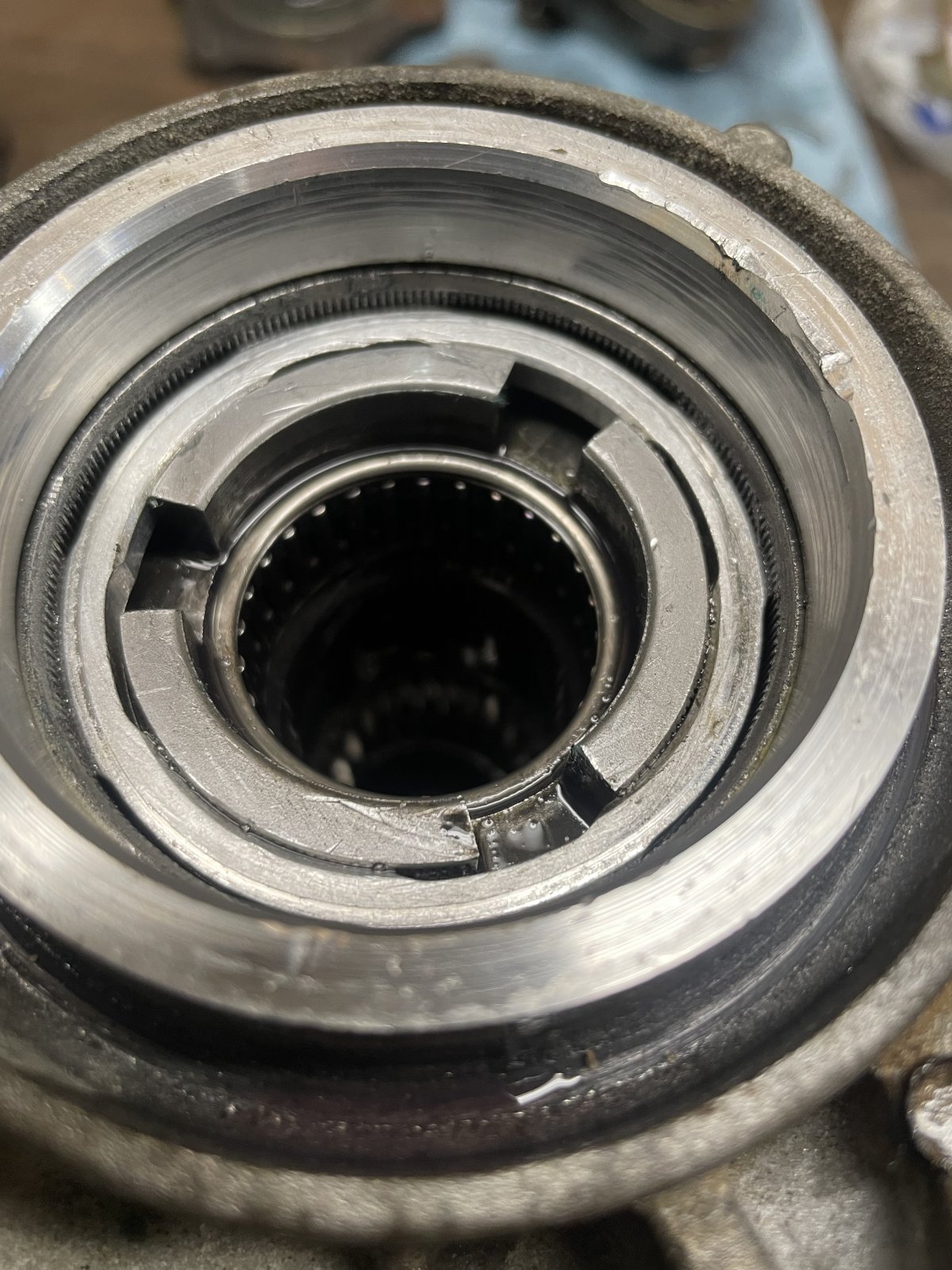

This came full circle this weekend. I noted I didn’t have functioning four wheel drive. I assumed the actuator in the front axle was bad until I saw a puddle of gear oil on the floor. The right side axle had come loose from the snap ring and walked out of the housing.
Upon closer inspection After disassembly I found that the snap ring had worn through the washer inside the extension housing.
I also saw that the adjuster retainer was broken in several places on the right side.
I rounded up a new washer, a pair of seals, two adjuster retainers and an extension housing gasket. Once I placed the new washer in the housing I noticed that I couldn’t tighten the extension housing without it binding the shaft by pinching the snap ring into the washer. I welded some tabs onto socket so I could turn the adjusters and reset the lash as best I could for a used axle. That moved the carrier over far enough to allow the extension housing assembly to be installed and allowed for a little end play for the right axle shaft. The rest went together without a hitch and it now runs smooth and quiet.
Whoever was in here before was incompetent!
