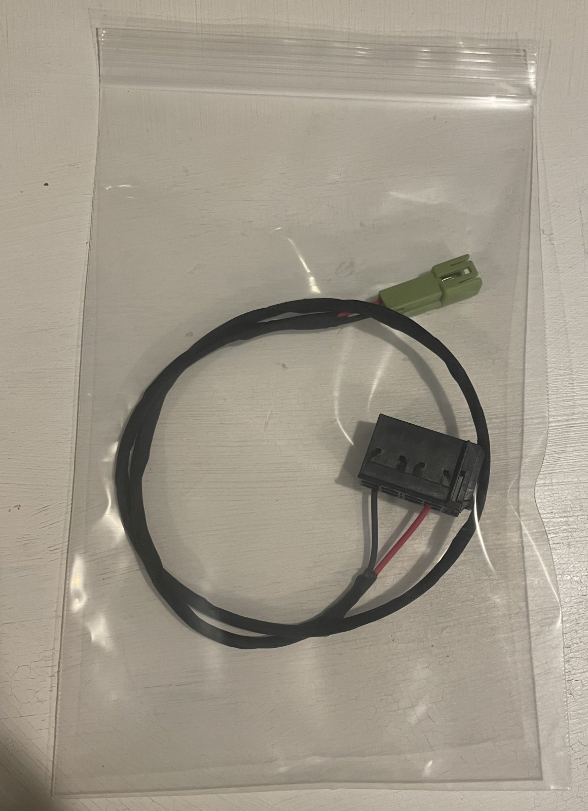

Post #9 on page 1 talks about a plug and play harness that a member of this forum makes
If you want to be more invasive and save money. Just run a dedicated circuit with a relay that turns off with the ignition.
I have no advice on which existing fuse you can tap off of.
All data has the wire connector part numbers that will plug directly into the OE fuse location as well as the clock spring harness terminal ends.

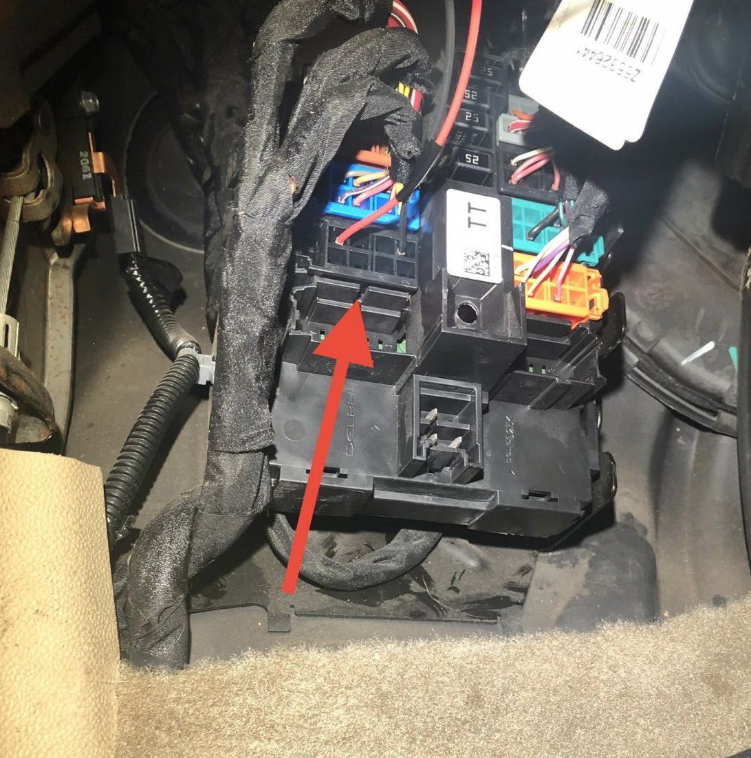

What fuse location did everyone tap into? It's a 7.5a, I've tapped into different ignition fuses and it keeps draining the battery. The final step and the wheel works, it's great so of course something little had to happen.
you tap into the kick panel to left of where your left foot sit's, it has a black cover that pops off and there will be open connections there unless you have a ltz, denali or escalade, then they are all occupied. if you poke around the site or web the pinouts are shown/pictured. ground and accessory power are there.

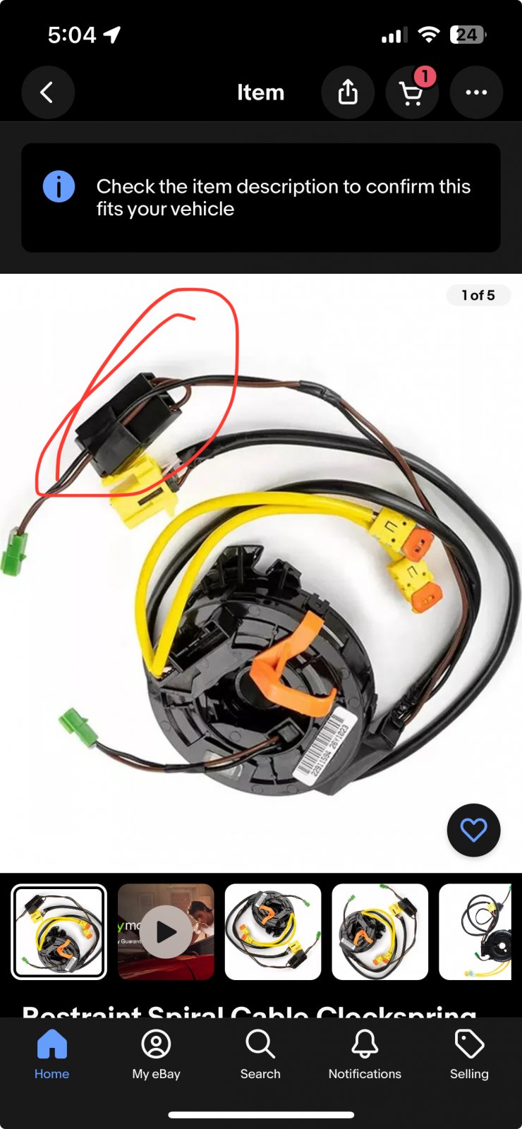

Notice the PNK/BLK wires both sides, your right on about the wheel heat, that would be a simple relay to setup.
