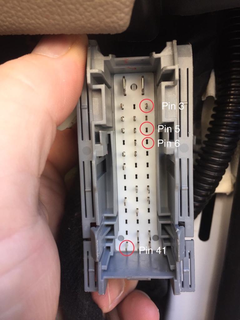

Checking the pins at the door harness (cabin side) is the best way to determine what’s needed for the DL3 mirrors to work.
SUVs differ from the trucks in that the needed wires are typically present in the door harness, but are missing from the body (cabin) harness.
This pic has the connector upside down, but you can see the pins labeled to check.

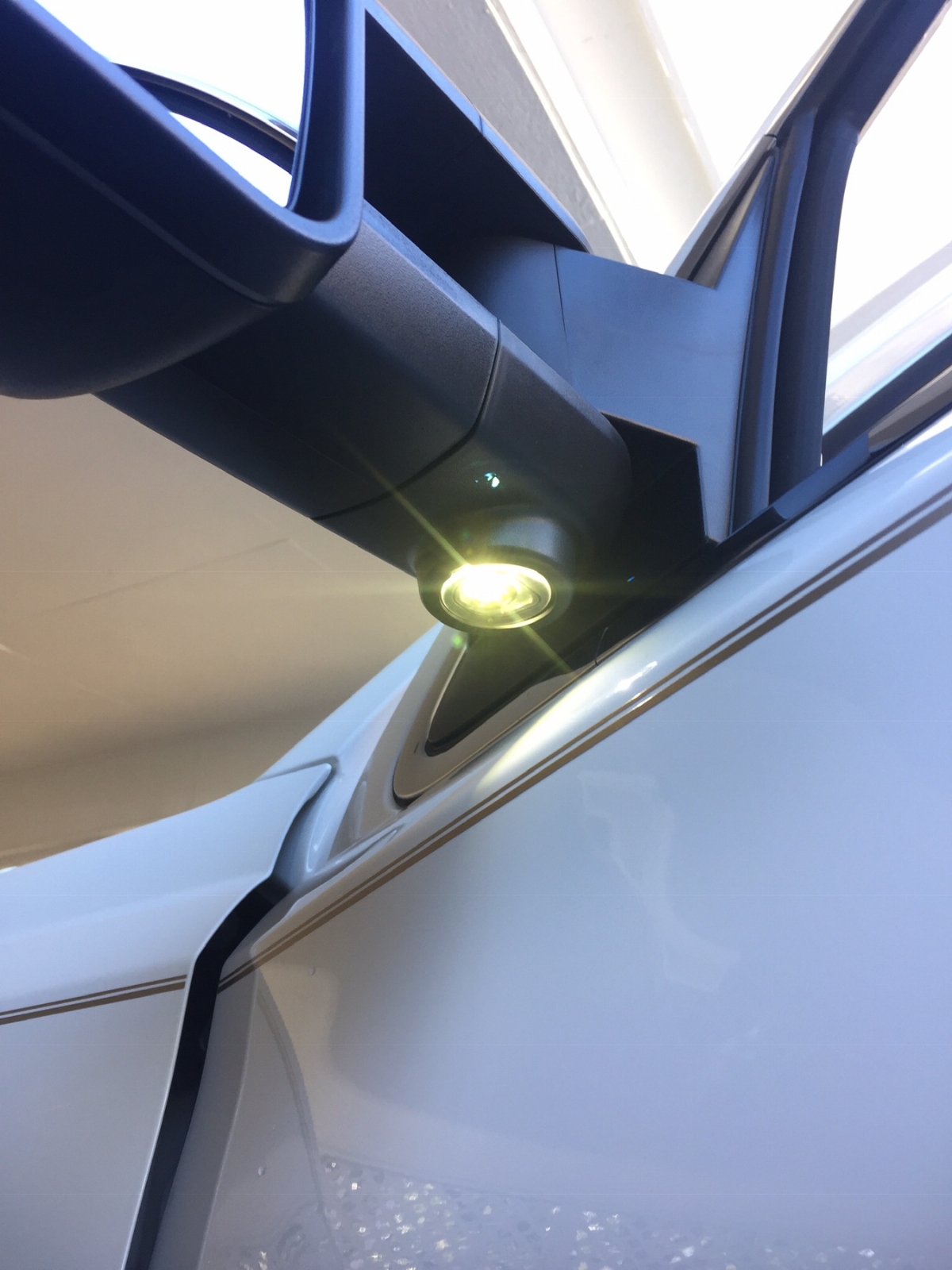

Some time ago I knocked the plastic clamshells off the front of the LH mirror. Mirror was fine. Couldn't find the lower clamshell part anywhere. So, I purchased via eBay a new aftermarket replacement mirror (non-towing, puddle light, turn signal, power mirror adjust, power mirror fold). While having done my research to see if that would work on my truck, I learned I'd need a DL3 door window/mirror controller switch, and found a used one immediately available on eBay as well.
Put both of those on my left driver door and immediately I had power fold (manual, via the door switch, not automatic though), the embedded turn signal, and a puddle light. Pretty amazing (at least for me). Power mirror adjust still worked fine. Only thing I needed to do was modify the escutcheon plate inside that has the cutouts for the driver's side door switches (windows, locks, mirror, etc) and a little work with a Dremel tool got that cleaned up. This is cool, I thought.
