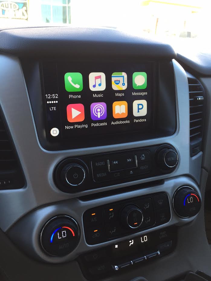

Anyone purchased one of the kits to add CarPlay? I'm about to pull the trigger and was curious if anyone has done it?

I picked up the new radio brain, HMI module and USB ports for my 2015, and will have it installed Friday. I believe the modules are 2016 units, so i would expect everything to mirror the OEM 2016 systems.
It cost me $600 for the new parts, which seems a bit cheaper than everything else i've seen posted online.

Can you document the process for those of us who might follow in your footsteps please?
I decided to take it to a local car audio shop to have them do the install... I'm sure it's doable if you have the time and tools, however there are lots of trim pieces which must be carefully removed so that the clips/trim arent damaged...so for $80, i'm gonna leave this job to the professionals.
