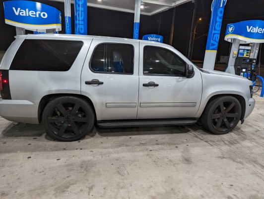

Anyway to add air ride to 2014 PPV? I have TBSS Wheels 285/40/24, and belltech 3/4 lowering kit. Could I plug in the escalade system in? PXL_20230102_042334110.jpg

Your best bet might be to get air springs and install them inside your current springs.
The Escalade air setup will physically work, if you want to do all that.
17,879
22,260
Such would require the wiring harnesses, modules, air compressor, leveling sensors and programming of the ECM, BCM and Chassis modules.
