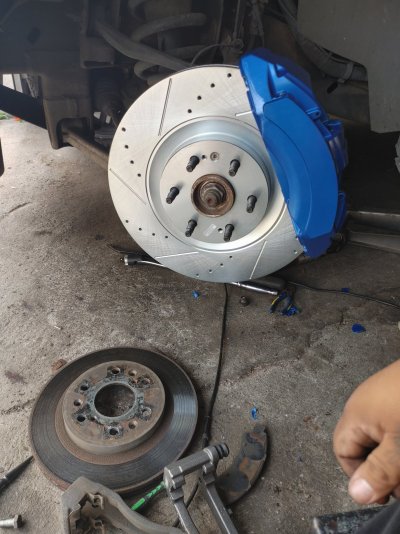

I was hoping maybe someone can shed a little light for me. I have a 2007 Yukon denali. I bought the Brembo 6 piston calipers and I mocked everything up. I did not have any fitment issues with the calipers or the rotor. Surprisingly all I needed to do was put the bracket that holds the real speed sensor so that it wouldn't hit the caliper. Now the only issue I have is that my wheels won't clear the caliper. I would have to add a 2 inch spacer in order to run my current wheels. So my question here is, does anyone know the specs for the wheels on a 2021 ppv vehicle with the 6 piston Brembo calipers?
I'm asking specifically for the offset. I'm just going to buy a whole new set of wheels

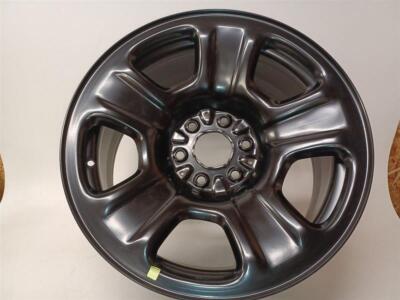

If this is the wheel..

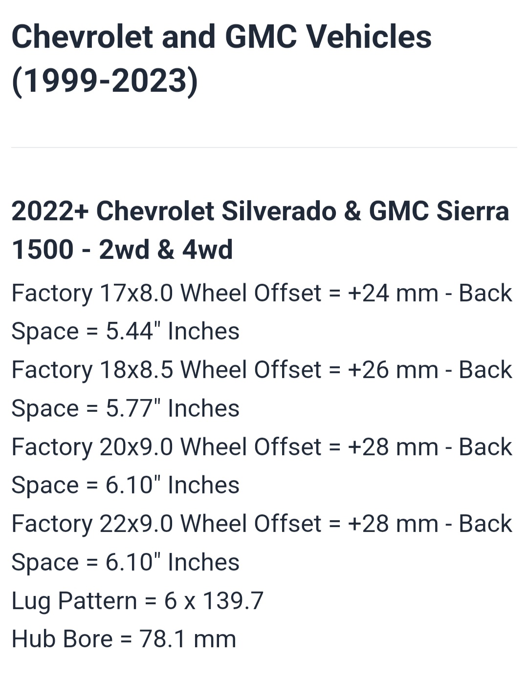

The photo seems to show 28...
and that tire size page shows 26-30.
Please post pics when you get them on! They look pretty cool..

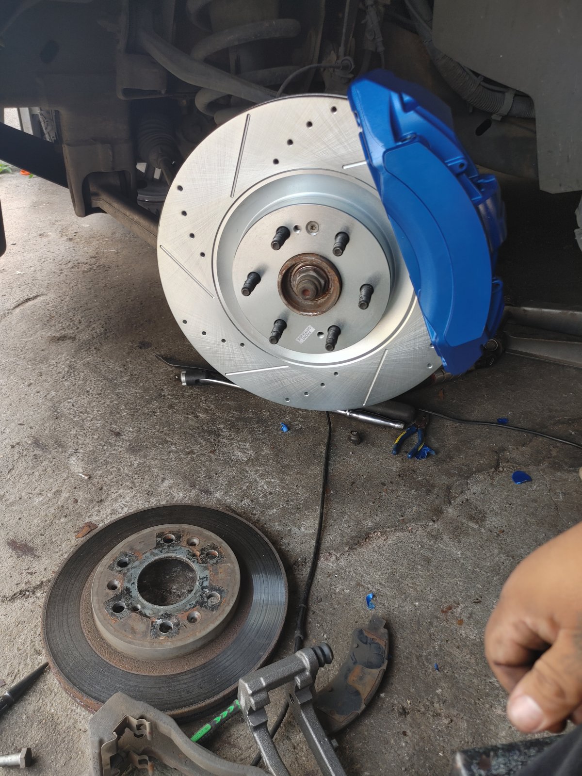

This is a preliminary fitment and i'll repost once i get new wheels that clear the rotors. Painted them myself lol
