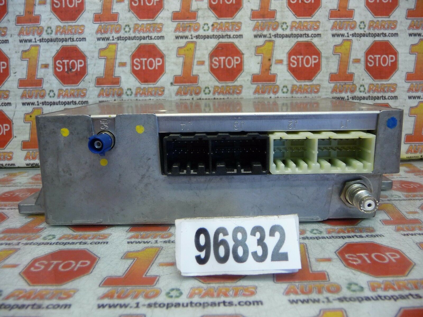

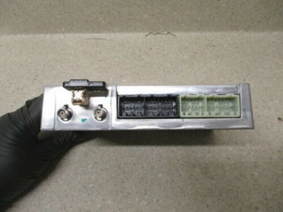

Has anyone successfully added bluetooth phone capabilities to their truck using a newer model Bluetooth Communication Control Module 25984444 ?
I read several threads that describe it, and many talk about it, but not one says "yes it worked in my 03-06". I do not care about my OnStar working... I simply want bluetooth phone in my Denali.
I have an aftermarket bluetooth, but I just am not happy with it, and have use a later model one, in my dads 2012 Suburban, and it works sooooo much better...
Anyone actually done this?

The plugs appear to be the same....
