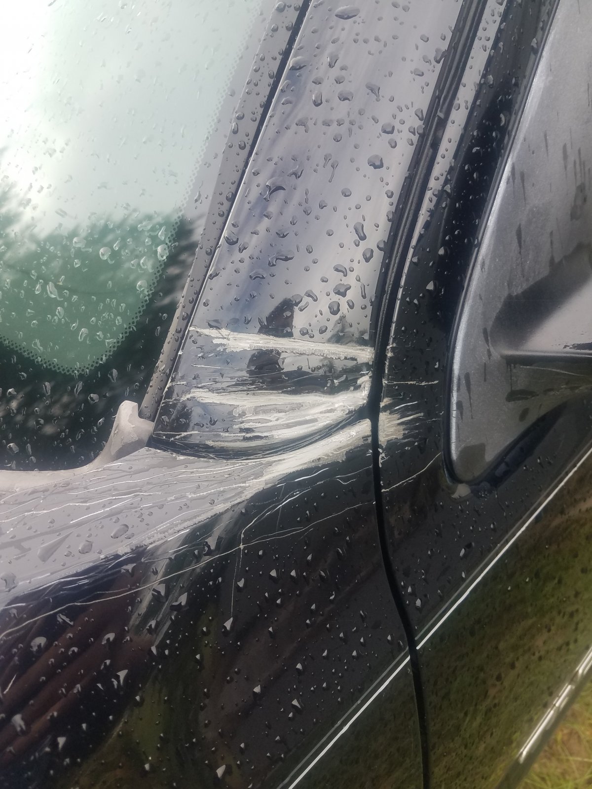

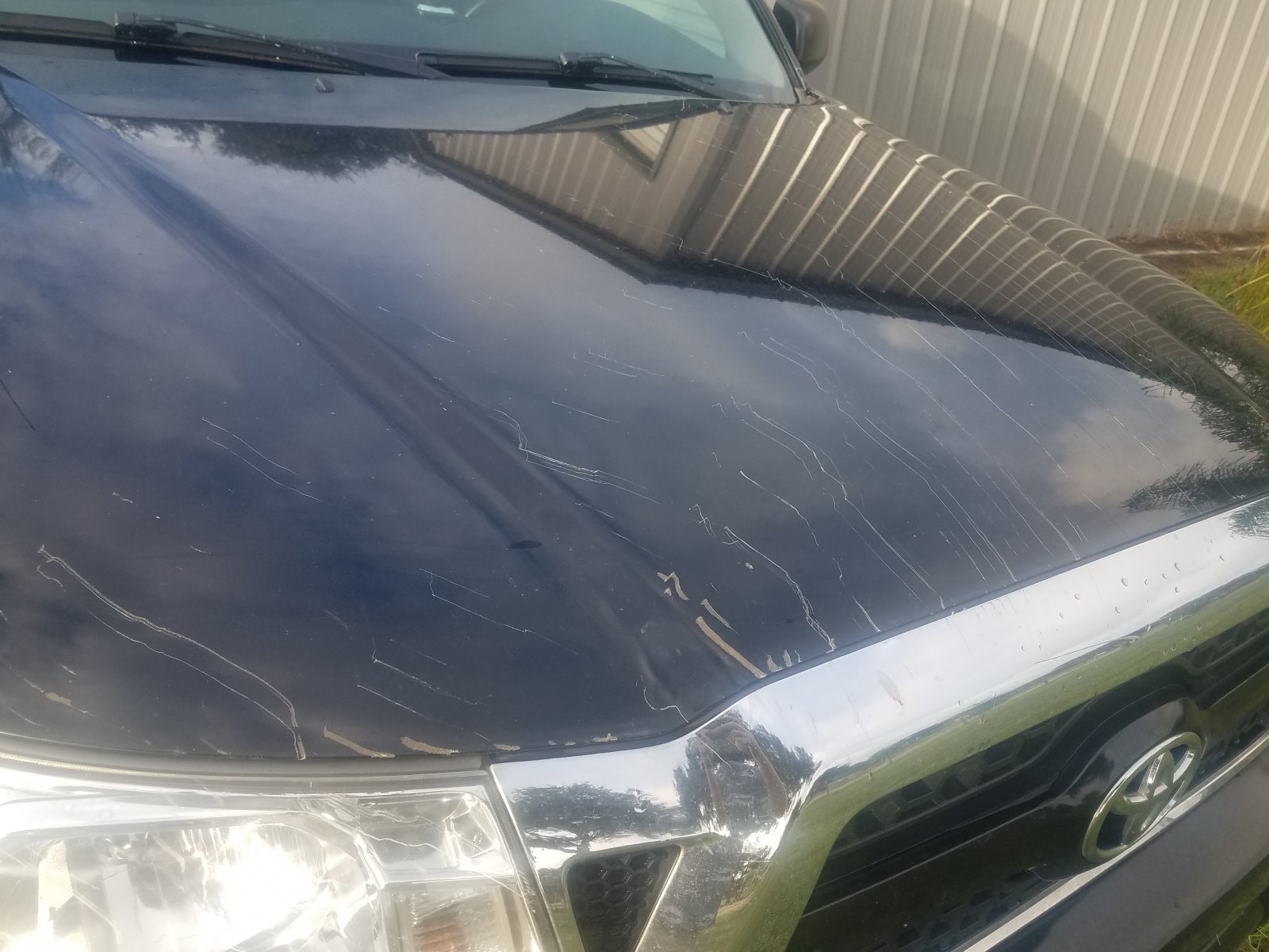

No, a family member borrowed it and had a medical event 300yards after leaving my house. Ended up sideswiping a fence took out 4 posts and wrapped it up in barbed wire which ended up holding it from rolling into a very deep canal. Nobody is hurt thankfully but it took about 20minutes to cut and untangle the barbed wire before the truck could be pulled out. Truck is driveable but the scratches are down to the metal so it needs a lot of paint work.

Wow! I hope your family member is ok/better!
Thank you! Shes fine doesn't remember anything (had a seizure) except after it was already stuck she put it in 4x4 and mashed the gas :driver:. Thank god she was in that truck I think it was just light enough it didn't have enough momentum to break the wire and fall into the canal. And like everything else, if it breaks it gets upgrades. Hood scoop hood and Allpro Apex bumper on the way!
