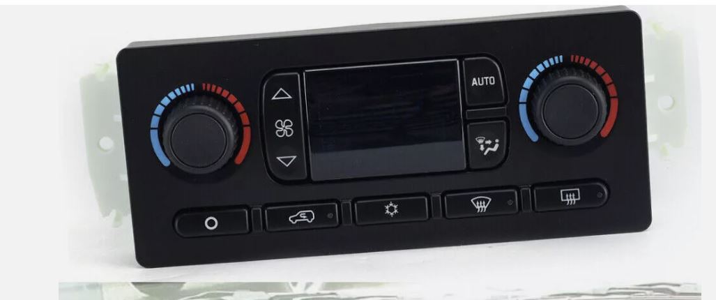

well either you have the digital control with LED's or you have a slider manual control with knobs that "click" to the various settings
as shown below
30,521
47,949
as james noted best to check it with a gauge first
that digital control w/auto function is the one that "CAN" go goofy and do exactly like you are reporting
there is no fix you basically have to replace it and they are not cheap, so best to rule everything else out first.

Got it, sorry - yeah I've got the sliders. Let's hope its not that
