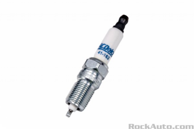

Online specification info shows these measurable differences....
41-110 vs 41-162
Insulator height 25mm vs 24.7mm
Pre-gap size 1.025mm vs 1mm
Everything else seems to be the same
52,954
The guys that had them side by side said the length from the seat where they sit against the head to the tip of the electrode was 3/8” difference but I don’t think that matters.
