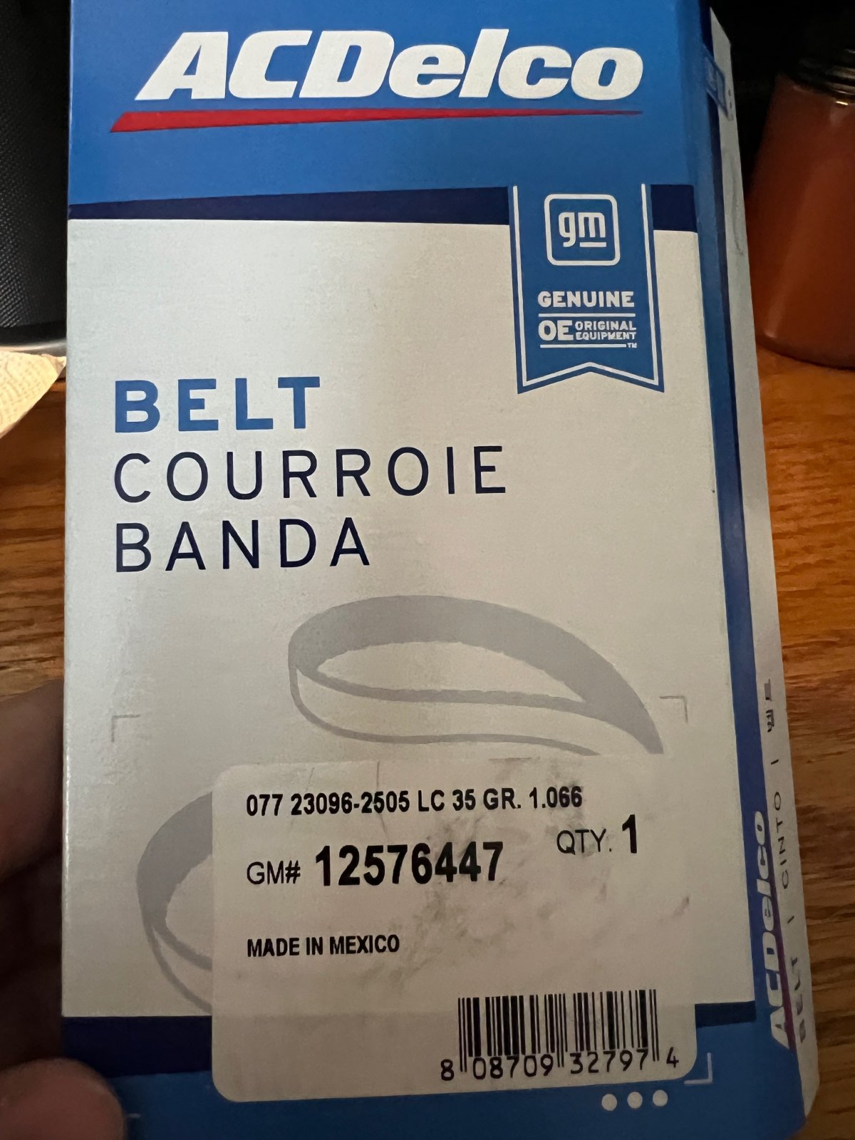

Decided to replace AC belt and tensioner since I was experimenting with serpentine belt sizes for my Mechman 240a alternator. 2004 Tahoe, CJ2, auto front/rear HVAC.

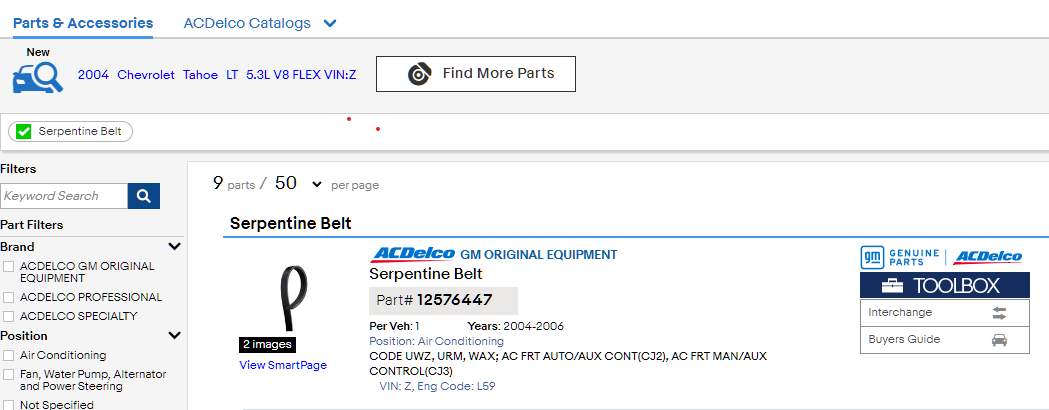

Delco part finder pointed me at:
I cross referenced to Goodyear and purchased from AMZN. (960mm ~= 37.8")
Yeah, that one wasn't going on at all. I didn't want to ruin the belt forcing it on and the tensioner was turned to the max. Any ideas on what P/N I should grab? Just go for OEM? Getting a little tired of ordering several different belts after finding wrong information on what my serpentine belt length was (145a) trying to get the proper tension for the Mechman.
