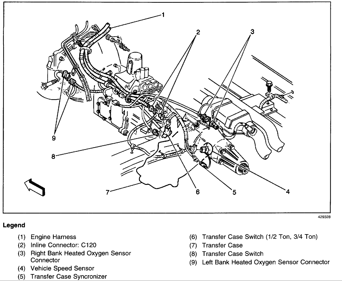

It doesn’t look like it. The rear sensor (Vehicle Speed Sensor) is at the back of the transmission.

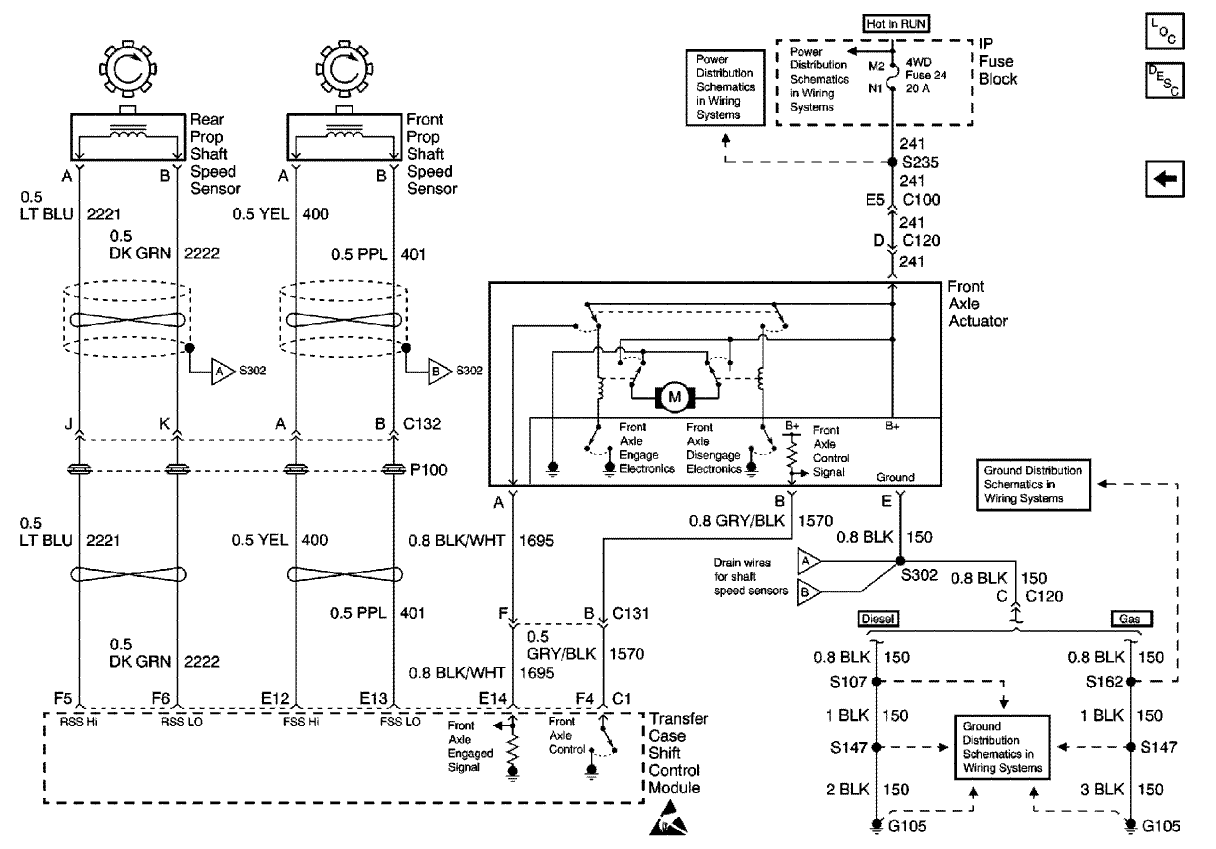

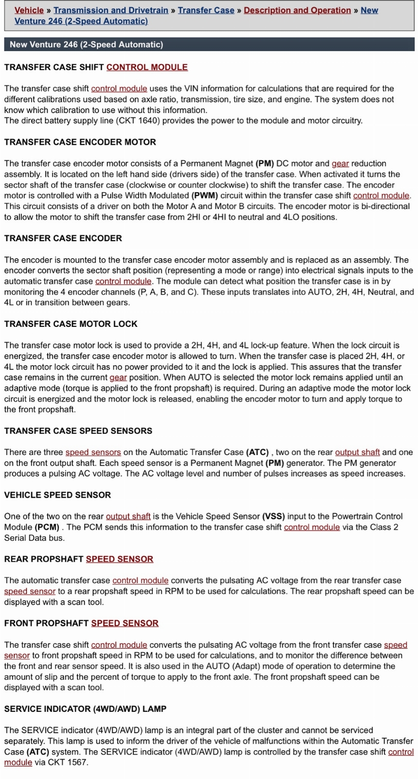

I’ve been looking this up before I drop $950 on a new tc, I found an old discussion from 2012 on gmc4x4.com where a guy says the tc has 3 vehicle speed sensors, one at the tailshaft, front driveshaft, and another that goes through the abs via the wheel speed sensors. Is this correct? Does it sound correct? If it is, that could partially explain any issues I would guess. I really don’t see how except for maybe auto 4wd where the different wheel speeds would help to engage 4wd.

It looks like that is correct:
I’m not seeing those as specific inputs to the ABS, though, but suppose that a flaky sensor could impact the ABS and/or the auto transfer case. But it doesn’t look like the ABS would impact the transfer case unless the transfer case could somehow not handle braking (and resulting speed sensor signals) that would otherwise be aided with an ABS activation. That doesn’t seem like a likely scenario to design a system so dependent on ABS, so don’t take my word for it. Maybe someone would be able to enlighten.

Hmmmm well my speed sensors in the front are inoperable, the abs module is not in the truck anymore since deleting the abs. Good news is nothing has been cut or destroyed so maybe I can just hook up all the wiring and see if it helps?

I edited my post while you were responding, but you may be on the right track with hooking things back up.
