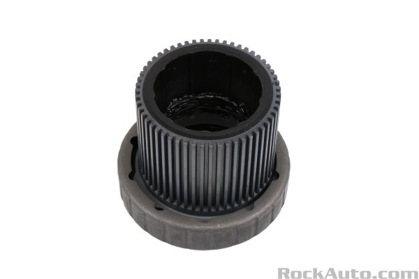

Have you checked the rear wheel speed sensors and ABS Tone Rings? Mine is in right now for a bearing and seal replacement on the rear. We had the same issue when he put it back together, he said there was something inside the housing from the bearing that he'd never seen before and it was flopping around on one side and the other was solid (yeah he shoulda stopped there). Axle, seal and bearing back out and I head over to look at it. I find the sensor on the back side of the axle and figure that is for the ABS. So we get the sensor out and pulled the ABS Tone Ring out (with a bearing puller) and a new one (and sensor) is on the way to me. I'm contemplating having him pull the other axle back out and replacing that one also, but that requires a new bearing and seal so more $$. Part number is GM GENUINE 12479286
