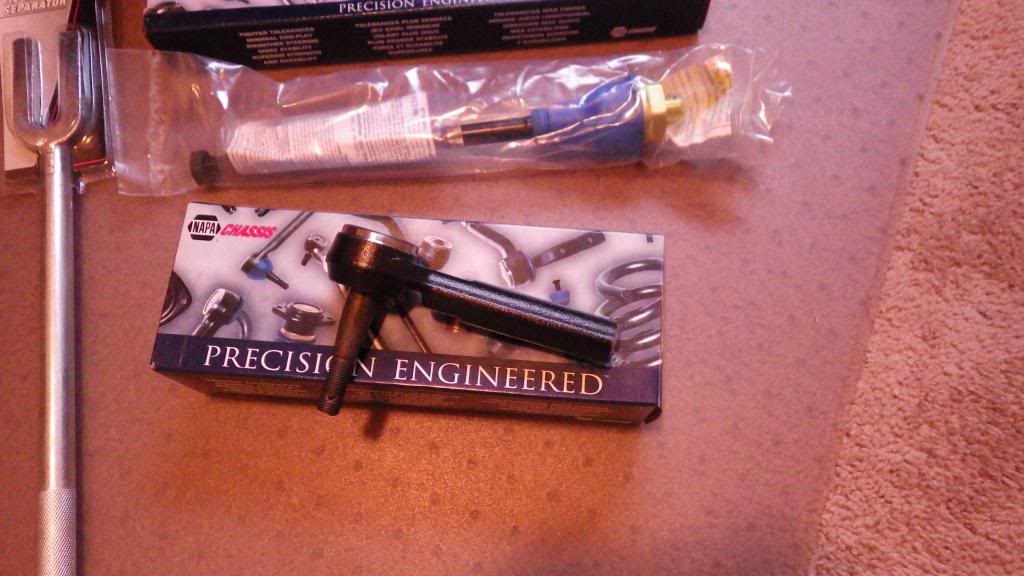

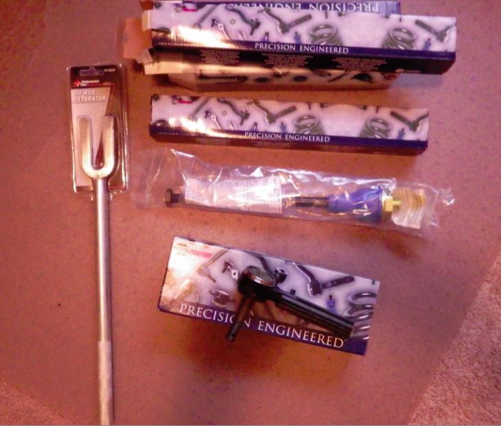

Hi There,
I'm about to get new rims and tires, and I was told during an inspection that my tie rod grease seals are shot, so I figured this is a good time to replace the tie rod ends and have my Tahoe aligned (once I have my new rims/tires).
So I bought the parts and the pickle fork.
Any input from those experienced in doing the tie rod ends appreciated. I have done other vehicles tie rod ends myself before, but not on this platform. If there's some trick or something I should watch out for, I would appreciate a response.
Thanks, Joe

They are pretty straight forward, more so than a lot of the other vehicles I've owned.
Only suggestion is take the old ones off as one piece so you know the length of what the new assembly should be to make it a better drive to the alignment shop.

make sure you put some thread lock on the inner joints threads.
Another good one. I'll do this too. Thanks

but to the topic at hand, why did you buy the pickle fork? i've never had a problem popping tie rod ends out of the spindle with a hammer, lol, a couple quick whacks on the threads and it pops right out, and since the inner tie rod is a different set up than the mating angles like the outer i'm not sure that you really need that, but thats just what i've always done
its a real straight forward process, i assume you bought new sleeves for the ends?
makes it way easier to thread the new ones
also dont do this at 3 am after a few beers and a day of work under your belt, its possible you may forget that the inner tie rod is left hand thread... lol, may have done that once or twice

I used pickle fork on a Honda no problems. Some are harder then others wacked it with my mallet and no good so had to use the fork
