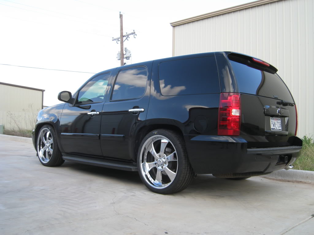

OK i have an 07 LTZ W/ auto ride. It has 22's on it i would like to lower it prob 2/3 or 3/5 but whatever i do i want the best ride as close to factory as possible. is this asking to much cause i dont know. any info would be great also if it is possible what do you guys recomend. name brand if i need shocks and should i go ahead and get sway bars as well.

well, if you have autoride, you can't go lower than 2/3 unless you get into custom fabrication. With autoride, you can't just pop in new shocks, the autoride is the shock.
We have a 2/3 on our Suburban LTZ w/ autoride on 24s and it rides suprisingly very close to stock. The back is a tad firmer, but the front is perfectly stock.
If you drop the tahoe with autoride, my suggestion is take it to a shop that has done this before and has insurance. The autoride sensors and shocks are very sensitive from what I understand and extremely expensive to replace if they get ****** up.

I lowered my girls LTZ tahoe 4/5 and it rides great. I am still running the auto ride struts and rear shocks.
