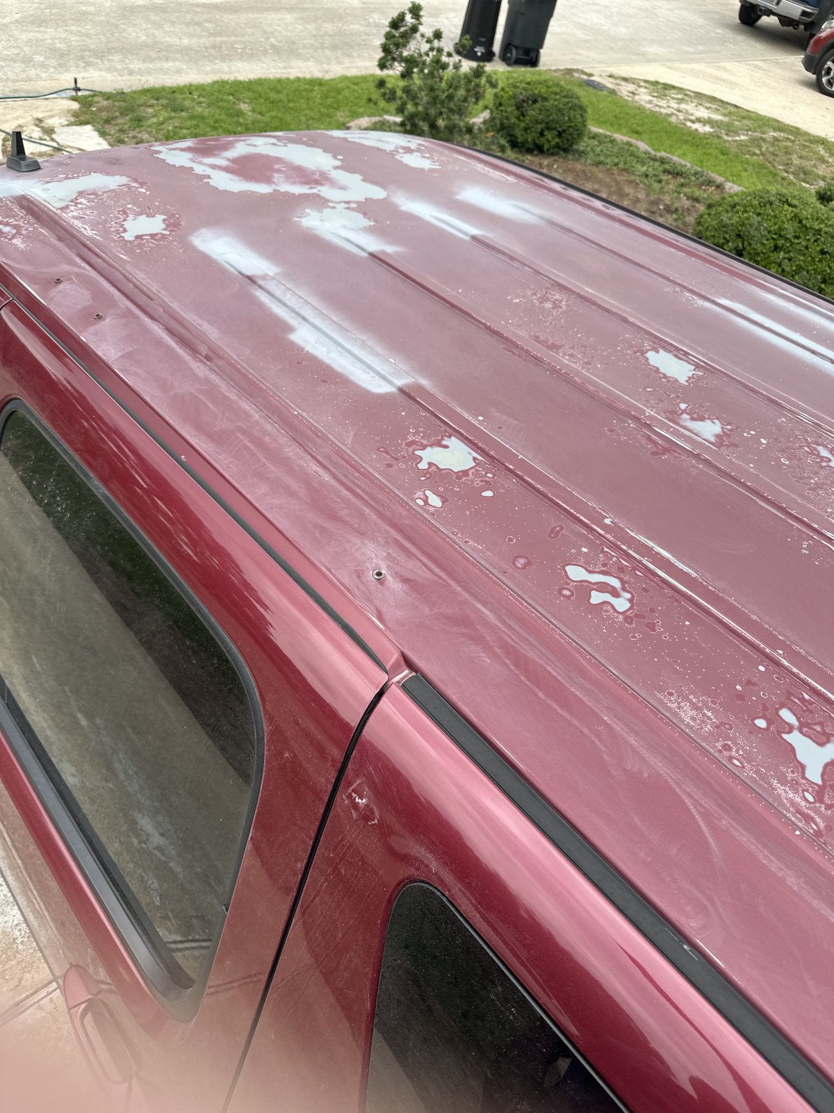

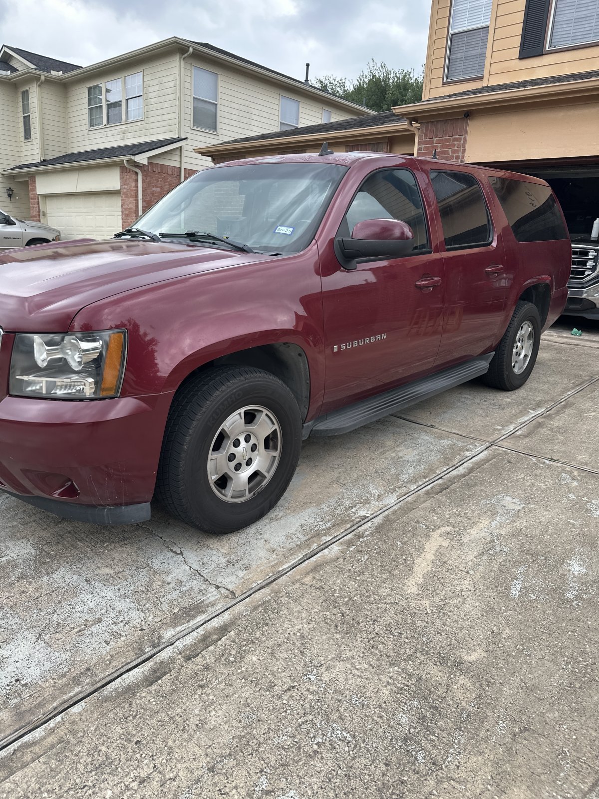

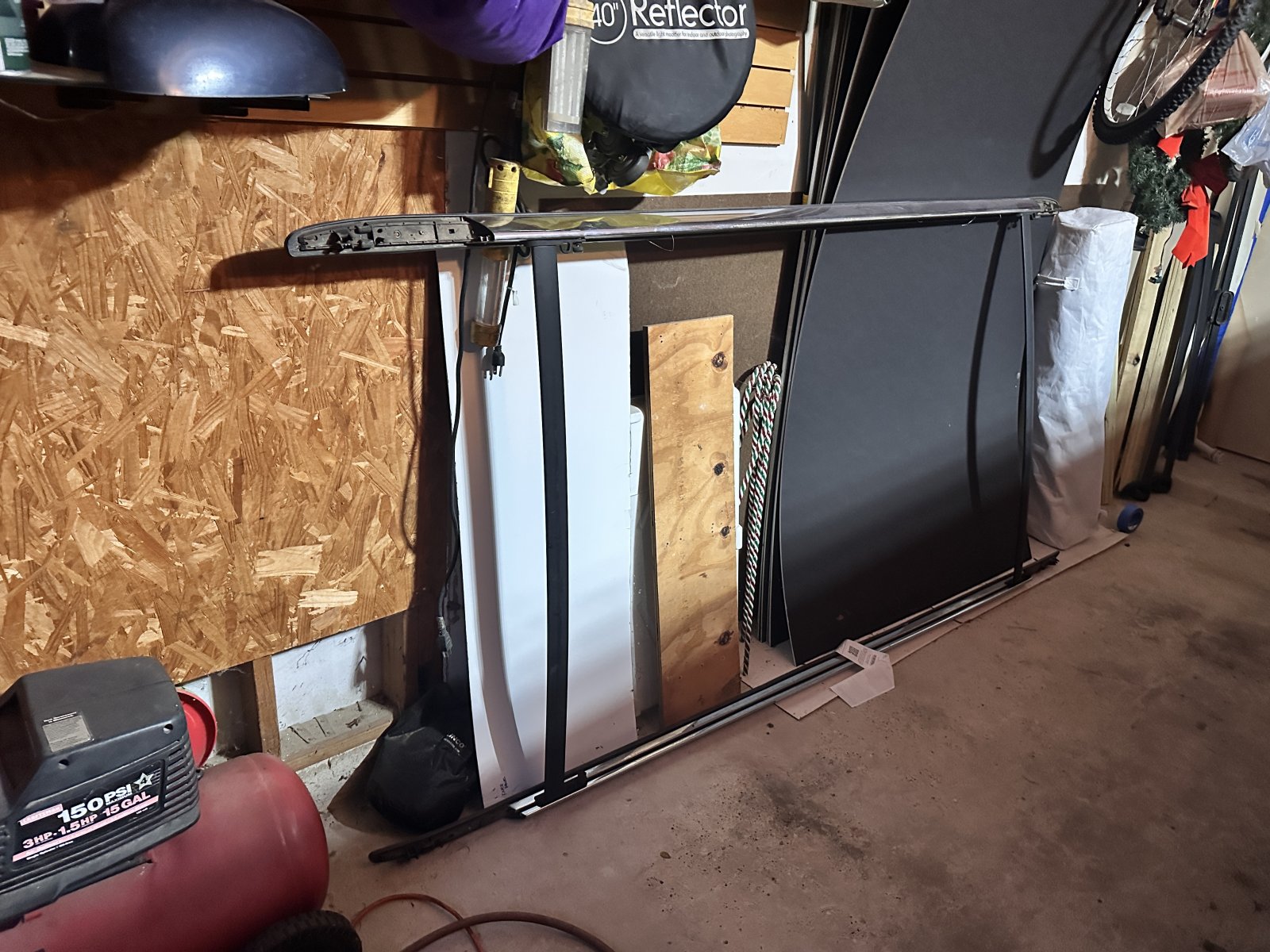

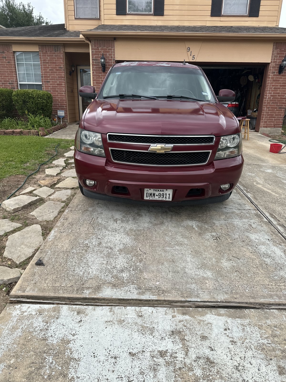

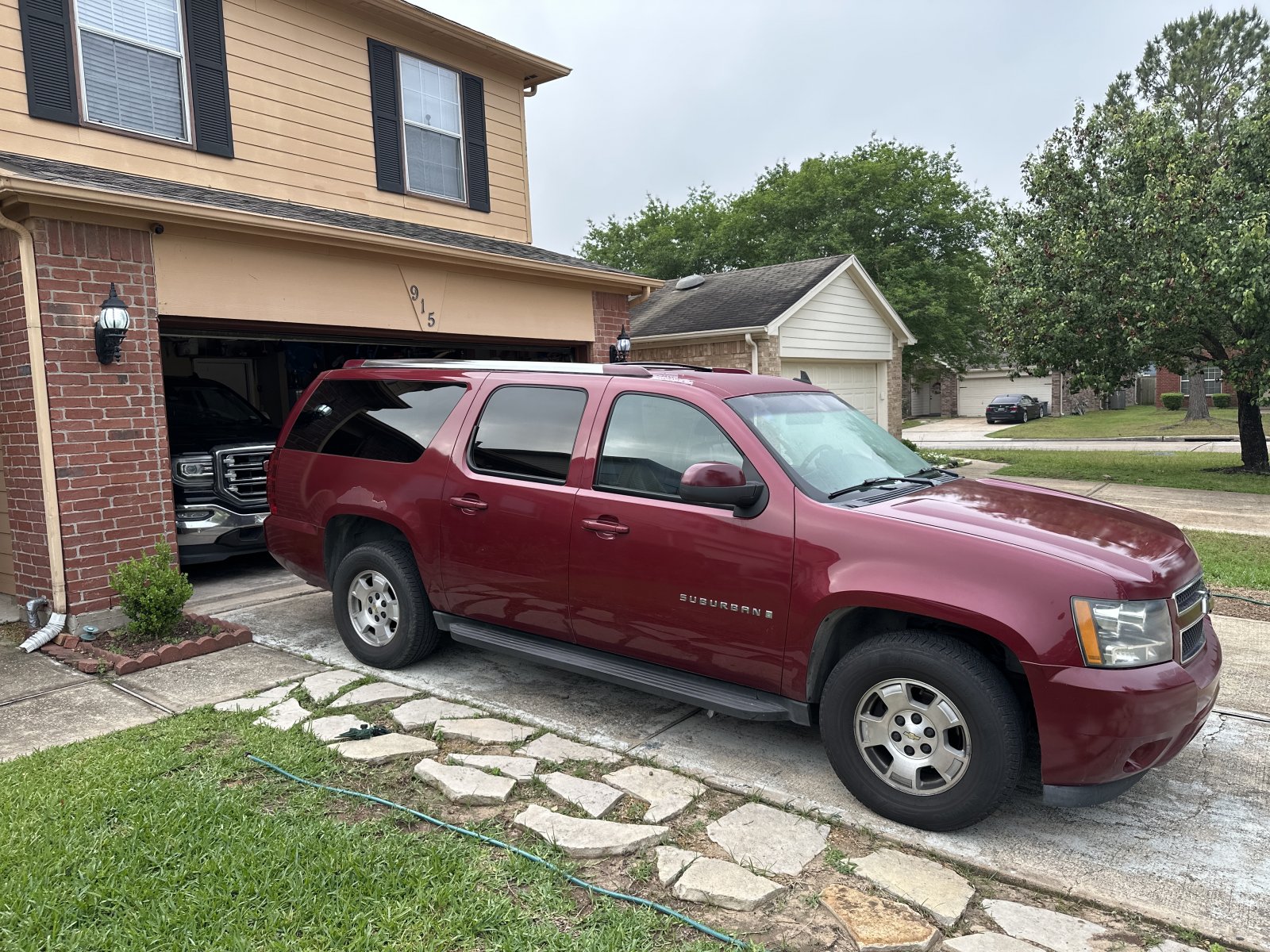

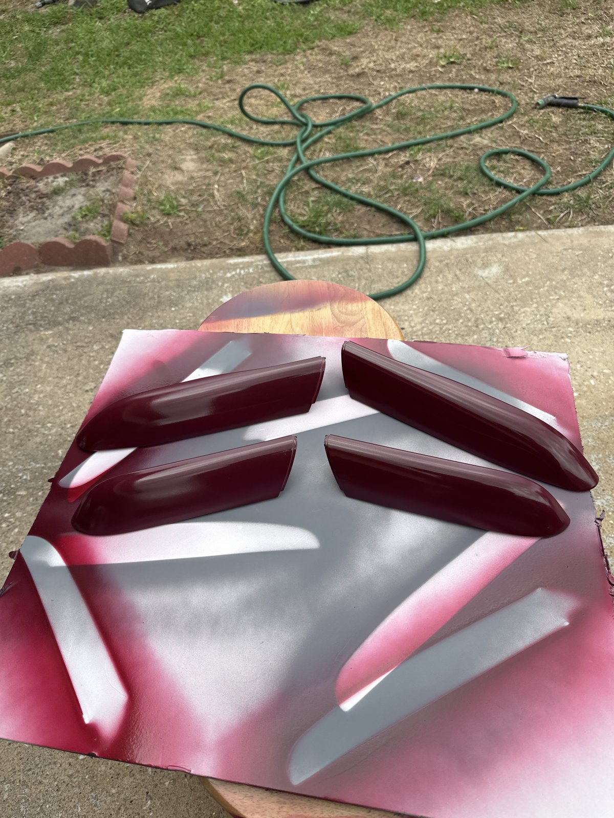

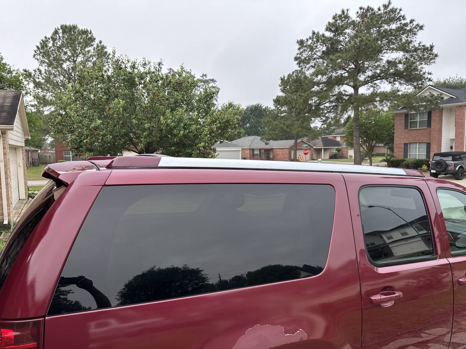

I decided to take on a few upgrades on my Suburban and wanted to share what I’m doing. I was going to do a full respray on the vehicle but prices were just too high for my budget. So I started tackling the delaminating clear coat panel by panel. I’ve already done the hood and front bumper, and now I’m working on the roof. I removed the roof rack, and found a Yukon Denali Rack and I’m adding it to the back. I also removed the bumper guards from the doors.

OBSandaNNBS
Known Thread-jacker
Sep 30, 2024
483
669
Shaving the door guards is super clean!
I also have a soft spot for the color. My 97 is a similar color and I've always liked it on the NNBS.
Please update when you add the Denali rack.

what’s your technique and products/ tools used?
Harbor Freight is my friend. Herculese orbital sander with 150 grit hook and loop sand paper, followed by 320. Nothing too crazy.

Removing the door guars was definitely the best thing for it. The passenger side door guard had already saree to release, and there was no point keeping the rest of them.

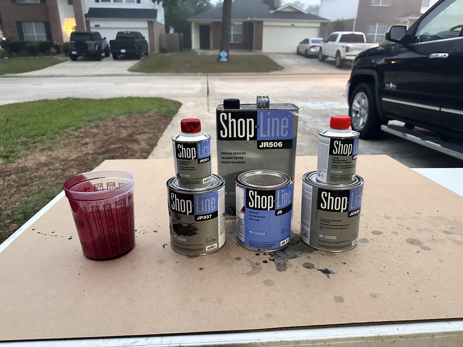

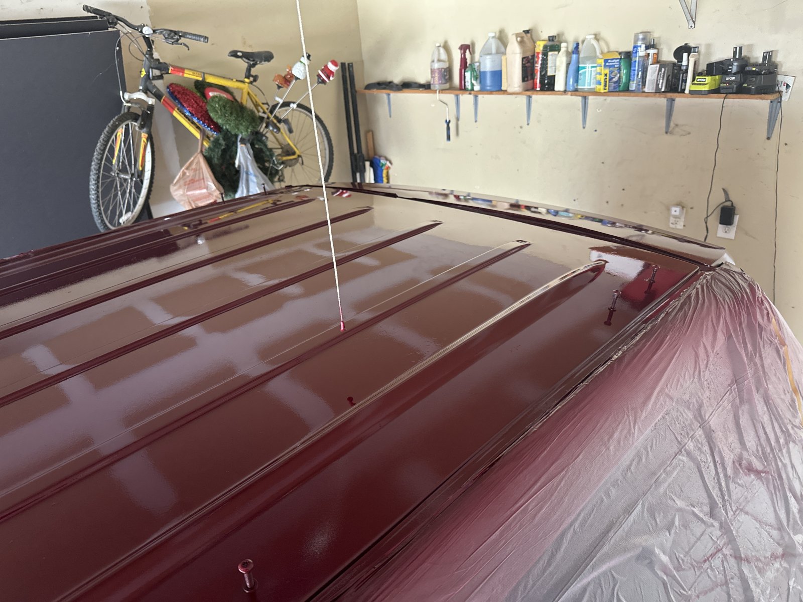

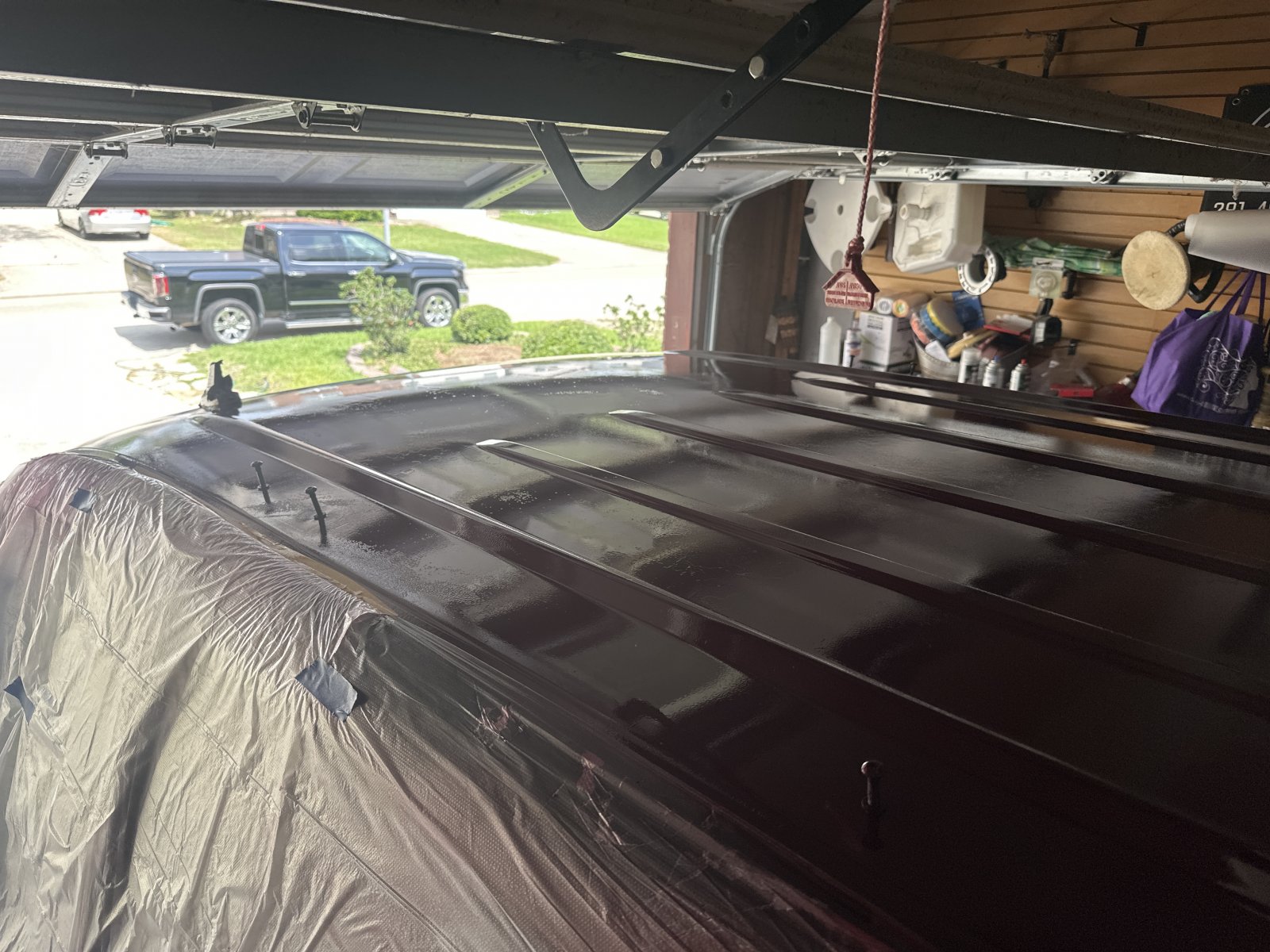

*Update*

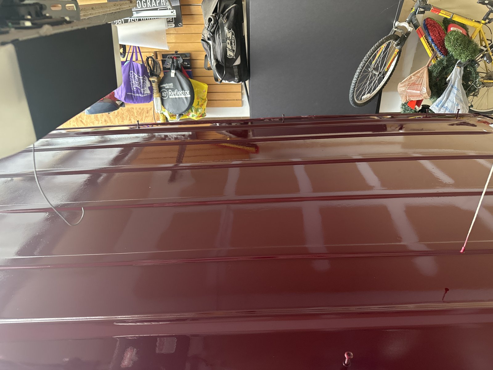

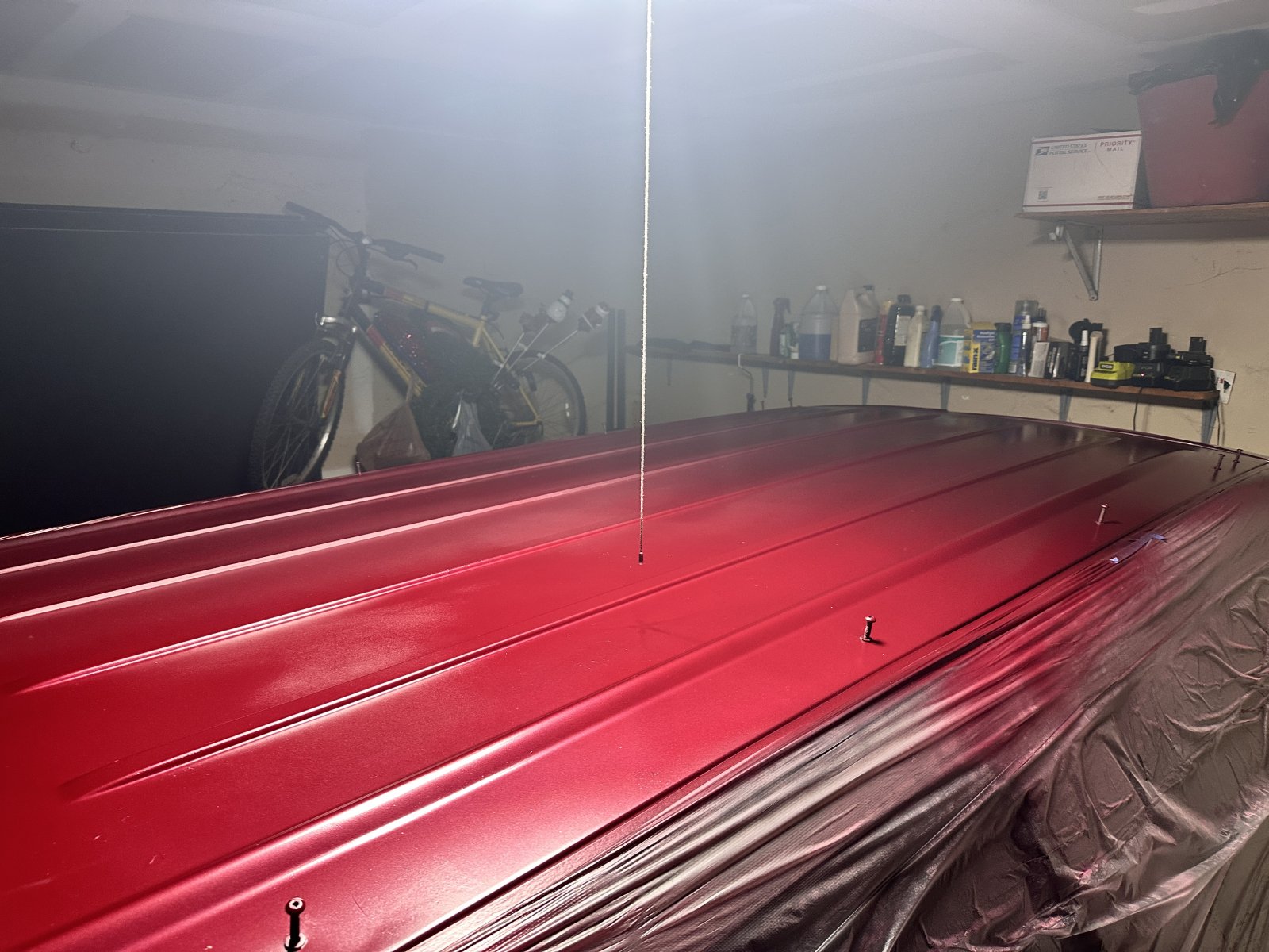

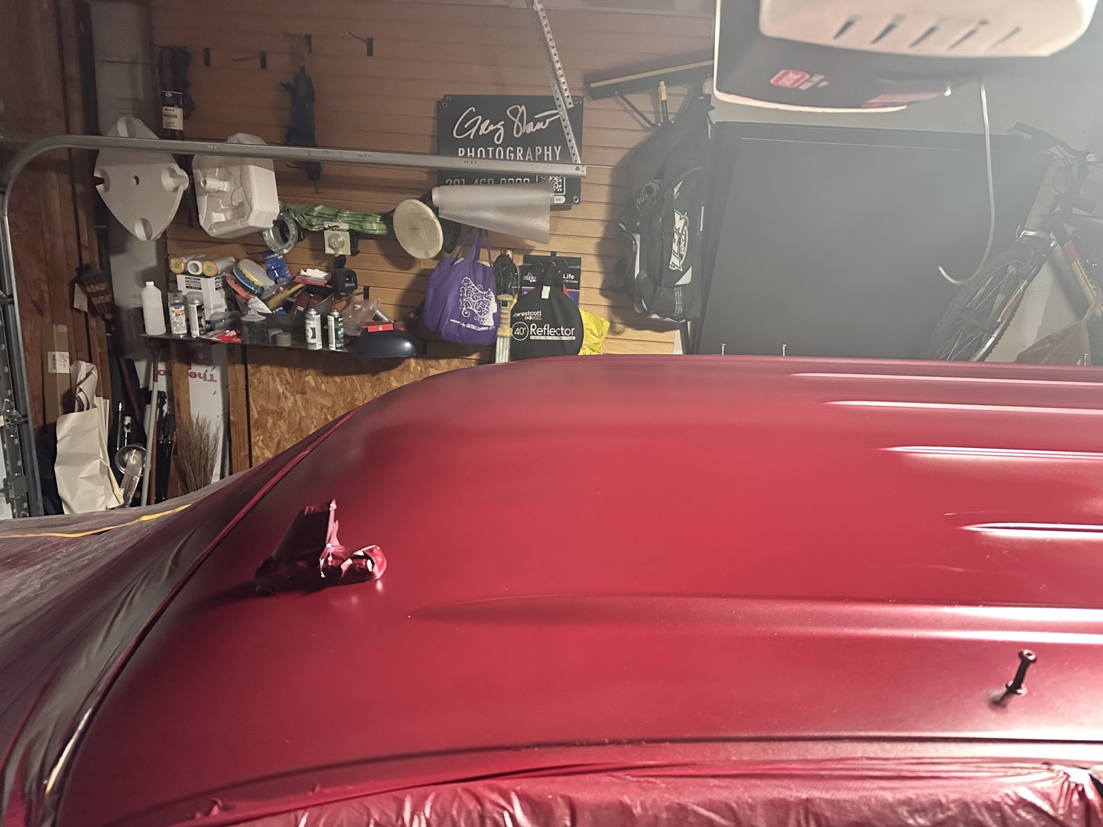

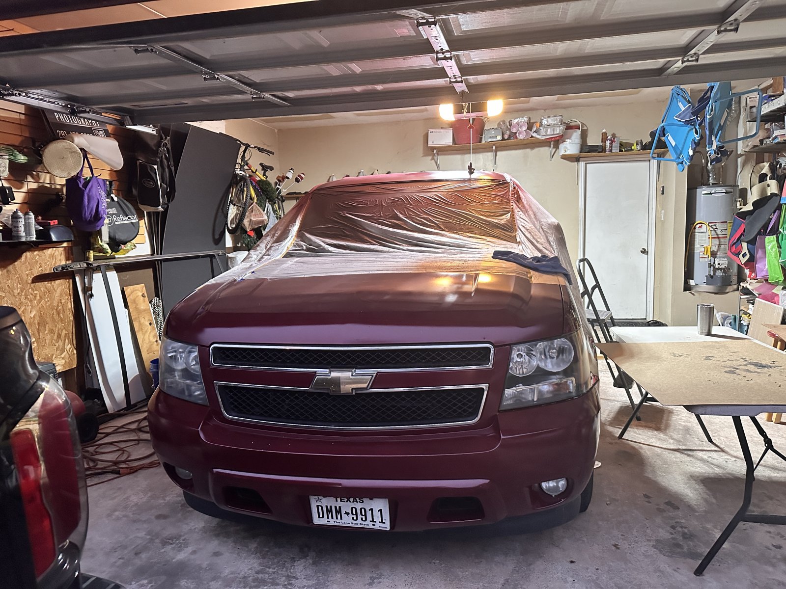

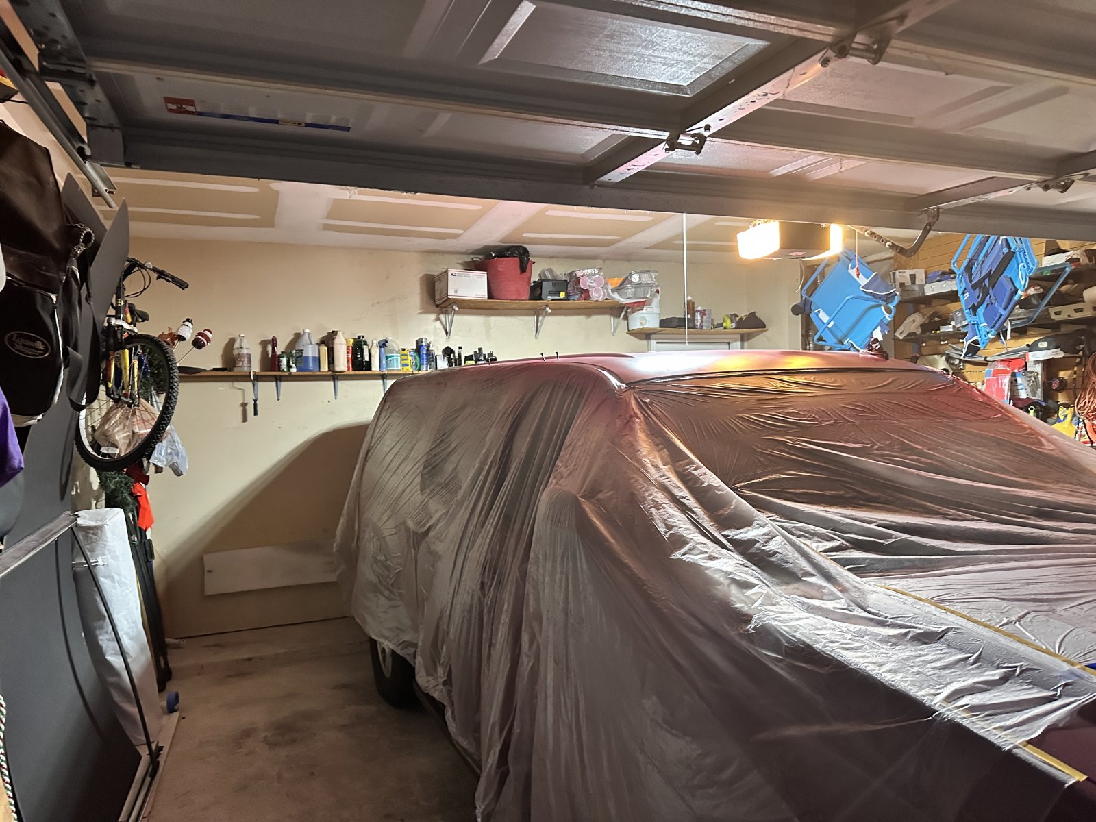

The suburban is in my garage and I have laid down a coat of black sealer, then I lay down two coats of factory, GM sport red paint code WA817K. Now I’m getting ready to catch all the little nibs that I have on the basecoat,and start with my clearcoat. I want to go ahead and try to get this finished this morning, so I can get this dried and back out of the garage. I had no idea that I can fit my suburban in my garage. After moving some things in the back, lo and behold it fits in the garage. And start with my clearcoat. I want to go ahead and try to get this finished this morning, so I can get this dried and back out of the garage. I had no idea that I can fit my suburban in my garage. After moving some things in the back, low and behold it fits in the garage.
I was going to post some pictures of the sailor on the roof, but I got so into the job that I didn’t have time to take pictures. By the time I thought about it, I had already had the base coat on. Plus, this is not a how to on painting a vehicle.

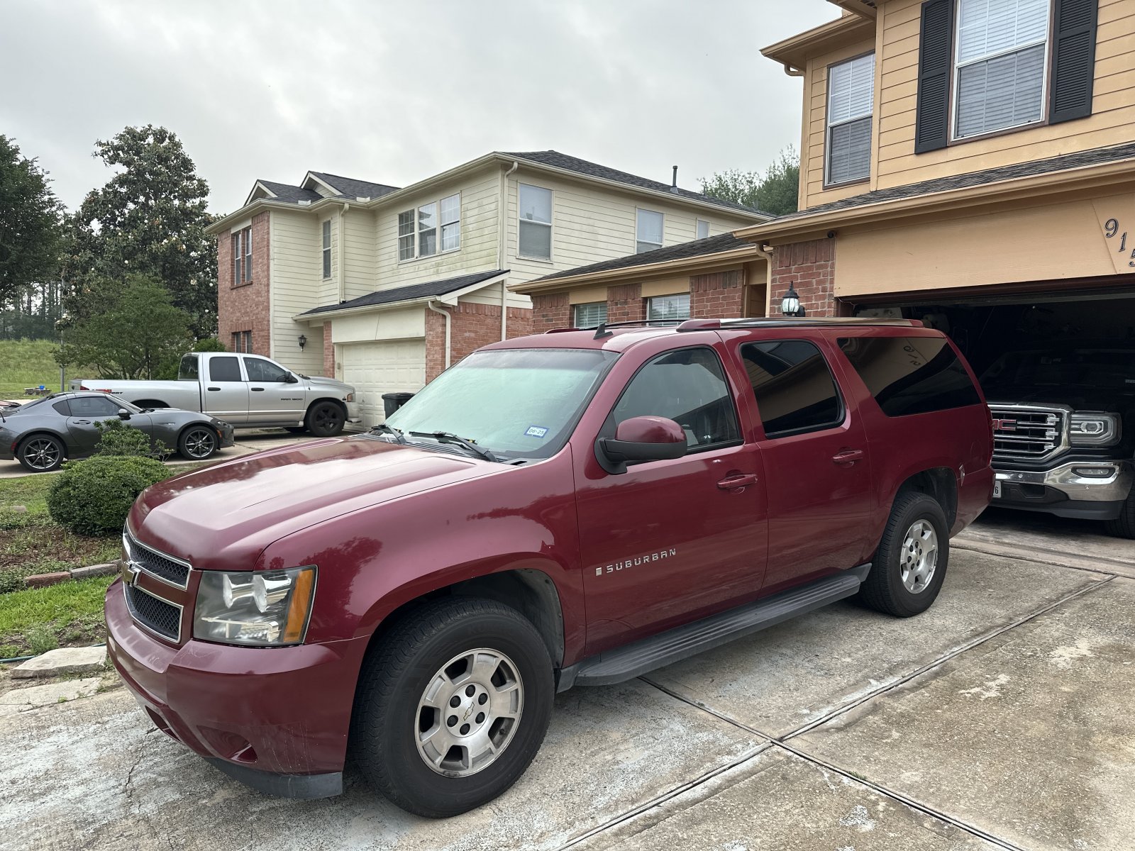

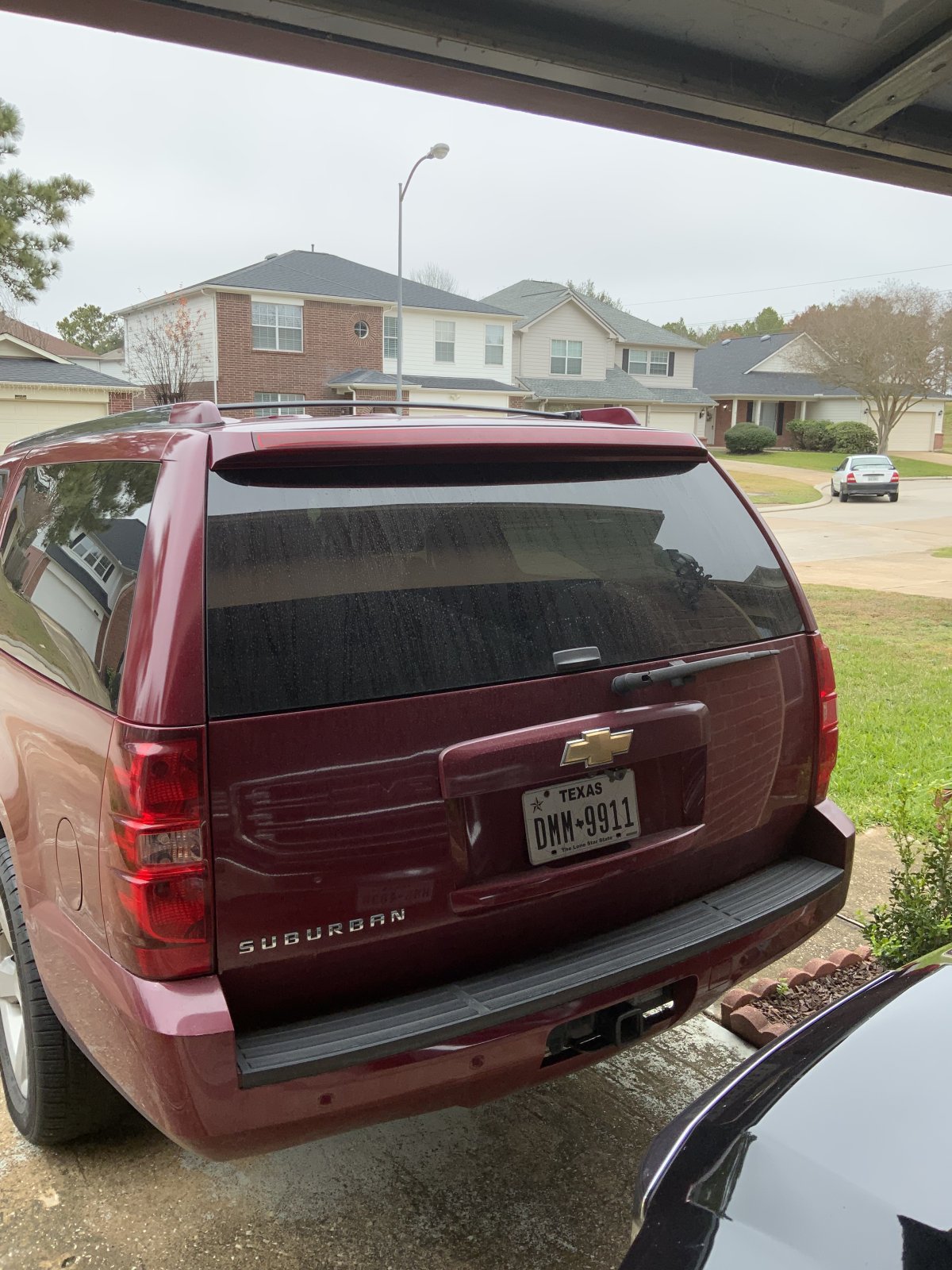

Yesterday I put the Denali roof rack on, and I really love the way it looks.
Next step is to paint the passenger rear quarter panel. I'm in the market for an Escalade ESV rear bumper cover with dual tips. I haven't found one yet.

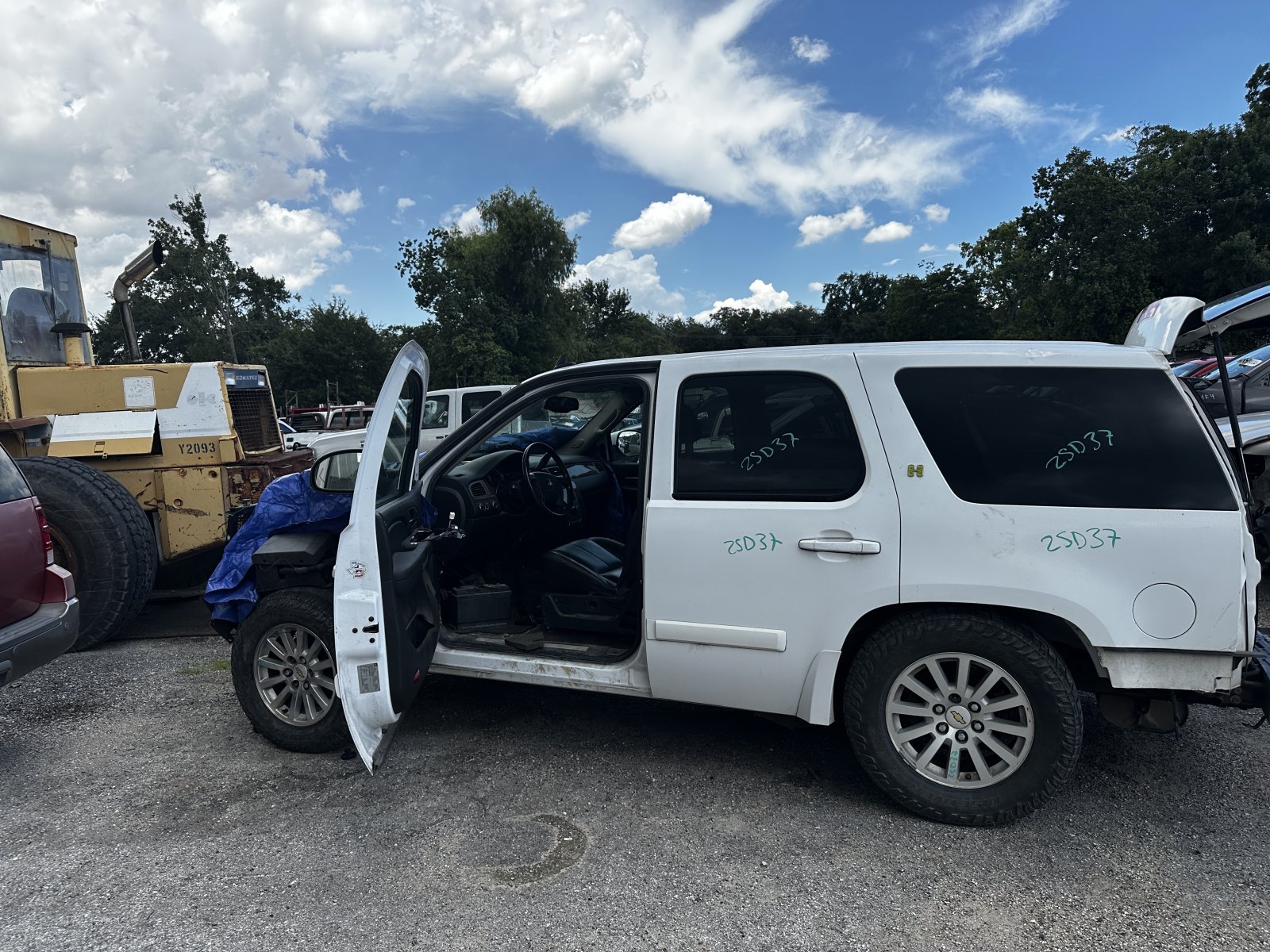

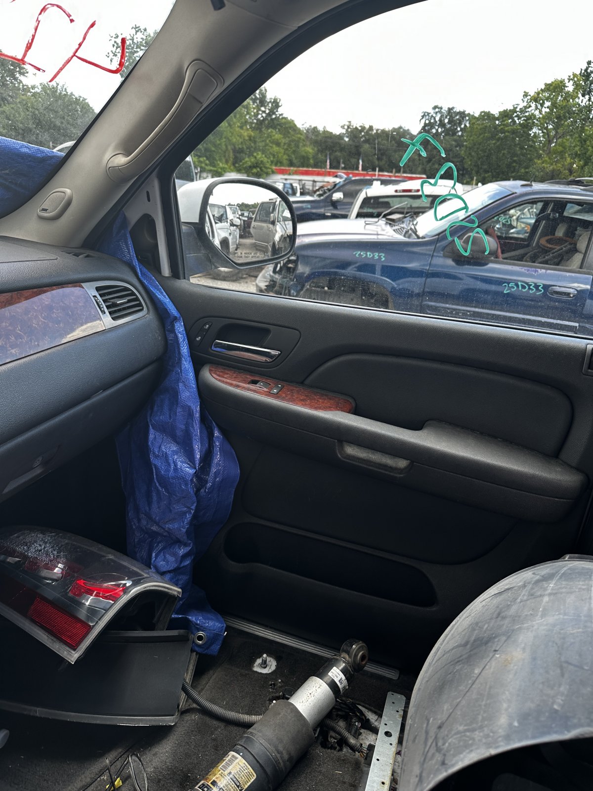

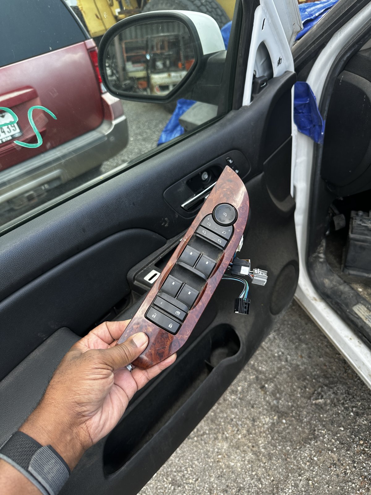

Just to update my journey with my Suburban. Some of these updates will spread across a few different categories. One of the updates was to add DL3 mirrors. After reading a bunch of threads and realizing what I needed. I found some DL3 mirrors out of an Avalanche, but I was missing the drivers control switch. I put them in anyway. I’ve had them in for about a month. Yesterday I went to an area in Houston where there are a lot of parts yards. I decided to choose one without knowing what I was going to find. I Found an Tahoe Hybrid that had both mirrors and both switches. I had to get them. I decided to test them in the parking lot before purchasing. Since I had DL3 mirrors already installed, I connected the master switch. Everything worked, but the mirrors didnt fold. I could hear the motors, but the mirrors didnt fold. So I am guessing the gears are stripped in the motor.. I then took the mirrors from the Tahoe Hybrid and connected them. They too would not fold. I decided to get them because these had the solid arrow signals instead of the dotted arrows on my first set. So next step is to do a bit of surgery and replace the folding motors. I found them on Amazon for about $34 each. Stay tuned for that.

A little bit of succession replacing the mirrors with DL3's. I also stumbled upon some useful information that will help future owners wanting to upgrade to power folding mirrors. The mirrors I got were busted. Both motors turned, but didn't fold the mirrors. I installed the two motors I got from Amazon
https://m.media-amazon.com/images/I/61m7NaJZCkL._SL1500_.jpg
Now everything's folds as it should. So you do need. to have both switches and the mirrors. My Suburban is a 2007, first year of the GMT900, and even thought the mirrors fold when I hit the switch, I don't have the ability to fold on lock by holding the lock button on the remote a few seconds longer like on my 2016 Sierra. I am not sure if this feature was added to later Tahoes & Suburbans. No extra options were added to the driver information controls. I am wondering if this was an option on later vehicles. If anyone have any ideas, Please chime in. Also aftermarket power mirrors will work, you dont have to look for DL3 mirrors. You only need to have the switches. I confirmed this by plugging my aftermarket mirrors in, and they folded as well when I hit the switch.
