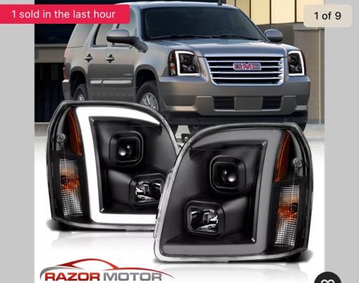

With headlights, that’s tricky. All aftermarket still use the same bulb so that’s a wash. Until recently no Yukon lights looked decent until these showed up with a decent led daytime running light.
They look great but the projection headlights still use oem style bulbs. I even ran the Sylvania Silverstar bulbs and they were marginally better. The DRL don’t come during the day unless you turn on your running lights.
These are a really good candidate for an HID conversion. The projectors are good enough to handle the output and the air shocks in back will keep the phat *** of the truck from blinding oncoming traffic with a load. I won’t recommend LED bulbs (on a stick). Their technology doesn’t let them get 100% of the light on the road.
Start by reading about how to remove the front bumper cover on a Yukon for starters. 15-30 to do it the 1st time. 5-10 afterwards. Yes, it’s horrible to replace headlights without removing it and I guarantee you’ll break a retainer clip on the harness if you short cut things.
