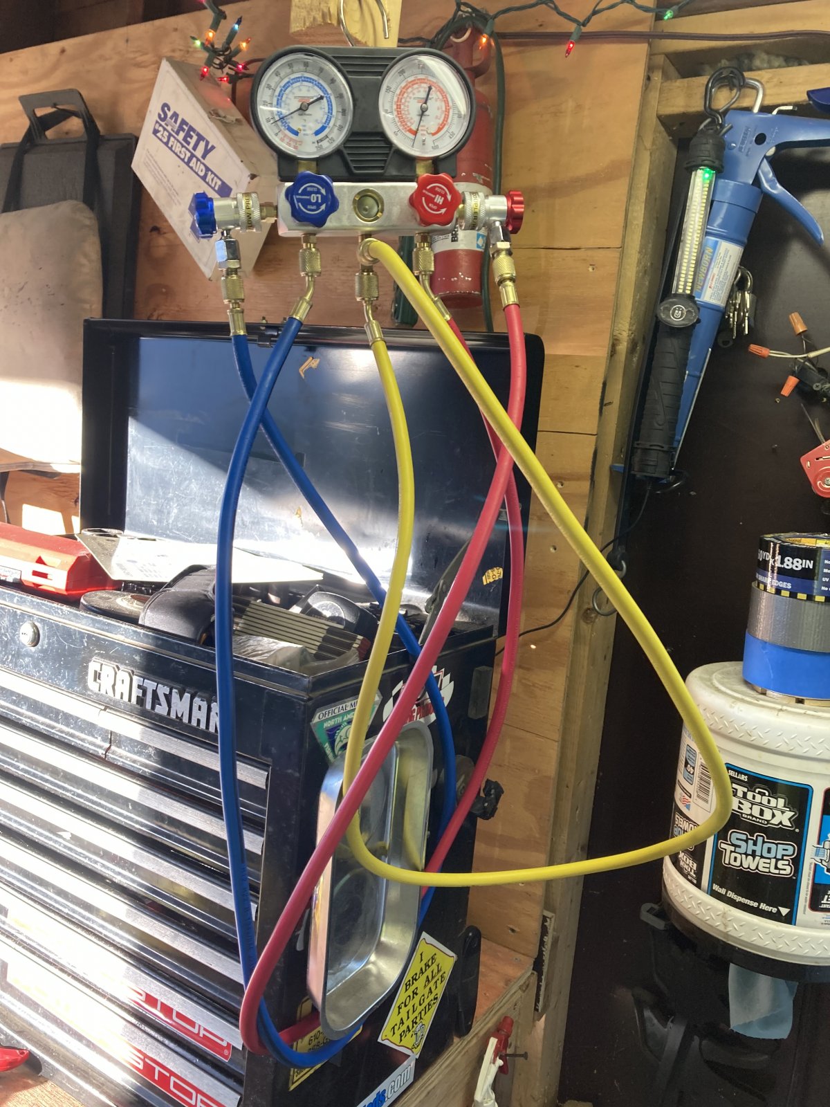

With a set of manifolds and a vacuum pump from Harbor Freight, you can do this repair yourself. Also had to buy an adapter to better puncture the cans to add refrigerant from Amazon or O'Reilly Auto.

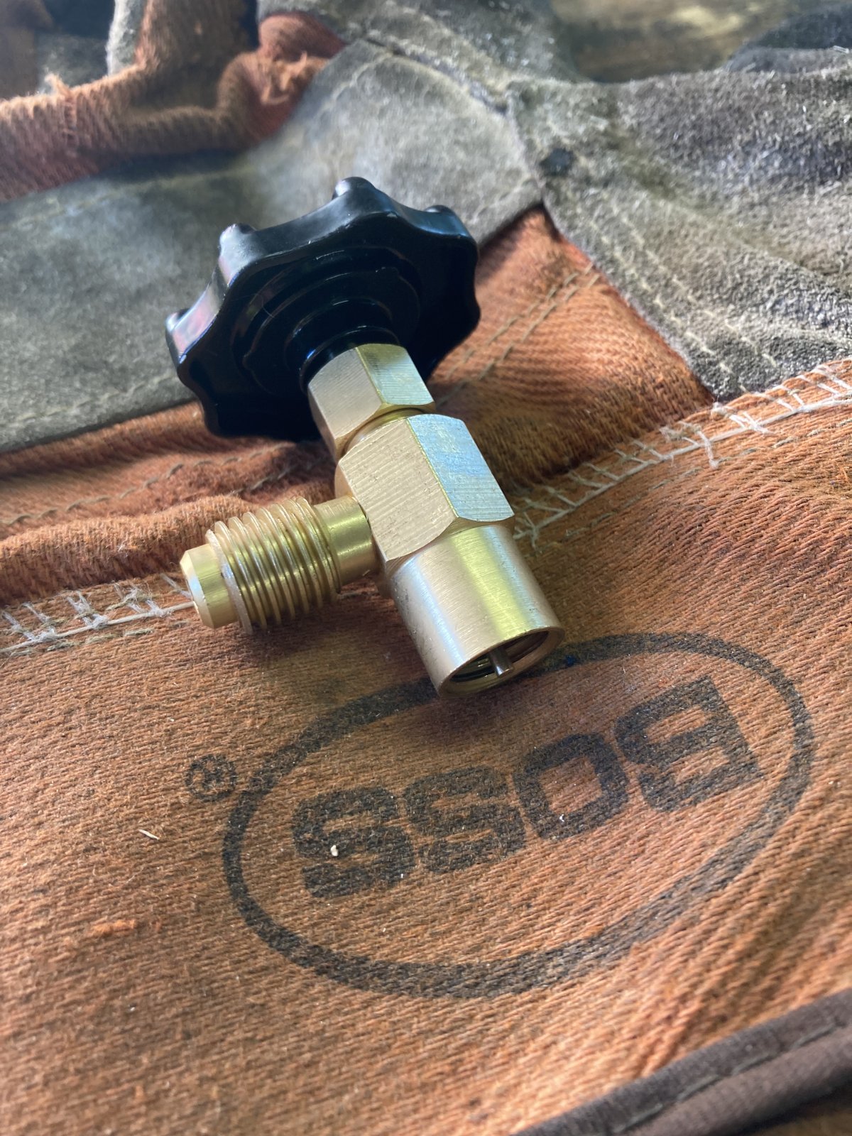

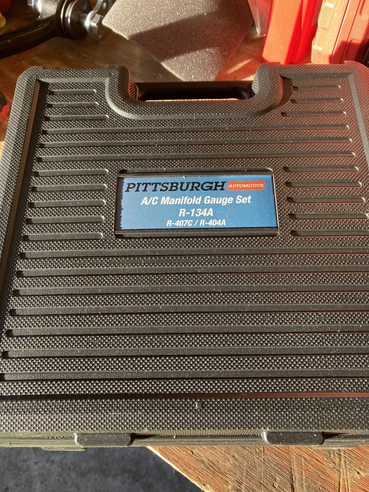

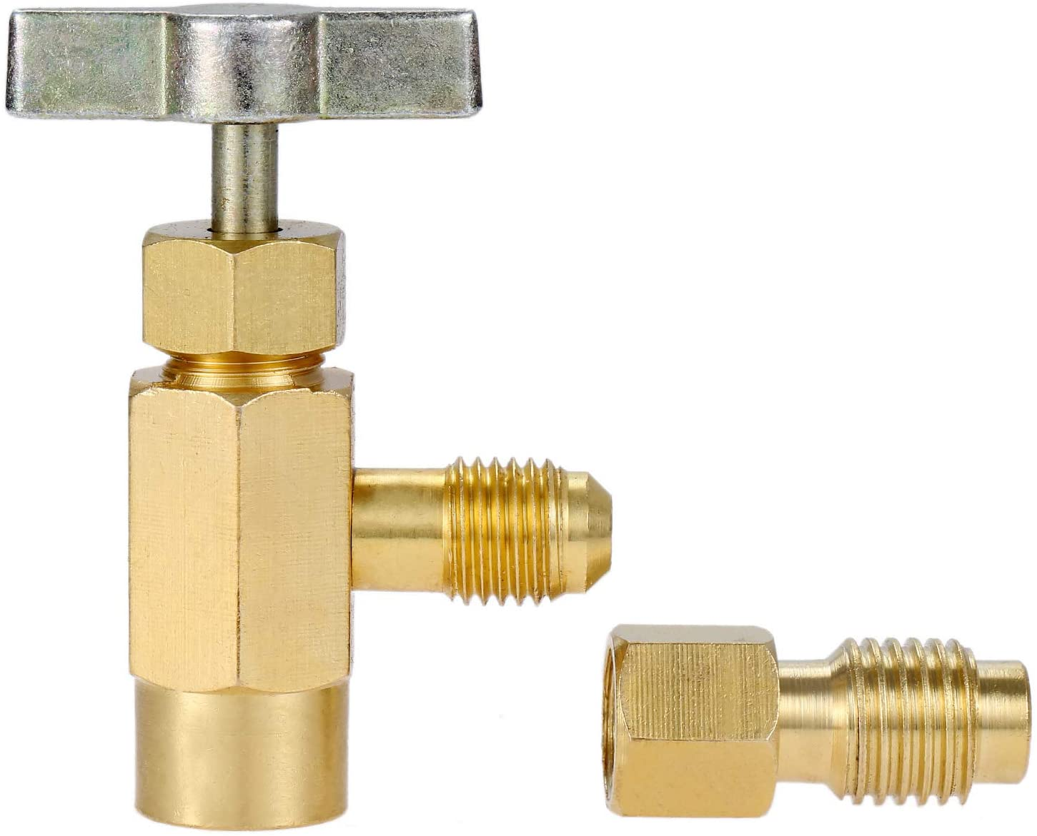

I just bought a set of their gauges and I am having issues with the adaptor I bought and what seems to be a resealable can of refrigerant. Works like crap. Not sure if I got the wrong adaptor or what. The gauge kit is nice, got it on clearance.
That's the one I bought above, even then we've had several dud cans and were able to return them for exchange at O'Reilly's.

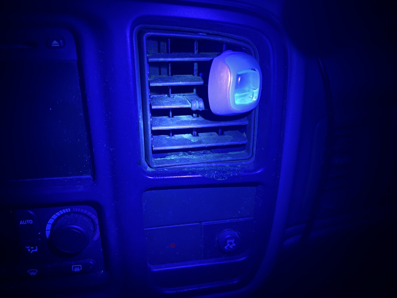

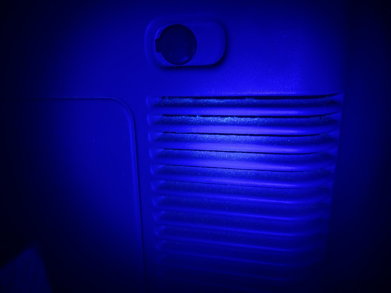

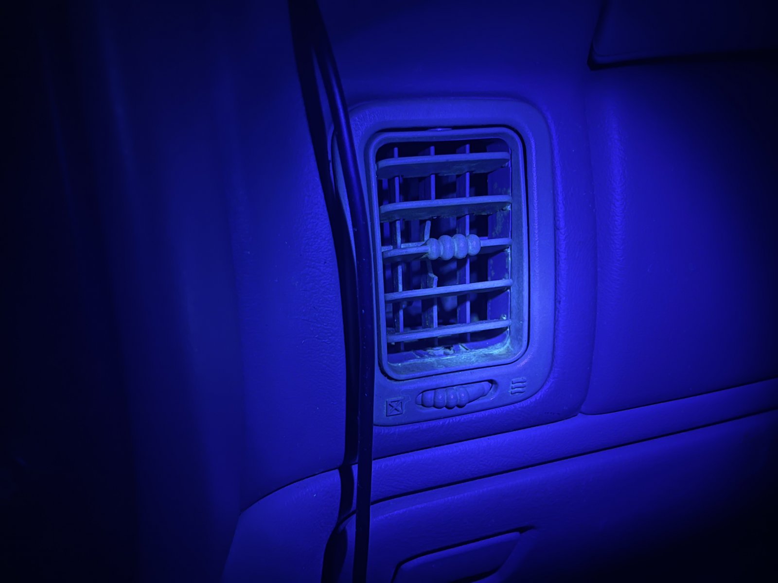

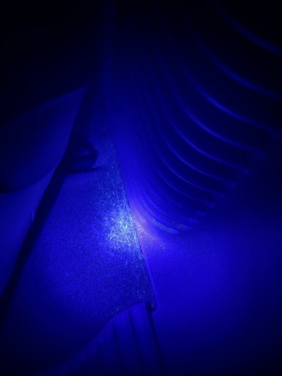

I have both cores leaking and am looking at $2K plus to replace both. Am going to do the heater core while they’re in there so won’t have to go back in there for the rest of the trucks life (fingers crossed). It’s an 06 with 200k miles.
The dye is all over my front vents and in the rear, it’s is all over the slits in the rear panel on the right. Go out at night with a UV light and looks like predator got killed in there.

Dye in Front vents and the rear panel as well as carpet at the bottom of the panel.
