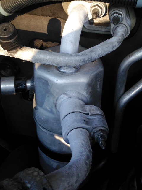

Just had the compressor changed. Does anyone know if this much frost is normal on the accumulator?

I don't know but it looks like it is working good to me, must be nice and frosty inside?

Best to take it back to the shop and make sure they notate the discharge and suction side pressures on your ppwk. It will be your fault if something isn’t corrected now or documented there were issues. Buy a cheap digital thermometer to stick in the dash vents to cya too

Condensation is normal
Ice is not
The system, when operating properly, should stay above the freeze point of water. Else your evaporator will freeze over during use

You may have climate control issues. Your accumulator may freeze lightly if the blower is not on high. Fix your climate control and the test your a/c.

Press your shop on this. If they changed the comp and it’s still not working, take it back until it’s fixed. If they can’t fix it then you should not pay to have them swap new parts in that we’re not needed.
Work with them, but be persistent, the goal is to get the a/c working. They may have to eat the rest of the cost to fix the rest of it. If they won’t or can’t fix it call your credit card company and request a chargeback for failure to perform services paid for.
Accumulators can be/become clogged.
It is basically a particle filter. When the accumulators are not wrapped in rubber or foam, condensate and contaminants can clog the flow of cold air.
Those contaminants mixed with water make hydrochloric acids, and create internal corrosion. The blockages stop/slow the cooling process.
A tell tale sign is :
1) No cold air
2) Significant reduction in cold air
