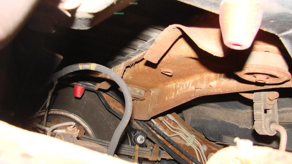

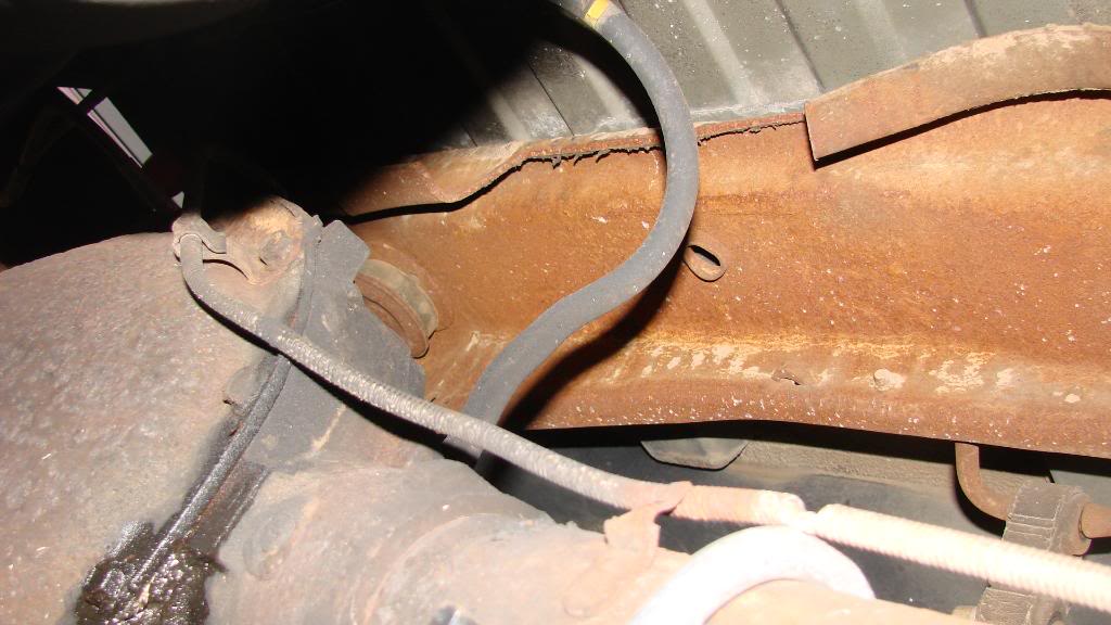

When you put your flip in you are supposed clearance a few spots so it does not hit when your suspension cycles.
Did you do that?
The crossmember above the rear needs to be clearanced and the crossmember in the center of the body needs to be cut.
These are some pics I took when I did my drop.

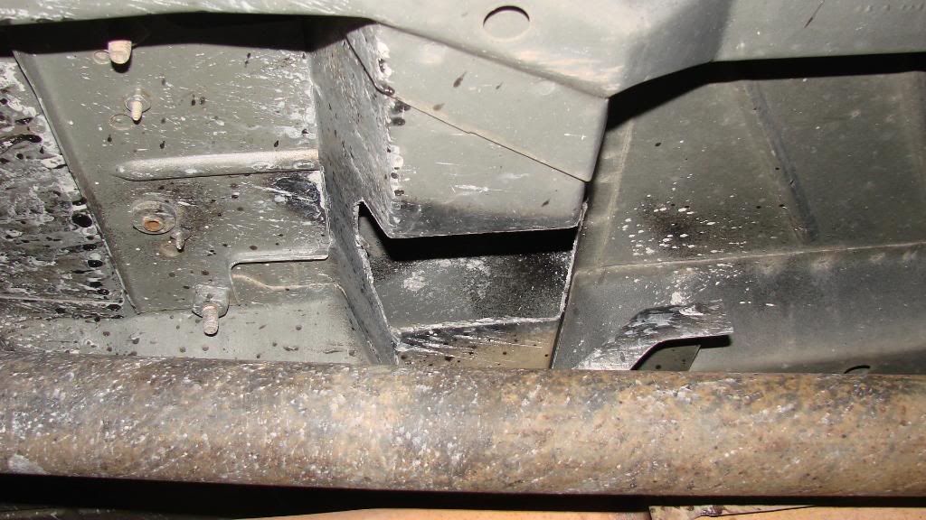

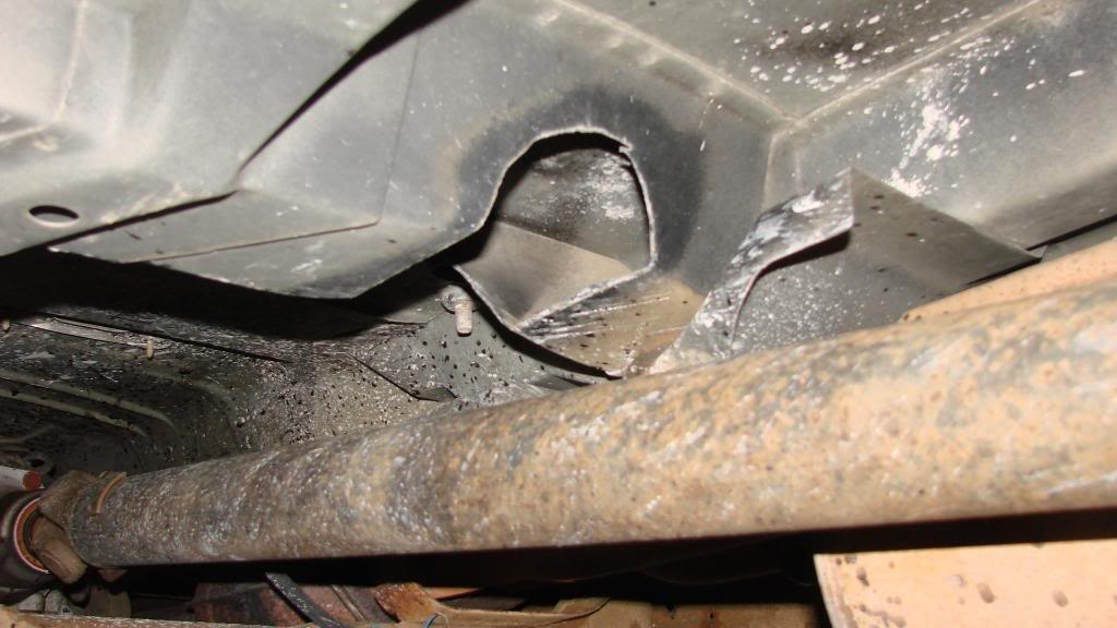

This is what i did tonight.
should never hit now, ive heard of people bending drive shafts with this lowering kit.. better safe then sorry

You must have a 4 door. Looks a little different than mine. I'm going to have to get under mine to get a shot like that, looks cool.

Yea a few different crossmembers in the way. i rubbed the driveshaft once and said thats enough time to notch. i was just test driving the truck too... I need to figure out a pinion angle still. im at 2* at the pinion but not sure if i should go mroe or less.
