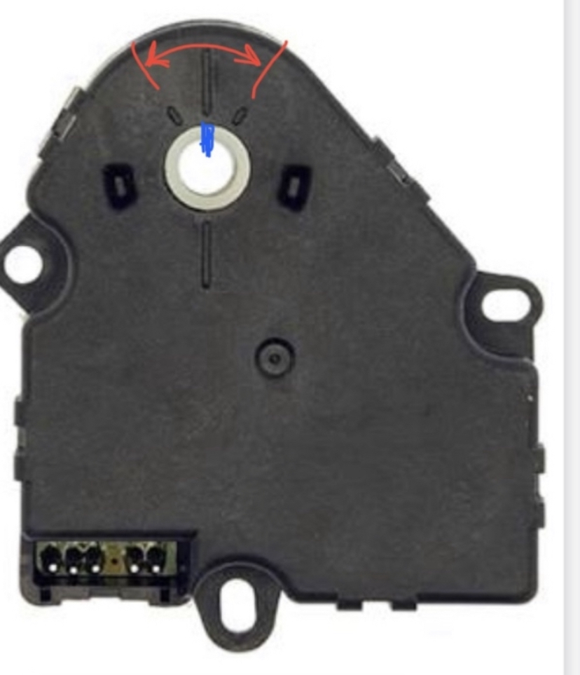

The front heat actuator is behind the ashtray and has a notched dial on it. You’d want to see if it has equal travel from cold to midpoint and midpoint to hot when adjusting the dial.

If it didn’t come with rear heat, the panel may not be sending a signal to the actuator. There would be three wires to its connector - ground, battery and signal voltage. The signal voltage should vary as the temperature dial is turned but I don’t recall the range. Maybe 1 to 5V or 1 to 12V. So if the actuator’s dial doesn’t rotate, that’s the next thing to check.

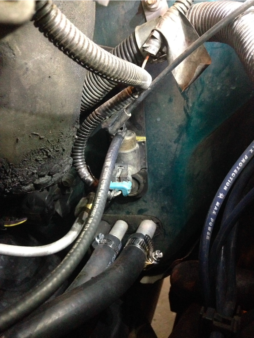

Another thing to check is the water valve on the heater hoses. It closes when the temp dial is on “Max” and, via a solenoid, shuts off coolant to the heater core to maximize a/c performance. I had a dorman a/c panel several years ago that sent a constant signal to that solenoid and kept the valve closed regardless of dial setting. Then it started smoking so I yanked it out pretty fast.
Piece of junk, lol.
Unplug the wire connector to the solenoid for a quick check. It’s above the heater hoses with one vacuum line to the PCV fitting and a second to the water valve. If you’re getting 12V on the connector regardless of panel temperature setting, then the panel is probably bad.
The valve has a metal rod and plunger on the end. If it pushes up and down easily then the valve is open. In the up position the valve is closed.

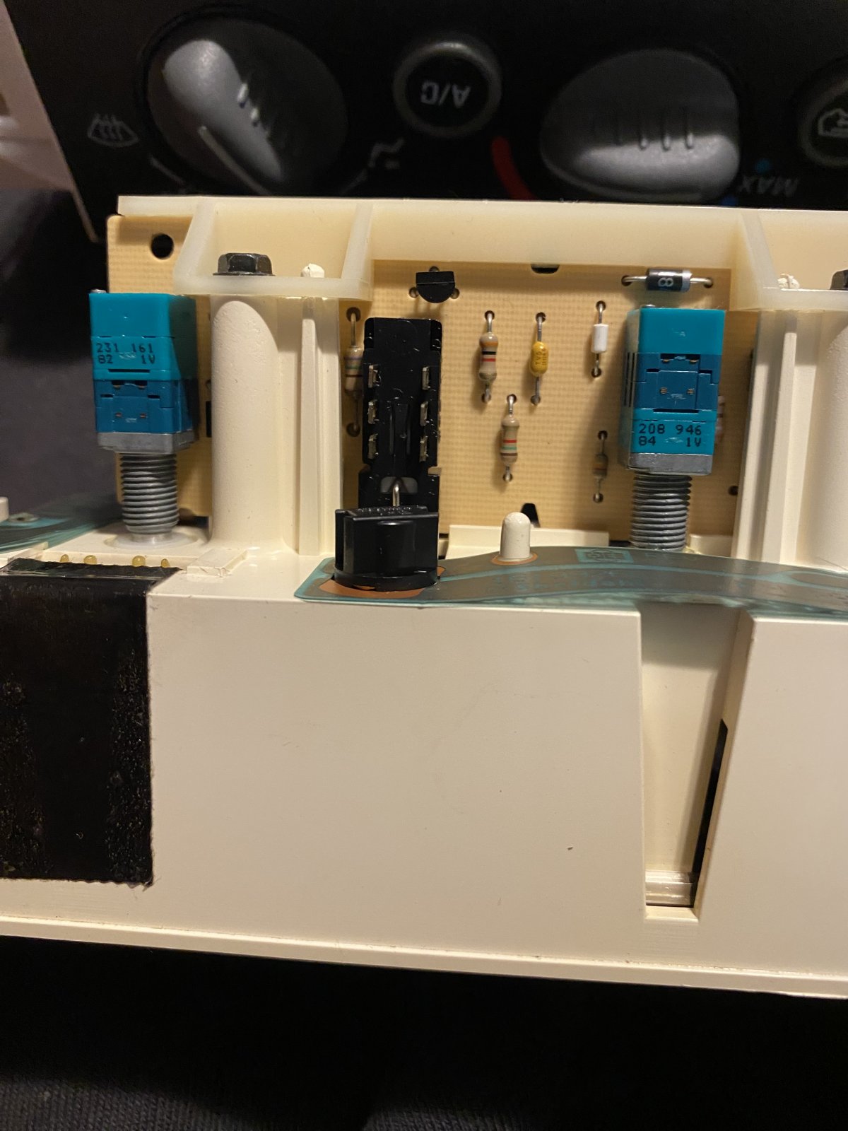

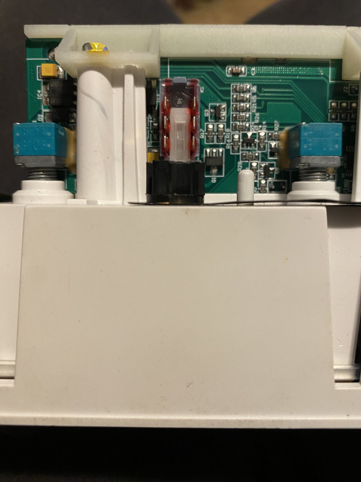

I replaced the AC/heat control switch 2 x with aftermarket’s and both times the heat wouldn’t get hot. Cleaned the old OG OEM switch and heat works again but the blower switch cuts out. No problem with this with aftermarket’s function other than cool heat air. It’s a difference if I blend it to cold but not hot like when the OG is installed. Stumped I am…

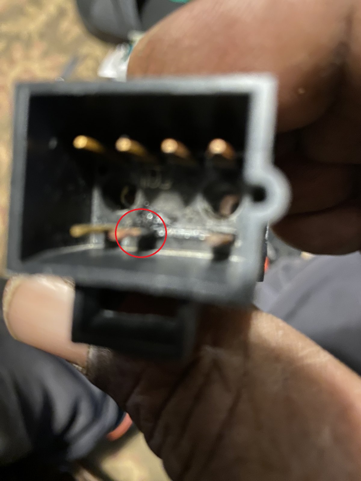

I’m pretty sure I’ve confirmed the blower switch as the issue. I took it apart to switch with the good unit that didn’t get heat hot. My connection is worn (meltage), but the knob internals don’t work together. Even the guts on the aftermarket look puny. I’m gonna need an OEM I suppose although there might be a chance I got 2 bad aftermarket ones. Once I cleaned the connection up it’s working properly again for now.
