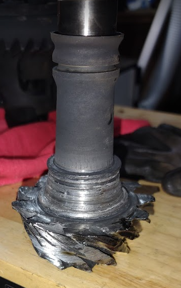

Found the issue :(

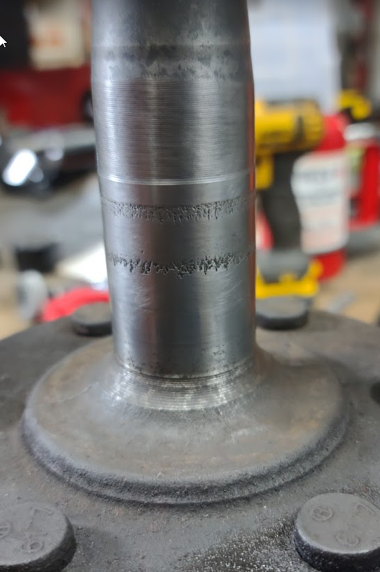

Next question. What you the thoughts on this axle shaft??
The bearing for sure will get replaced

Yikes. Does the axle shaft have deep scoring you can catch with your fingernail? Maybe a polish with fine scotchbrite is all that's needed.
A dial indicator and a needle-type torque wrench that reads in-lbs to measure preload rotational force are a must.

Yeah i seen 18 in lbs rotational on the pinion, and i will set up the gear mesh per the set i ordered. i have not seen any specs for the axles rotation. The pits are rough, can't catch much with my nails so i will try polishing first. It appears that the repair bearings are greased, and sealed off from the rest of the oil in the housing.

Look at the new and old pinion and see if there are any numbers written on them about pinion depth. Usually you can just press the old bearing off and re-use the depth shim and be close enough. I'd polish that axle and see how bad it is and use a bearing with a sleeve for the axle. Pinion rotation is with lubed bearings and the collar crushed. I have a tool that bolts on the pinion yoke but I have used a large pipe wrench. You have to sneak up on it as it crushes, checking often as you tighten a little at a time.

ok i Cleaned up and Mic'd the damaged axle shaft, it is roughly .001-.002 different than the non damaged one. I believe this will be fine with the upgraded bearing i am using.

I would not trust that axle to last very long, especially with a higher load.
