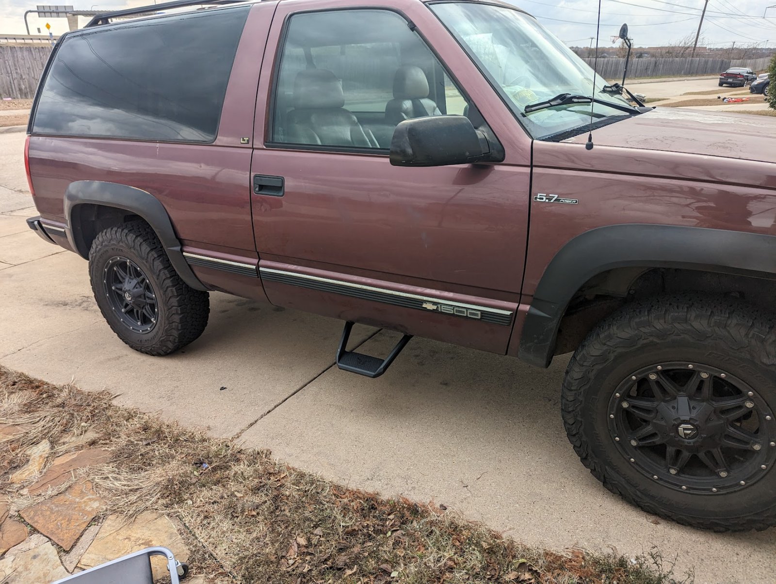

1997 Tahoe LT 2 Door
Lovingly named "Bad News"
She's a huge pain in the wallet and a work in progress but I'm hoping I can get her running for another 200k miles
