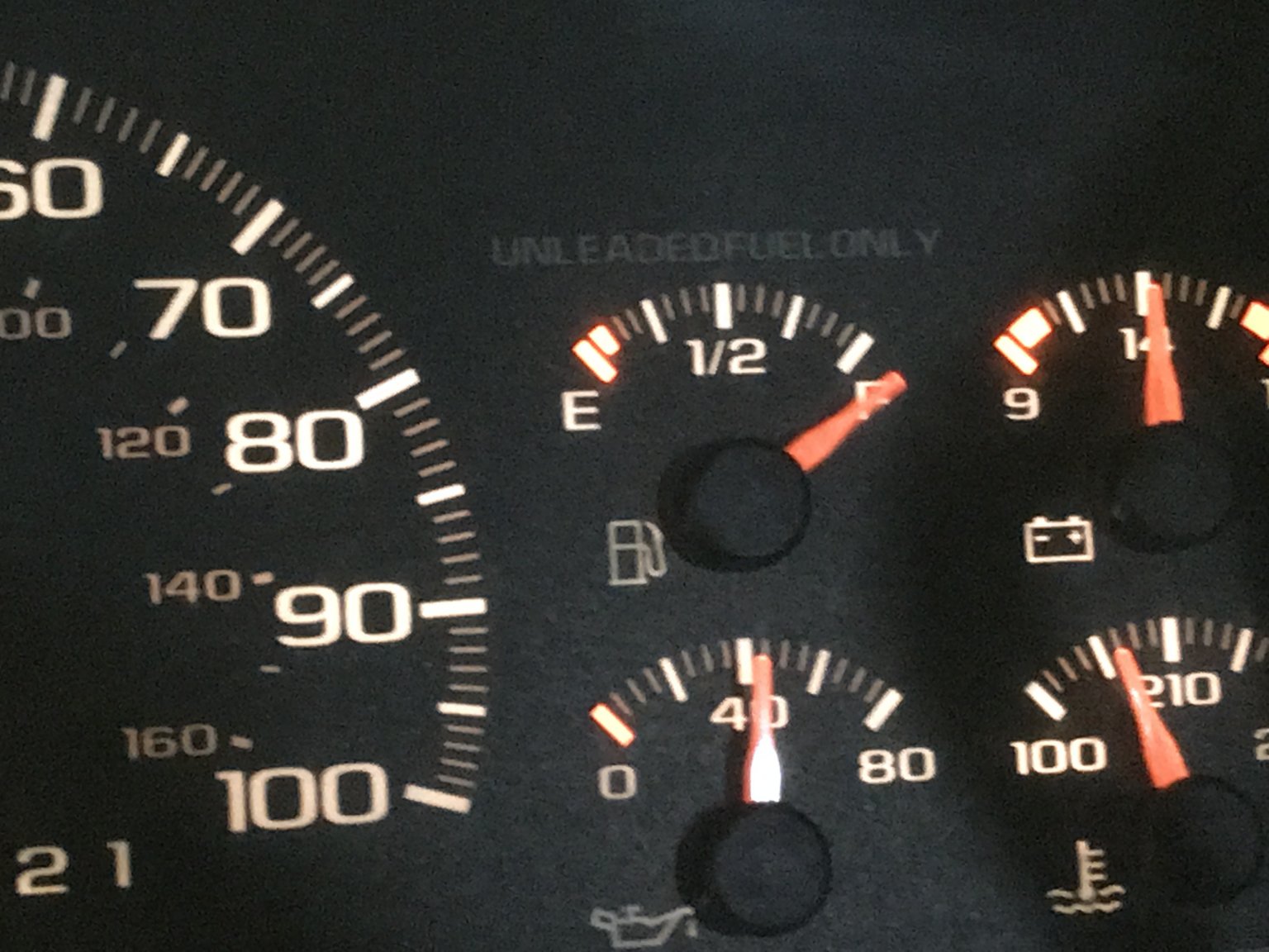

just recently I have been having an issue where my coolant gauge reads no more than about 160 deg. I replaced the 195 deg thermostat 6 months ago with a Fail Safe but I hear those often fail in the open position. Before I dig into this by draining the coolant and checking the thermostat, I did some research online and found this video that discusses the temperature sending unit and how to check it.
I checked mine with a circuit tester. My gauge did not go full hot. I am not sure if the resistance from the circuit tester light was sufficient to cause the temperature gauge needle to not swing full hot, but since it didnt, I am now thinking that the cluster might have some kind of issue. and yes the coolant sending unit is in the left side of the block.
Any thoughts on that?
The coolant temp never gets above... so not sure where to go from here exactly.

Hook it up to a scanner and check what it says the coolant temp is. It's reading temp by the coolant sensor not the sending unit for the guage. If your temp on thw scanner shows to be close to what you believe it should be running, then i'd say you have a bad temp sending unit.

I agree with mtl111.
Note, also, that the marks on the gauge are not linear like the oil pressure gauge. I'm not convinced that it was ever intended to be an accurate measuring device.
Both my 98 Tahoe and truck show gauge readings similar to your photo. Using a scanner, my ECT sensor readings are correct for the thermostat installed.
