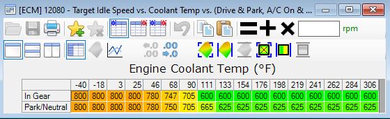

That's normal, they are designed to idle higher in colder temps it's right in the tune.

Idle params

If it's doing it with coolant warmed up, then I'd check around for vacuum leaks
