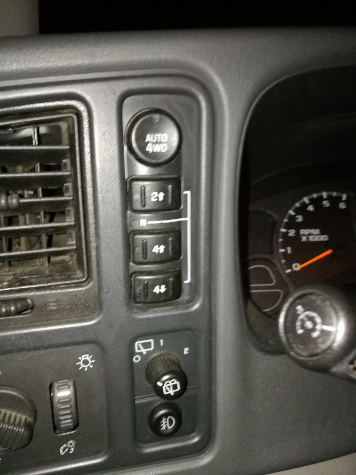

Here is mine with normal 4wd plus auto 4wd. NP8

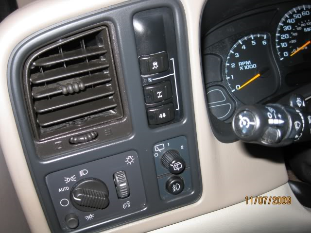

He likely has the one that looks like this. Note that there's no 2wd position
Top is traction control on/off, middle is 4hi, bottom is 4 low. I don't know if the center differential locks on this one.
Given the age of these vehicles I would think it'd be much simpler to sell your Yukon and buy a Yukon or Tahoe with the 4wd setup you want.
yes mine looks just like that the only reason I wanna swap is I have a very clean chassis an I live in new England so there not the easiest to find cheap
