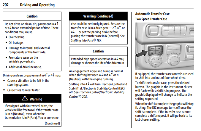

Consult your Owner's Manual for proper operation.

I suppose you CAN, but I'd only do this if it's at least raining, unless what's under my tires 'lets' me use 4WD,
'cause when it goes 4WD, it's not AWD, it's 4WD, until it goes back to RWD.
But that's me.
