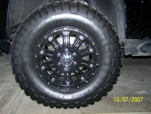

6 inch superlift suspension, running 35x12.5x18 cooper STT armortek tires on helo 835 18 inch rims. yes, i still get a slight rub turned to full stop, but only under compression (i really should crank the torsion bars or consider coil spacers to eliminate this altogether). good luck and let us know what you decide!!!

I was looking at your wheels and you dont have enough backspacing- that is the main reason why you have the rubbing issues. I had the same problem when I installed the lift, I swapped out the wheel for wheels with more backspacing and that solved the problem. You should go for about 5.5 inches of backspacing.

i ordered the 18 inch helo 835 with the 6 on 5.5 from the kirk's automotive in baton rouge... that's what's supposed to be on there (but maybe that's the bolt pattern and not the backspacing) they were supposed to know what they were doing (but they didn't), and i sure didn't at the time. when the $aving$ build up, i will have to get new rims and tires... again with the 5.5 inch backspacing... i should have come on to this site way before i ever started the lift, rims, and tires... i would of at least had a clue about what was going on, instead of figuring it out now. thanks gonzo for noticing the backspacing issue!

these are the original wheels I bought, I had to return them after I found out that I had the wrong wheels. The guys at the shop were pretty cool about it mainly cuase it was thier mistake.
