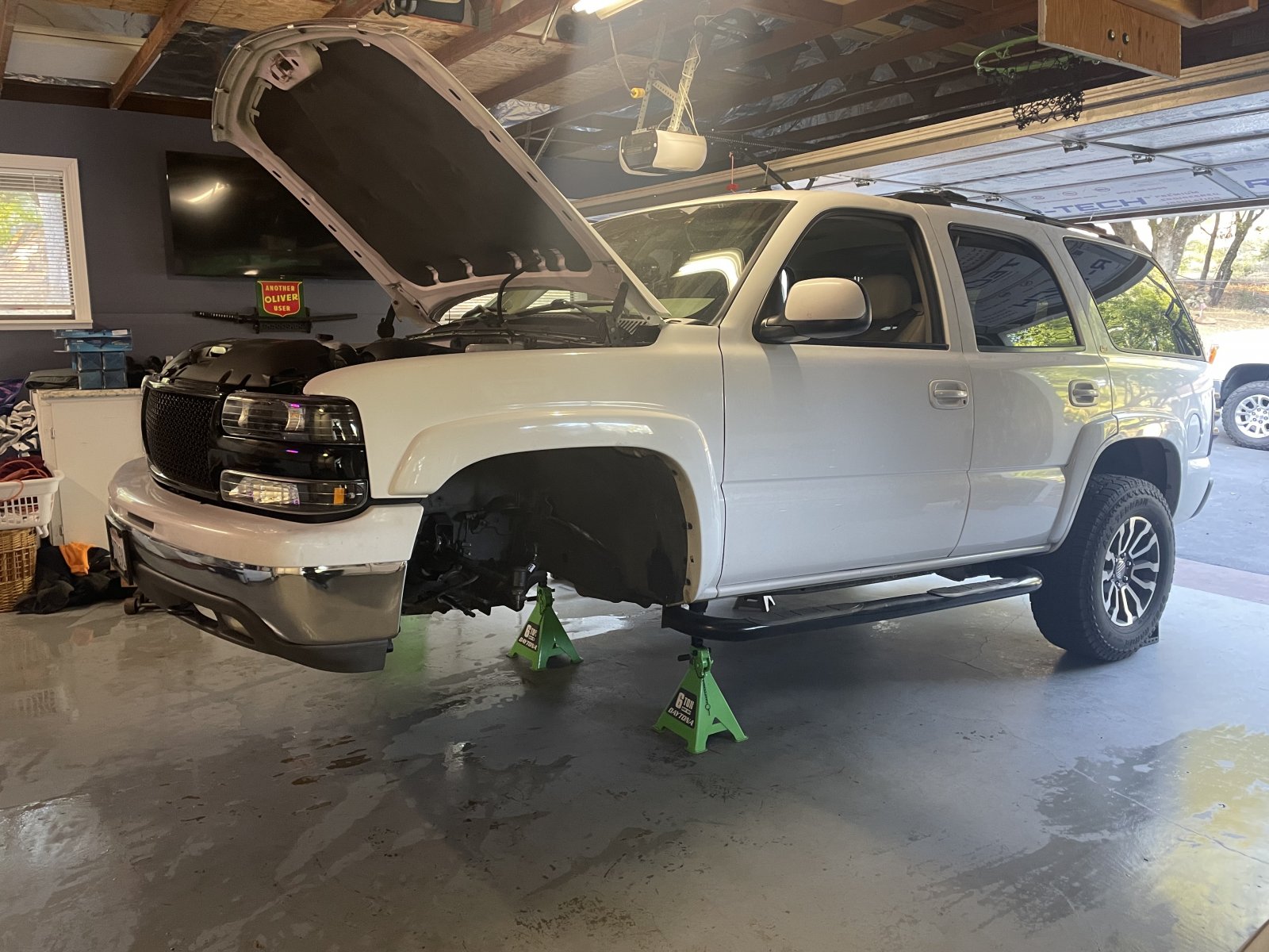

So the build is coming along nicely. Lots of hard honest work and lessons learned along the way. Exactly what I’d hoped for when I took this 4x4 project on. Thanks to this forum and other resources, I’ve had allot of support along the way. That said, I’m to the crossroads of re-gearing the rear differential. Currently running 35x12.5x20 wheels on a 6” lift. I’ve read all kinds of threads and heard the arguments from all sides and points of view. Kind of goes back to the main question, what is the purpose of the vehicle and what am I doing with it? Mostly will just be a fun rig for my son and I drive drive around town, run up to the lake etc. I may pull a small trailer or boat now and again. We live in the hills of Northern California, so not flat land by any means.
So the question is, what gears? Right now running stock G80 3.73’s. And honestly, it doesn’t lag all that bad. Not as much as I thought it would. Now I’m leaning towards 4:56 gears because I’d like to drive it down to work now and again, freeway miles about 50 each way. Maybe an occasional hunt trip down in the valley. I’ve heard some say go 4:88 while others say that is overkill.
Welcoming your thoughts and much appreciated!!

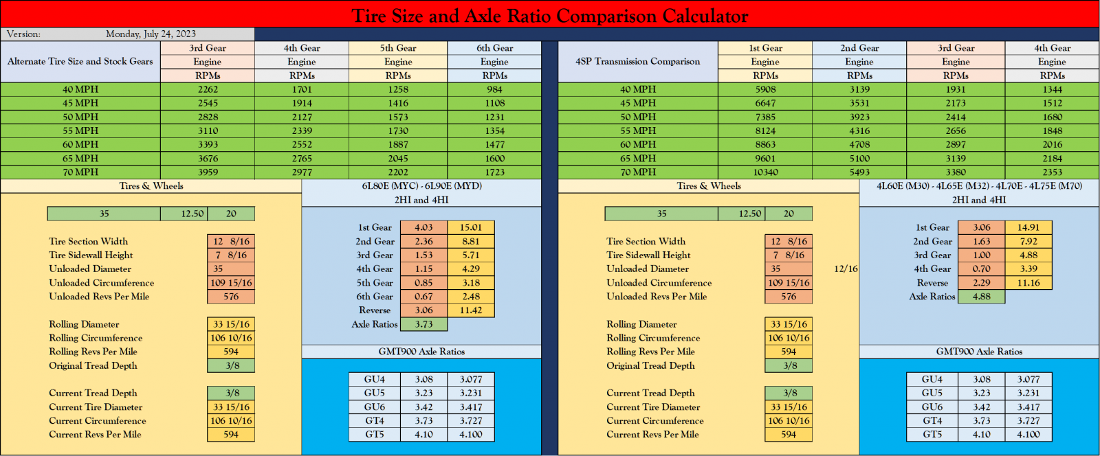

When your truck was stock, if it had 265-70-17 tires, the rpms at 70 mph with 3.73 gears were about 1,992 rpms.
Now, they should be about 1,799 rpms with the 35s. Your current RPMs are like having 3.42 gears with a stock tire, 1,826 rpms.
A 4.10 gear will deliver 1,979 rpms at 70 mph on 35s.
A 4.33 gear will deliver 2,090 rpms at 70 mph on 35s.
A 4.56 gear will deliver 2,199 rpms at 70 mph on 35s.
A 4.88 gear will deliver 2,353 rpms at 70 mph on 35s.
This assumes a 4L60 series transmission too.

35 inch tires changes (reduces) the mechancial leverage the vehicle's final drive has relative to engine rpm and corresponding vehicle speed. As a result, the engine isnt producing adequate rpm at any given speed compared to when the tires were stock diameter.
Over time, this deficiency stresses the transmission, particularly the 3-4 clutch pack as there is less line preasure rise generated inside the transmission to clamp/hold that clutch pack so it begins to slip before too long.
4.56 gears would restore the relationship established by the factory however in my humble opinion, 4.88 would be ideal.

Better acceleration at lower rpms (and corresponding better fuel economy) and, of course, better line pressure rise inside the transmission for applied elements, particularly the direct and overdrive clutch packs (for all transmissions). Lower RPMs are fine for HWY fuel economy considerations as long as you're not putting the trans at risk of having insufficient line rise due to insufficient mechanical leverage in the final drive...I've seen quite a few transmissions over the years out of lifted trucks where the owners had no idea why the trans started having issues/failing once they put the lift kit/big tires on the vehicles.

As long as the vehicle is in the 'green' with the selected gear ratio per those gear ratio charts, it will be fine but for 35s in a 5-6k lb vehicle, I'd go 4.56 at minimum.

I hear ya but there's a huge difference with 4.88s in a 4L60 and a 6L80.
In this example the stock NHT with 3.73 gears smokes the 4-speed truck with 4.88s ratio wise.
My 2012 came with 3.73 gears and has been running 35s for over ten years. About 2 years ago we had to do a reman transmission at about 130K. Right now the tires make the final drive ratios equivalent to 3.42s which we have in our other 6-speed trucks. 4.10s would bring the 2012 back to 3.73 rpms. Would you still counsel steeper gears?

If that's the case, then use the ratio that best corresponds w/the vehicle's intent use and performance requirements. Sorry, was thinking of TH350/700R4 ratios not the 6L80E with its much deeper deeper 1st gear. The overarching point is that the final drives must be updated considered based on application, use case and transmission gearing when you put significantly bigger tires on the vehicle.

I was thinking 4-speed 4L60E as this thread is in the 2000-2006 section and it's not specified that the trans is a 6L80E, sorry for any confusion. In real life ill obviously already know what trans is in the vehicle...Should have asked first...

@swathdiver - For this particular case, my original guidance stands with the caveat that 4.11 gears would work as well given the 4L60Es deeper first gear ratio (3:08 to 1) to get it off the line compared to the TH350's / TH400's gear ratios of 2.50 to 1 and that 4.88 may be a bit overkill for regular street/highway driving.
The 6L80, as you pointed out, can accommodate 3.73s w/35s (33" rolling dia) owing to it's much deeper 1st gear ratio to get it moving; .67-1 ratio in sixth w/3.73 gears and 35"s still somewhat stress the 2-6 and 4-5-6 clutch but not dangerously where as 4.10/4.11 would be ideal for 6L80E equipped vehicles where as something like 4.30-4.56 would be a good combo to pair w/a 4L60E equipped vehicle if low RPM acceleration/power was more of a priority (like something intended for a lot of off-road/trail use). I did not consider the OPs truck had a 6L80 when initially responding and as mentioned, should have asked first.
So the takeaway is to consider the transmission and it's ratios relative to engine, final drive and intended application when deciding on gear sets. All things equal, as long as the actual final drive is in the green (appropriate range) of gear ratios, everything should be fine.
Hopefully this clears up any confusion and closes the loop.
