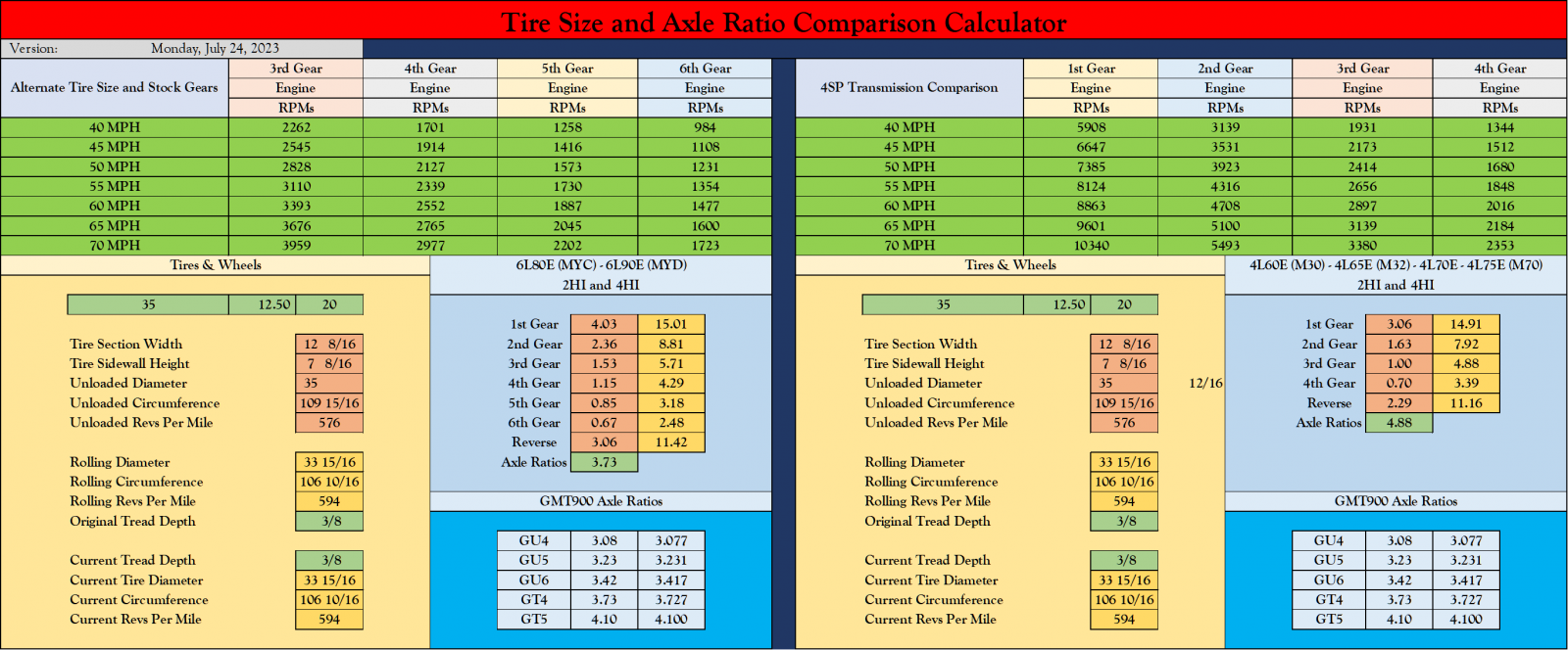

So the build is coming along nicely. Lots of hard honest work and lessons learned along the way. Exactly what I’d hoped for when I took this 4x4 project on. Thanks to this forum and other resources, I’ve had allot of support along the way. That said, I’m to the crossroads of re-gearing the rear differential. Currently running 35x12.5x20 wheels on a 6” lift. I’ve read all kinds of threads and heard the arguments from all sides and points of view. Kind of goes back to the main question, what is the purpose of the vehicle and what am I doing with it? Mostly will just be a fun rig for my son and I drive drive around town, run up to the lake etc. I may pull a small trailer or boat now and again. We live in the hills of Northern California, so not flat land by any means.
So the question is, what gears? Right now running stock G80 3.73’s. And honestly, it doesn’t lag all that bad. Not as much as I thought it would. Now I’m leaning towards 4:56 gears because I’d like to drive it down to work now and again, freeway miles about 50 each way. Maybe an occasional hunt trip down in the valley. I’ve heard some say go 4:88 while others say that is overkill.
Welcoming your thoughts and much appreciated!!

@swathdiver - For this particular case, my original guidance stands with the caveat that 4.11 gears would work as well given the 4L60Es deeper first gear ratio (3:08 to 1) to get it off the line compared to the TH350's / TH400's gear ratios of 2.50 to 1 and that 4.88 may be a bit overkill for regular street/highway driving.
The 6L80, as you pointed out, can accommodate 3.73s w/35s (33" rolling dia) owing to it's much deeper 1st gear ratio to get it moving; .67-1 ratio in sixth w/3.73 gears and 35"s still somewhat stress the 2-6 and 4-5-6 clutch but not dangerously where as 4.10/4.11 would be ideal for 6L80E equipped vehicles where as something like 4.30-4.56 would be a good combo to pair w/a 4L60E equipped vehicle if low RPM acceleration/power was more of a priority (like something intended for a lot of off-road/trail use). I did not consider the OPs truck had a 6L80 when initially responding and as mentioned, should have asked first.
So the takeaway is to consider the transmission and it's ratios relative to engine, final drive and intended application when deciding on gear sets. All things equal, as long as the actual final drive is in the green (appropriate range) of gear ratios, everything should be fine.
Hopefully this clears up any confusion and closes the loop.

Awesome Nick. I did not mean to imply that you didn't know which transmission we were working with. I wanted to know if... I'm sure this could be stated more clearly... that it is really the final drive ratios that matters based on different transmission ratios, gears and engine power when selecting the axle ratio. And you have answered that as yes, with several examples.
I agree, 4.10s in the NHT truck would be better for the transmission.
All good stuff.
