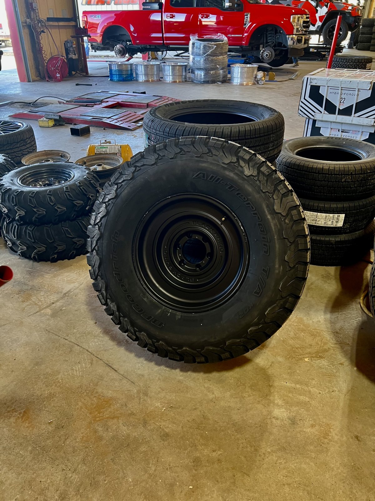

Here’s a pic of the wheel tire combo:
17x9.5 Black Rhino Solid (-12 offset)
37x12.5x17 (weighs in a 64 lb!)
I’ll post pics of the trimming and installed wheels when I throw them on. But good god, it looked so GOOD on the test fit.
FYI: 97% highway for me. I don’t get on trails at all and can’t comment if the 37” would be an option for those guys really testing the suspension travel.

37s ?!?!
Holy ****!
That's certainly stuffing a lot of rubber under the rig. It will look mean, especially on the 17" wheels, that's for sure :cool:
Where are you thinking more trimming will be needed? Both rear wheel well and front bumper(ish)?
Yes - the wheels are heavy. 37" tire on a 17" wheel is A LOT of rubber, and if you have any extra ply from an ordinary passenger spec, then the weight increases drastically.

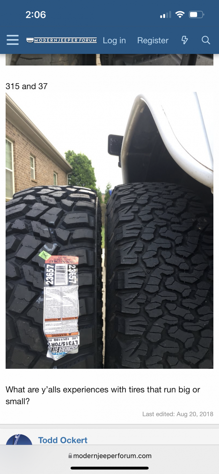

OKP- My calculations have the BFG mounted at 30psi coming in at around 35.2”. Of course the BFG site claims 36.5”, but that’s wayyyy off.
Here’s a pic of a new Cooper ST Pro 35x12.5x17 next to a 37x12.5x17 BFg K02.

The non rounded sidewall of the BFG actually helps you out a little bit in fitting more tire in the fender, if that makes sense too.

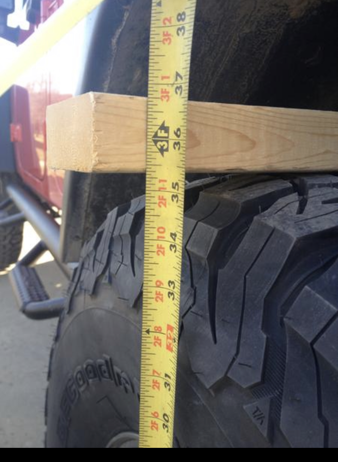

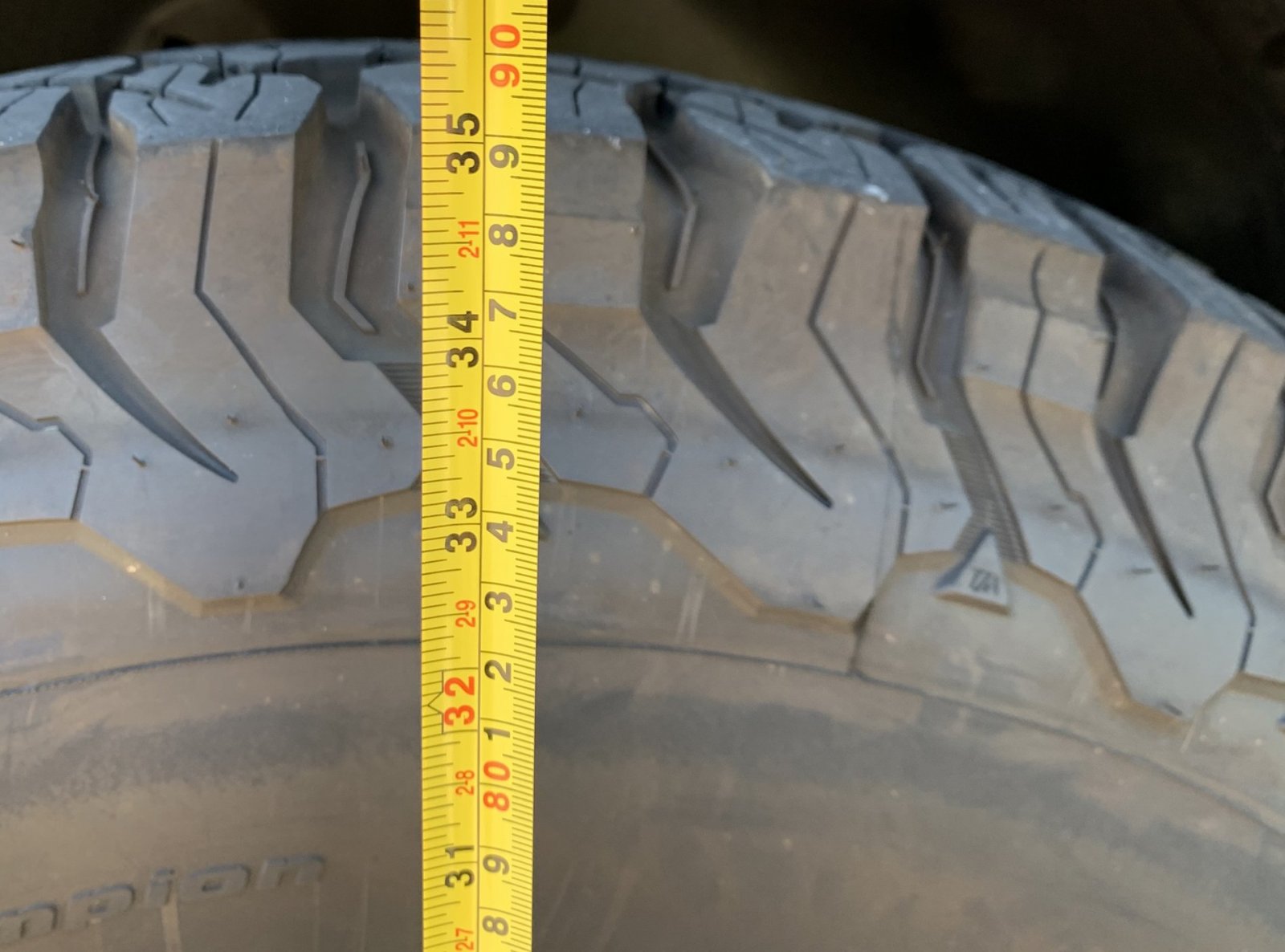

Not on my vehicle; but off a jeep with 17” x 8.5” wheel with the 37”. My measurements were just like this when we test fitted.

I see exactly what you're saying with the BFGs and "rounded sidewall."
I'm not doubting the 37" riding at 35.5" once the vehicle's weight is on them.
Also, I do think that the recommended wheel mounting width has some effect on overall tire height under vehicle weight, though probably very minimal in reality.
I'm pretty sure that I've read a wider wheel will create less overall tire height and a narrower wheel will cause more tire height, when compared to manufacturers recommended wheel width for each tire.
Ie: Recommend 9.0" x 20 wheel for a 32.5" tire, but install that tire on a 8.5" x 20, and you may realize increased height. Or maybe for argument sake on our discussion here, a 0.5" narrower wheel width than recommended as per manufacturers specs MAY get you closer to the actual spec'd diameter.

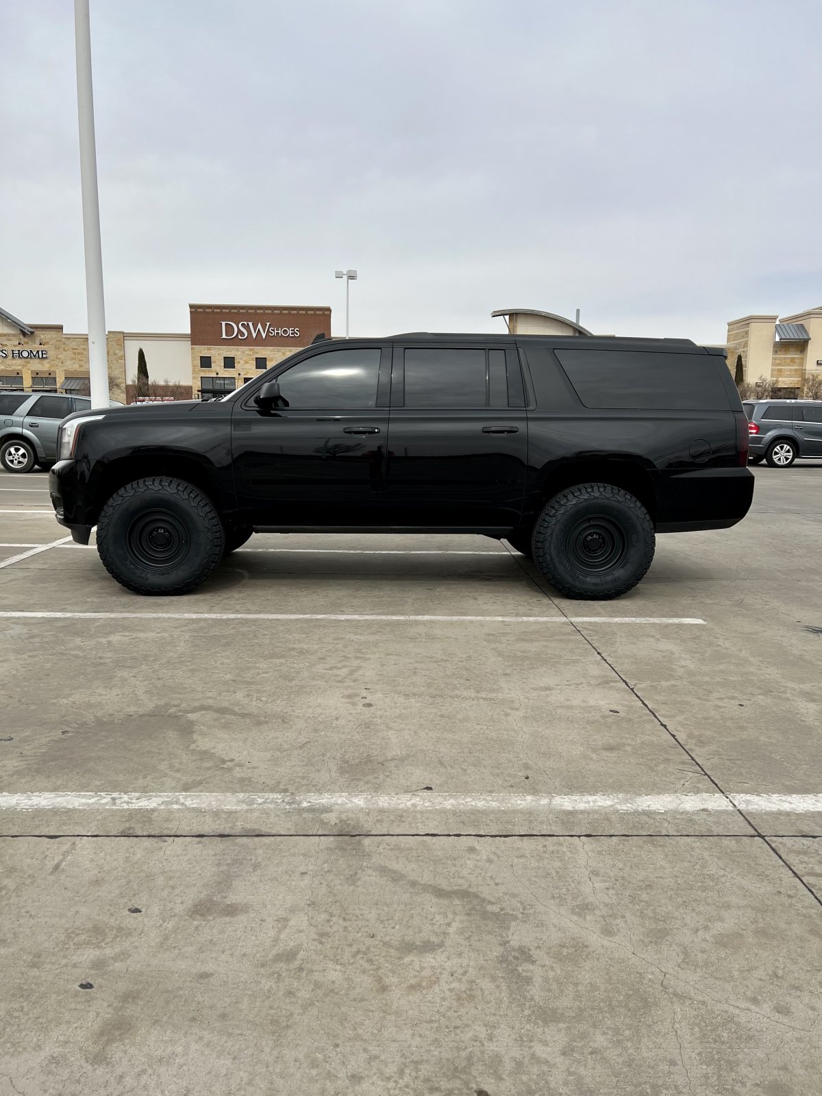

By far the best driving truck I’ve ever had. Reminds me of the ride of my grandmas 95 Lincoln Towncar back in the day. No joke, it’s super soft. My first set of BFG’s and I’m kind of surprised. They’re quieter and smoother than I imagined.

Looks GREAT! Well done.
I bet it rides very nice. I noticed a really big difference with mine when moving from 6" to 8" sidewalls...you've easily got that beat!
Would love to see some close-up photos of the front wheels, with a focus on the front & rear fender and your tire clearances. Second @olyelr with trimming ?s
Also, have you lost power with the change? I feel like you have the 6.2L. Exact engine? Any tune being used?
Regarding your Power: Off the line? | 1->2->3? | Highway cruising? |
Maybe after a bit of time you could update us with approx. MPGs on the 37s.
More pics please :waytogo:
