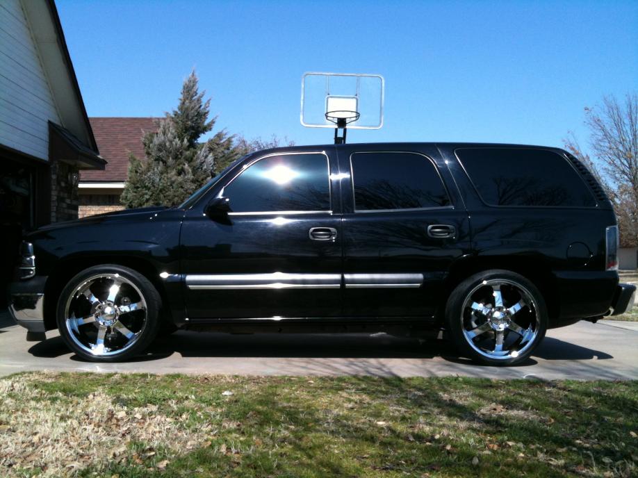

only good one i really got of it

looks good... give it a little time of driving around on .. the springs may settle....
