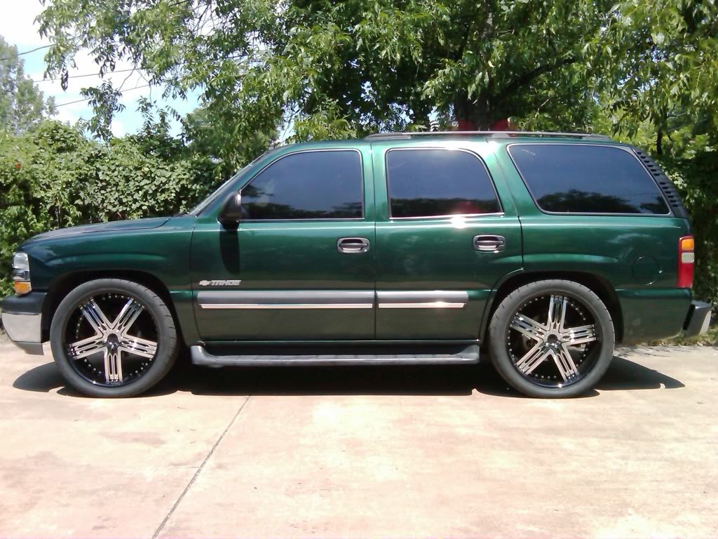

Alright well here is the final product:
I have something that sounds like it''s loose somewhere. I checked all of my bolts to make sure they were tight and they were, so I don't know where it's coming from?? :confused::confused::confused:
DAMN....that's sexy! I can't say I have ever seen it. How much was the kit, and did you get the wheel/tire here, or did you go to Traders Village? Looks great!
Thanks!! I appreciate it! I bought the kit used so it was less than new. I bought the wheels through Discount Tire. They were the only place around that I found that could get the rims that I wanted.
