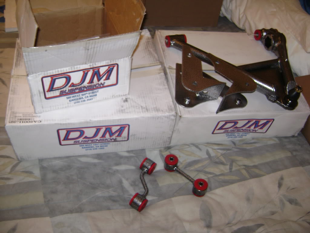

Got the Kit in today. I'm so excited! Ill be putting it in on Saturday.
If I don't forget my camera on saturday ill have pics of the install.

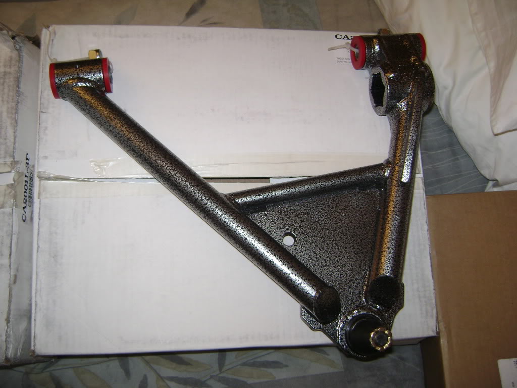

whats the difdf between arms and keys. i want like a 2.5/4
NORCAL SS
SUV SUSPENSION GURU
Jun 9, 2009
8,744
610
keys will ride very bad at 2.5 inches and camber also.
Do the a arms and you can crank them up and will align. also ride is much better

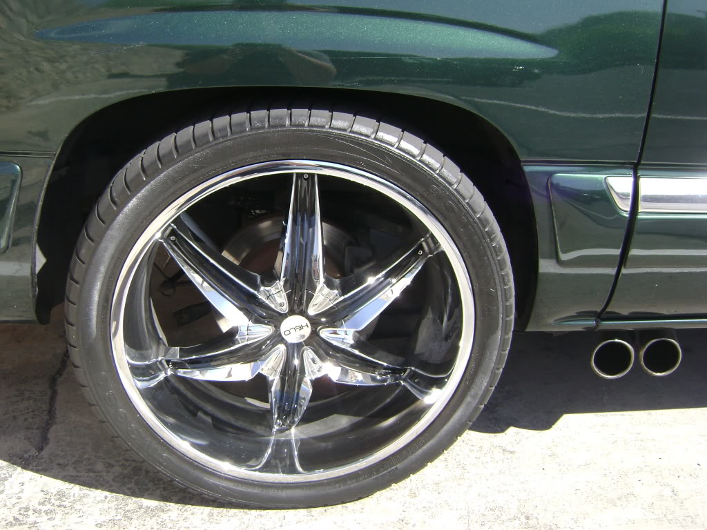

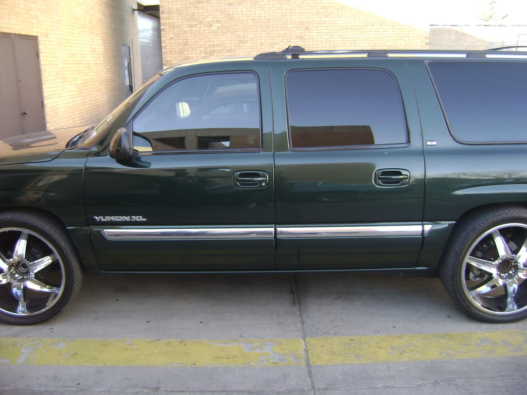

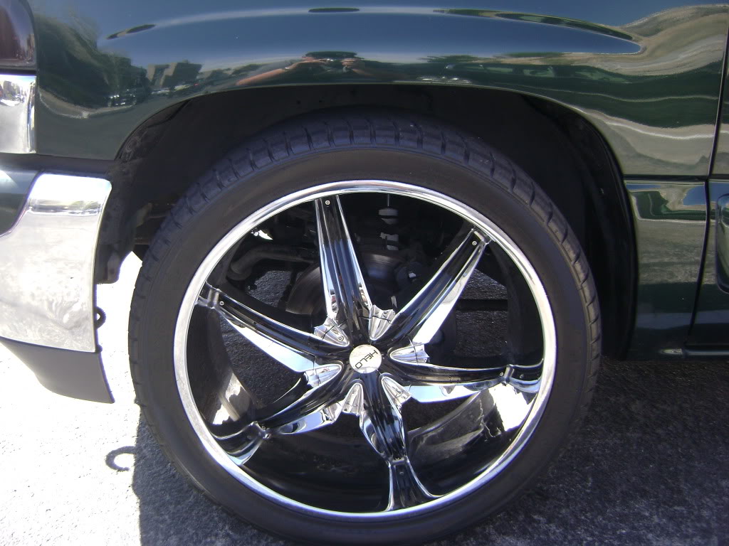

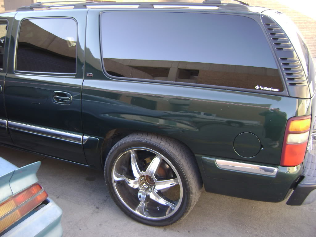

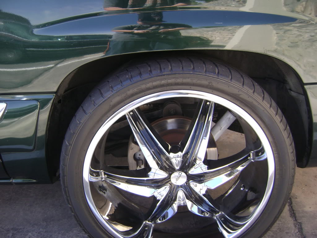

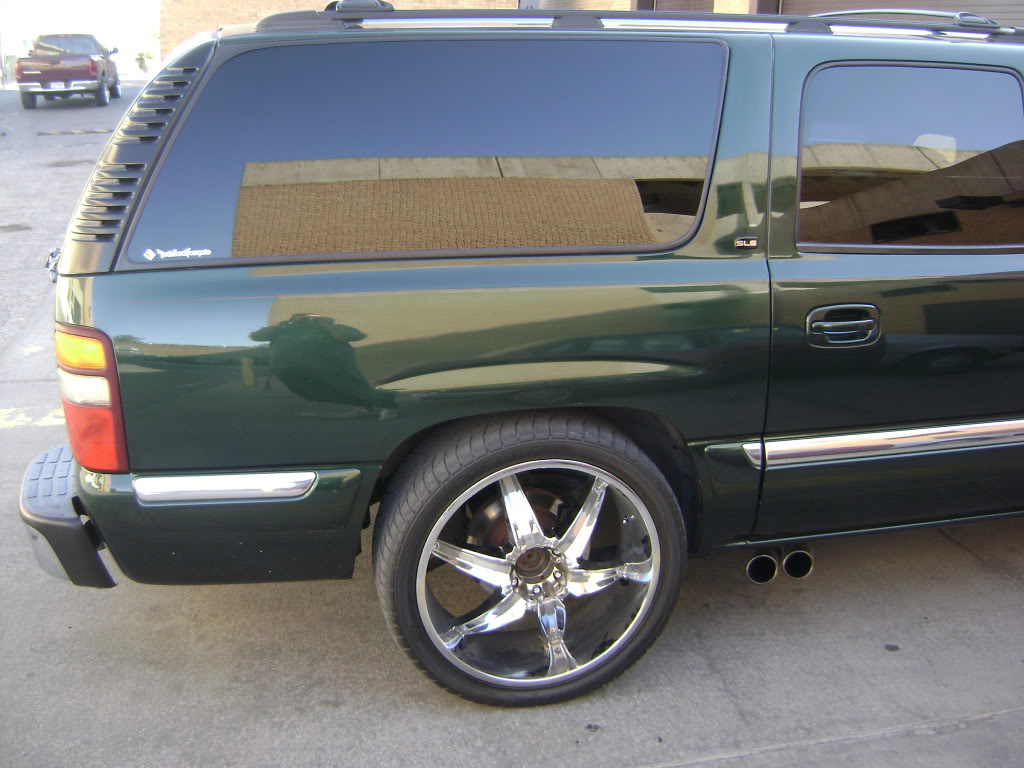

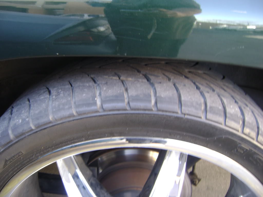

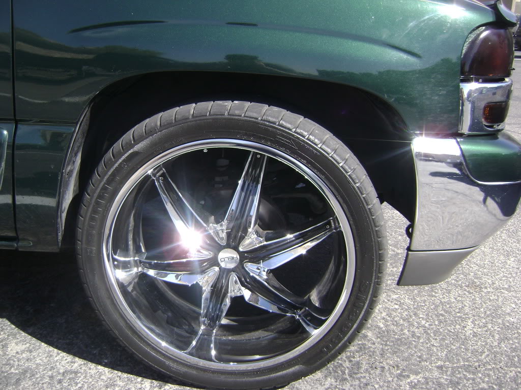

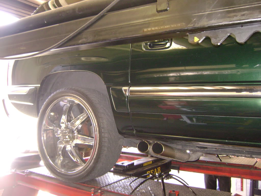

Put most of it in today in my suspension class. The only things left is the shocks and end links in the rear. But heres some pics.
Only Before pic i have that shows front and back
Before Front
Before Back
After Back
The Other Side
Close Up Back Right
Close Up Back Left
After the front settled down
Ill get some more pics of the front after the alignment and also some pics of the components installed.

Really the only problem we had was getting the a arm out of the spindle. Other than that was the time restraint we had.

Did you take ground to fenderlip measurements before/after the drop.
if not if you can pm me the tire size/ground to fenderlip measurements I like to keep a chart going of all the trucks I do plus kits I sell to give me more info when people have different tire sizes/trucks to give me and them m ore info
---------- Post added at 11:02 AM ---------- Previous post was at 10:59 AM ----------
can you take before/after measurements of
ground to fenderlip height?
also your tire size.
I like to keep a chart here of the kits i sell plus install and tire sizes to give myself and others more feedback when choosing a kit.

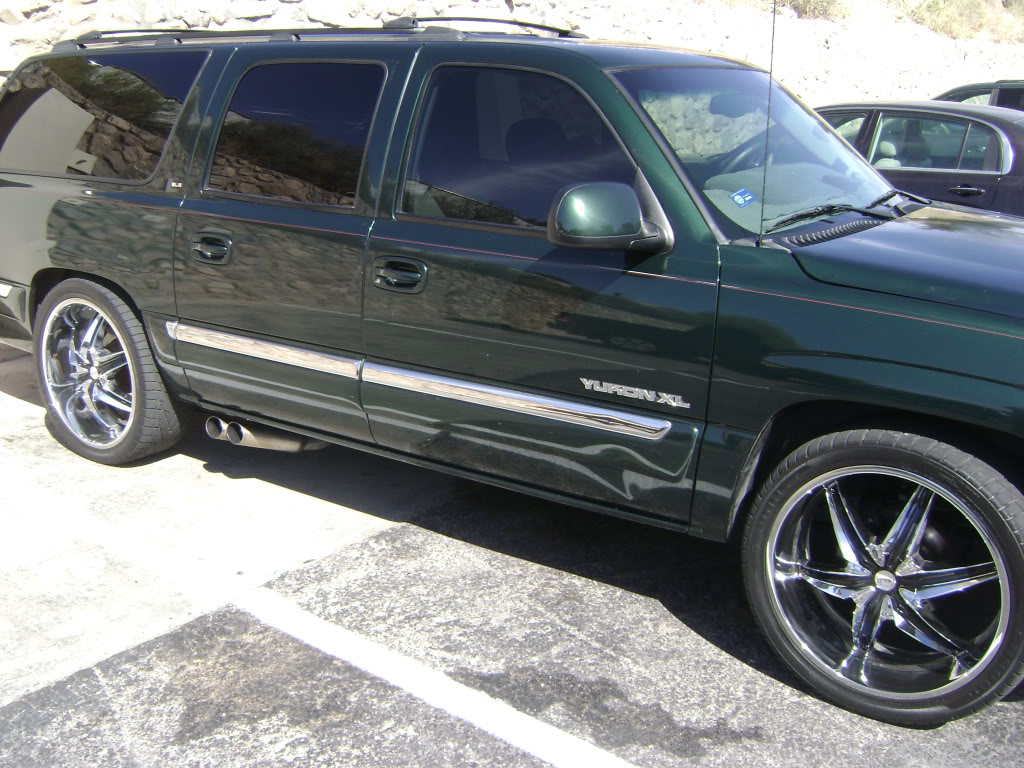

Tony the after measurents are 34.5" up front and 33.5" in the back. It rides amazing!!
---------- Post added at 12:08 PM ---------- Previous post was at 12:03 PM ----------
As it sits today.
Driver Front
Passenger Front
Driver Back
Passenger Back

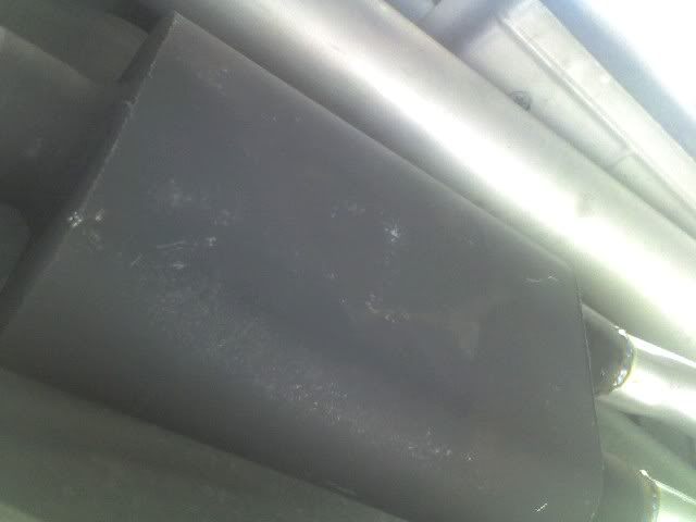

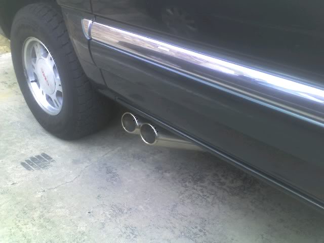

id be affraid to scrape all the time.. you have any issues with that?
Big Buttons
Big Buttons
The SS Burb
Nov 10, 2010
3,479
36
South Texas

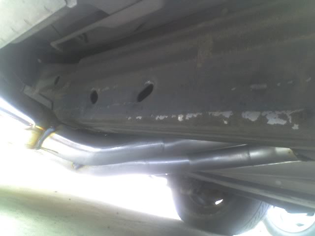

Scraping what? Tire or exhaust? tire no prob and exhaust no probs either. only thing i scrape is my hitch on a steep hill other than that no issues with anything.
ghost
Senior Member
Aug 9, 2010
378
Yea I was talkin bout the exhaust, It looks good!

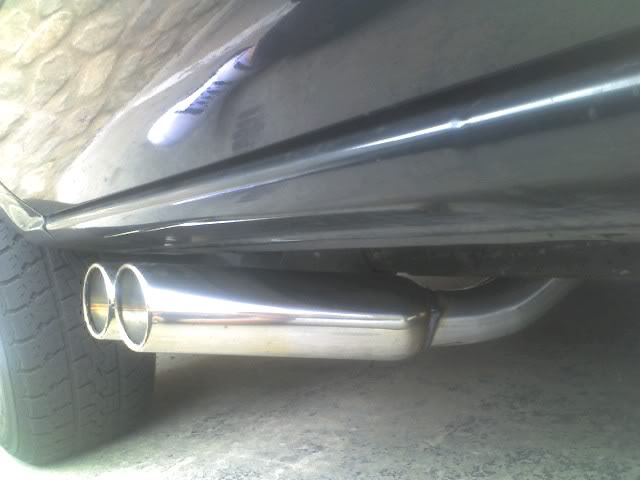

$180 is a super good price! All my local shops are expensive. It was like $200 just to replace my stock muffler with a super 40. I want your setup except out the back stock location with black tips!
