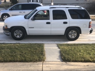

I got a 3/4 drop from crown
how much do you think i can adjust the front keys
i installed the rear springs and sitting at 33 rear front oem keys at 34.5
3" might be a little too much im sure can crank them up but not sure how much
got to rent the tool to do the keys just wondering

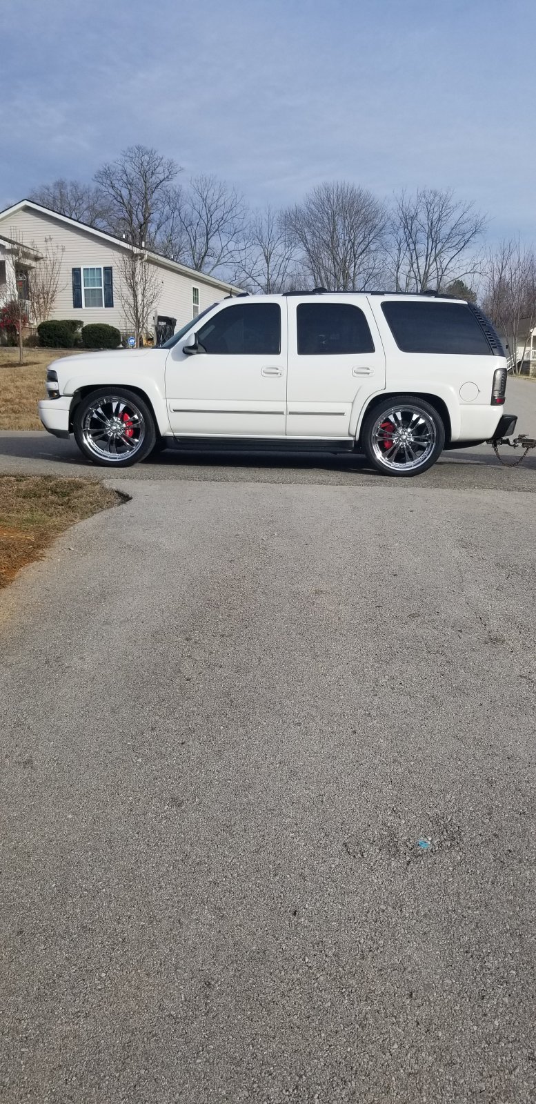

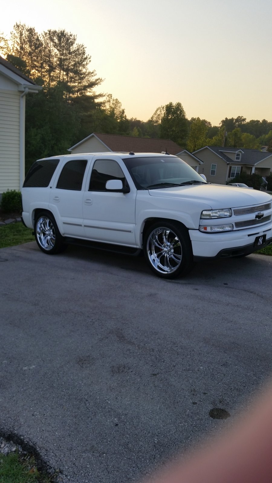

I got the crown 3/4 kit a year or 2 ago. Still have the coils In the rear with the djm rear kit and spohn panhard. anyway I ended up buying mcgaughys spindles and re did every suspension part on my front end. But when I just had the keys in i had the adjuster bolt bottomed out Screwed in as far it would go and my front end was pretty low. It wouldn't align perfectly but not enough to chew my 24 inch tires up But was not a bad kit for the money. I'm thinking of getting the trailblazer coils an see how they do.
the last pic is it with the keys. The other 2 are spindles. not really a difference in height just the ride quality 20180708_212332.jpg 20180514_190527.jpg
