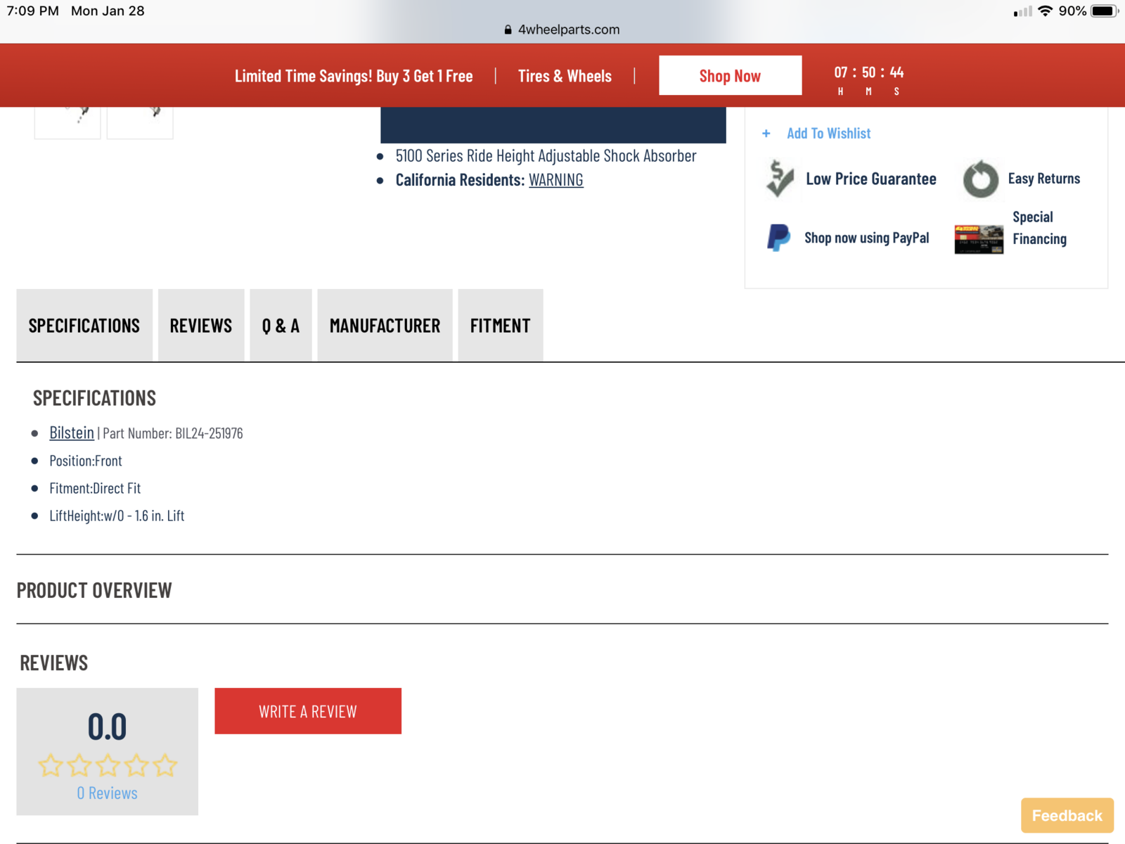

So basically this bilstein with a 1.5” spacer top mount? This was the bilstien listed for the 2017 Tahoe. 0 to 1.6” lift.
The bilstein 5100 front strut gives you up to 1.6" lift
The rear doesn't give you a lift , just an extra 1" of piston travel which will be good if you lift the rear.
I had trouble with the front bilsteins , it requires that you use the OEM spring seat , and mine was welded on and I couldn't remove it , which is why I recommended the rancho rs7000mt. The rancho also gives you 2" lift and it comes with the spring seat so you wont have the same issue I had .

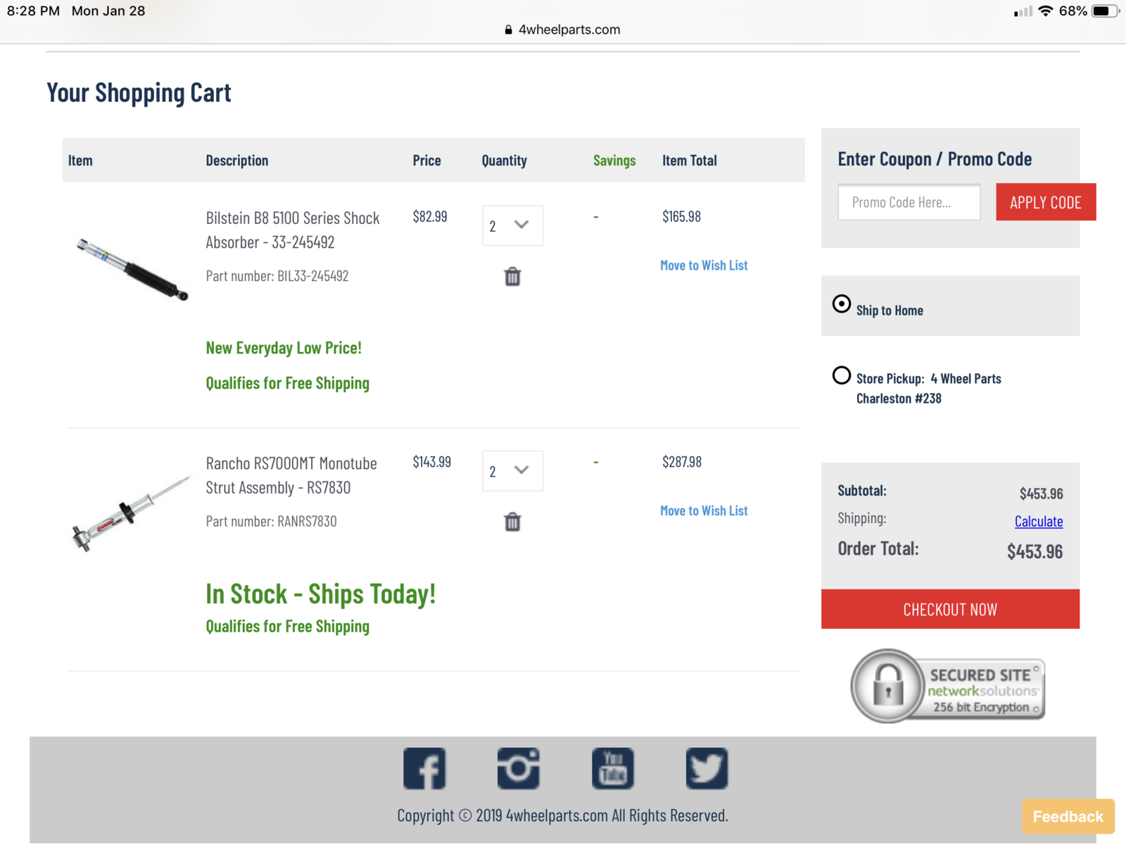

So these parts look right?
Yup , looks good . If you're going for the 3" lift then you should get the 1" front spacer and a 2" rear spacer .
A 1.5 rear spacer will have you perfectly level, but I'd personally go for the 2" which will give you an ever so slight half inch of rake which is the best thing , especially if you plan on driving with a little bit of load from time to time .

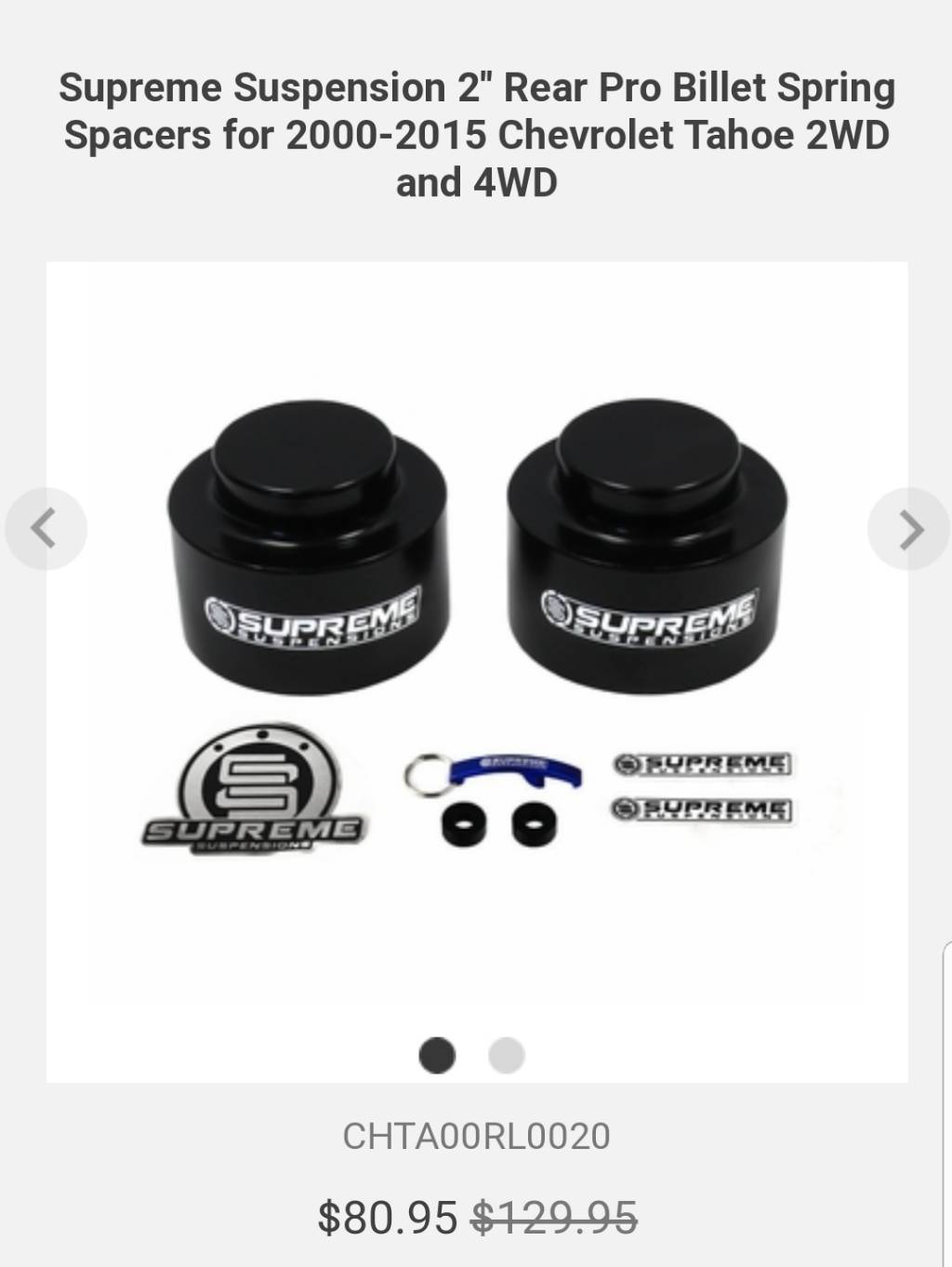

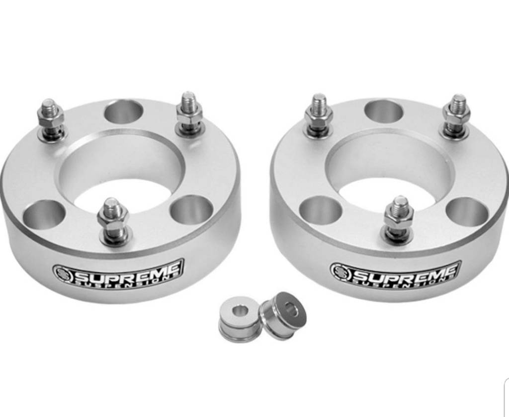

Supreme may only have 1.5" as the lowest in the front , if not then check suspension maxx , doesn't matter which brand as long as its metal/aluminum, but this is what it looks like . Even walmart has it on their site .
