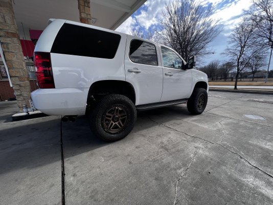

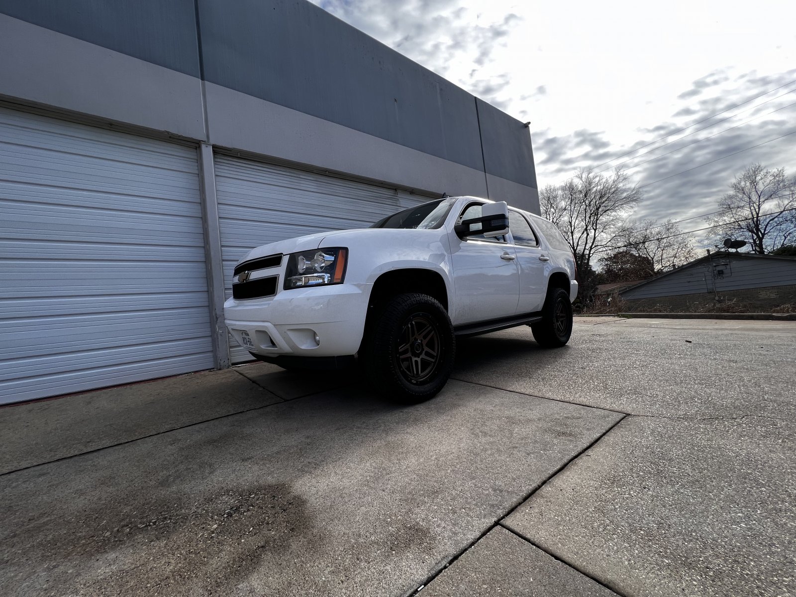

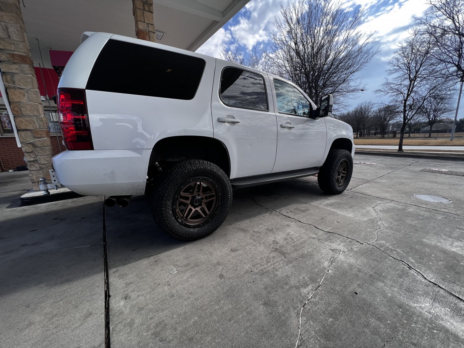

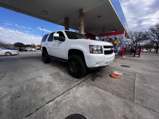

Got the Hoe mostly set up the way I want . Minus the Fox 2.5 coil overs !
Maxtrax lift spindles
Fox 2.0 IFP adjustable struts set on 2 inch
Readylift 4inch upper arms
Readylift 4 inch rear kit
Tahoe Z71 rear springs 1.5 taller
4wp bronze T series 20x9
Procomp 35x12.50x20 AT Sports

@1lowhoe04 Looks great! One suggestion I have is it seems your rear wheels are sticking out the passenger side of the Tahoe and tucked in a bit on the driver side. Look into getting an adjustable track bar to get that rear axle re-centered.
