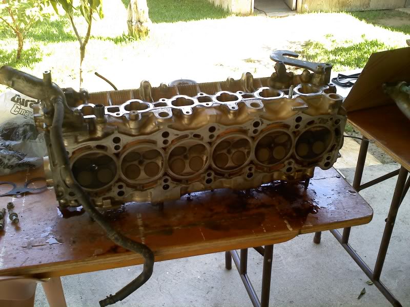

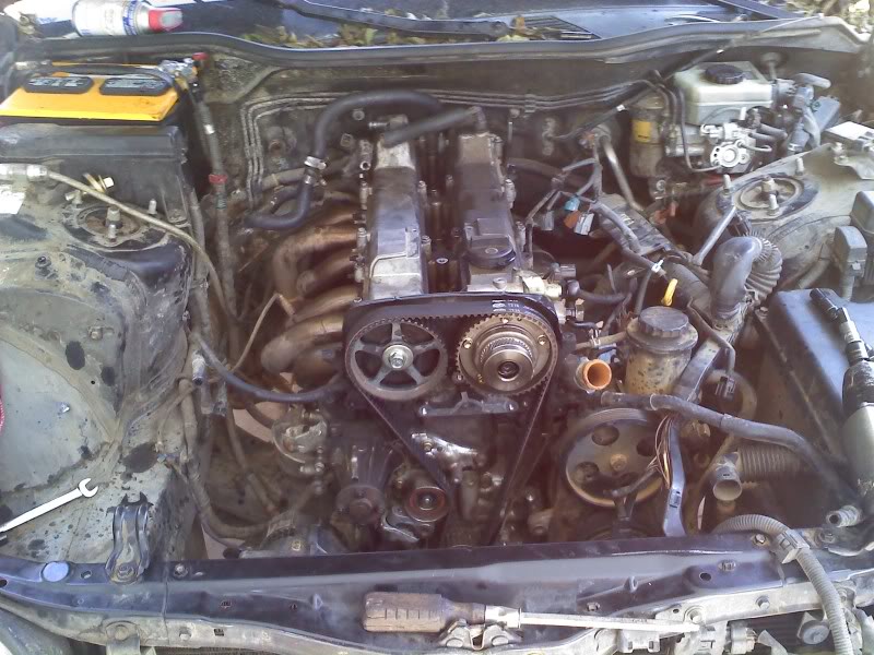

Evening everyone, since i dont work much, where i work they are going down the drain, i do mechanic work at home, so today i got to work on one of the best motors Toyota has built. here are some pics enjoy.

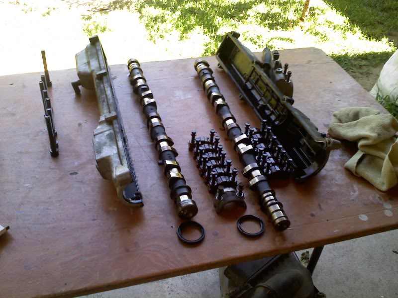

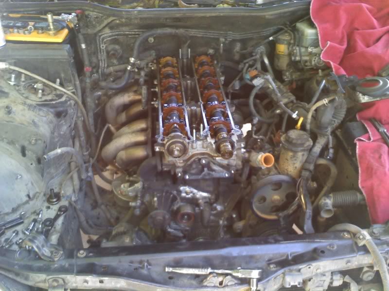

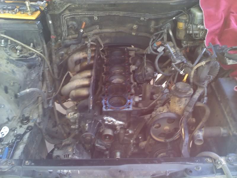

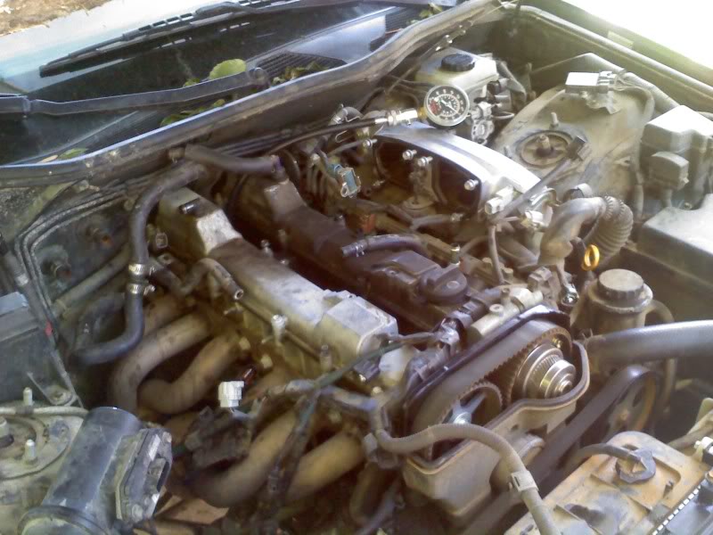

the head gasket went out on piston 4, it had 60 psi, so i tor into it and replaced the head gasket, timing belt, and serpentine belt, plugs, and gave everything a good cleaning.Yukon did the parts running, lol
all finished:
