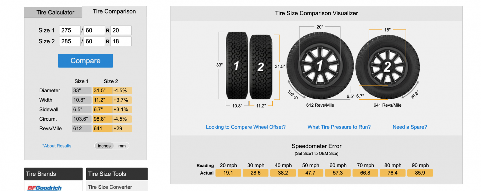

I run 275/60R20 tires on my Yukon and they fit fine, with no rubbing. They are equivalent to 33" tires. You should have no issue fitting 285/60R18 tires (31.5") in your Yukon. Looks like you could run 285/65/R18 size tires and still be good to hook.
