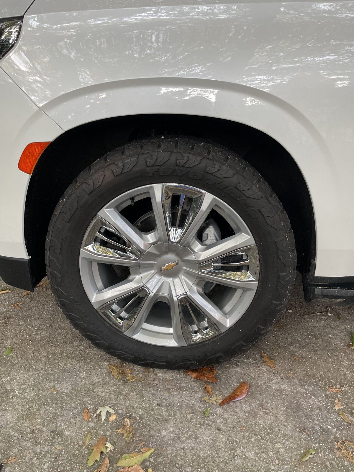

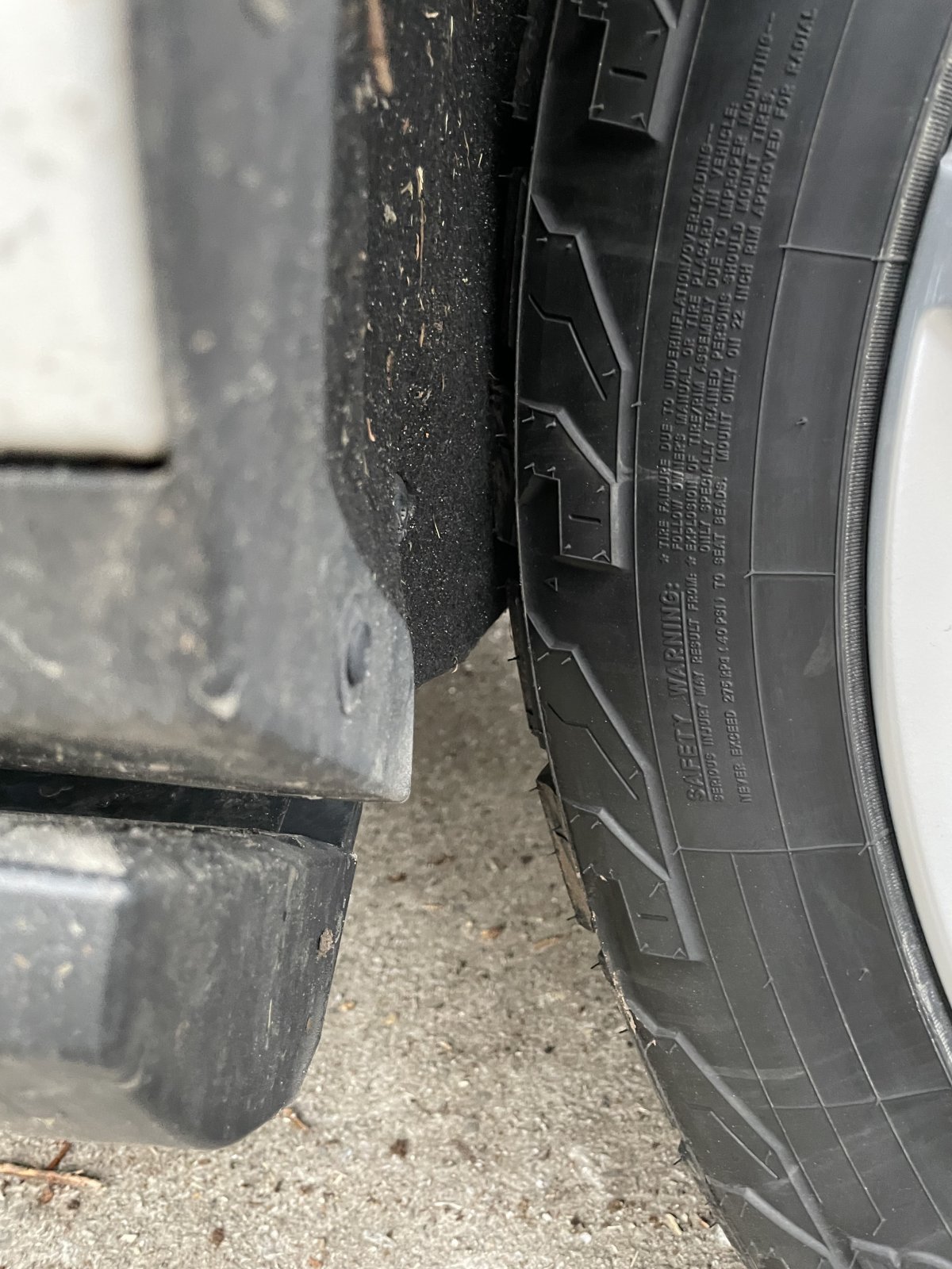

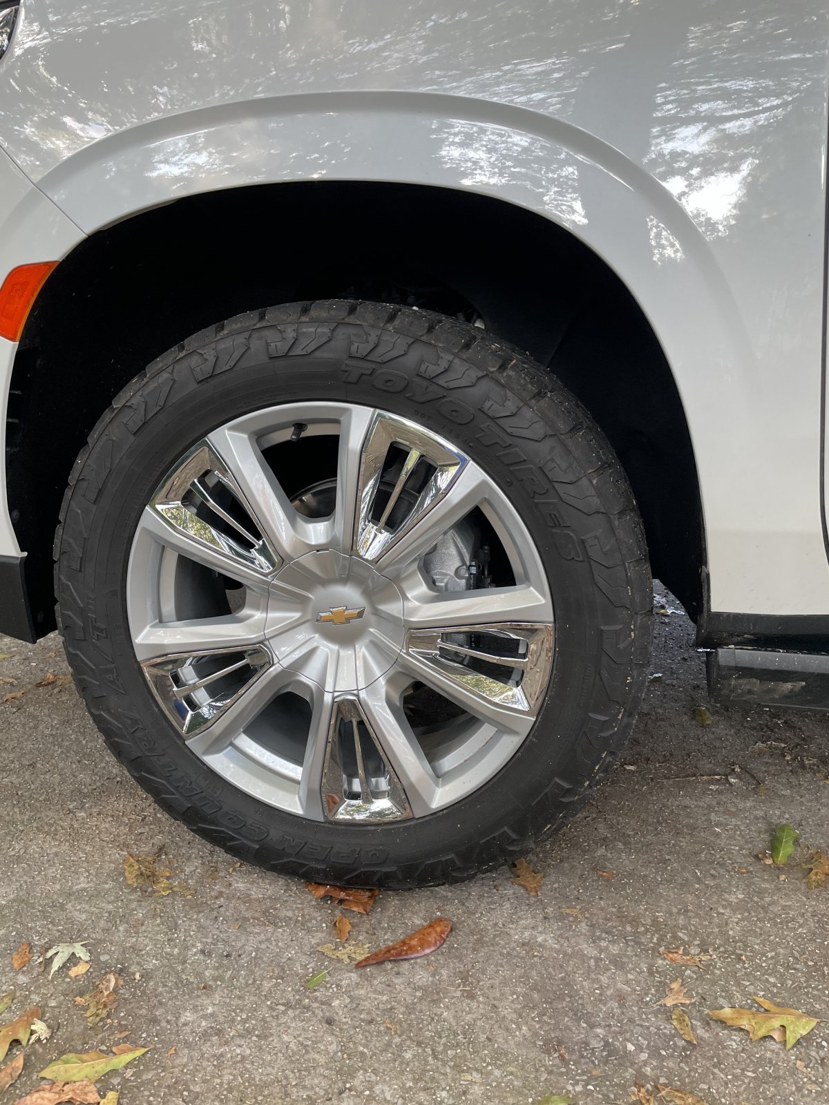

285/50r22 is the largest tire you can run without suspension modifications or fender liner trimming. When you turn the wheel hard left or right the most limiting dimension is the front wheel wells, specifically the rear portion.

Is that stock ride height in your pics?
the closeup pictures in my first post are at entry/exit height (lowered 2 inches) to simulate when the suspension is compressed. The picture of the entire front wheel is at normal ride height. Tires are 285/50r22 Toyo AT3 on factory High Country wheels.
Normal Ride Height
Entry/Exit Height

@d_hawk thanks for sharing these - looking at getting the same setup. So this tire size does or does not rub at entry/exit height at the tightest turning radius? Any other issues with the tires? They look incredible.

No rubbing issues in entry exit mode in over 30k miles of use. The only issues are fuel mileage hit and price of the tires, not really the tires fault for either though. When this set is done I will most likely buy the same size and model tire again. Toyo became my preferred tire over BFG about 10 years ago.
